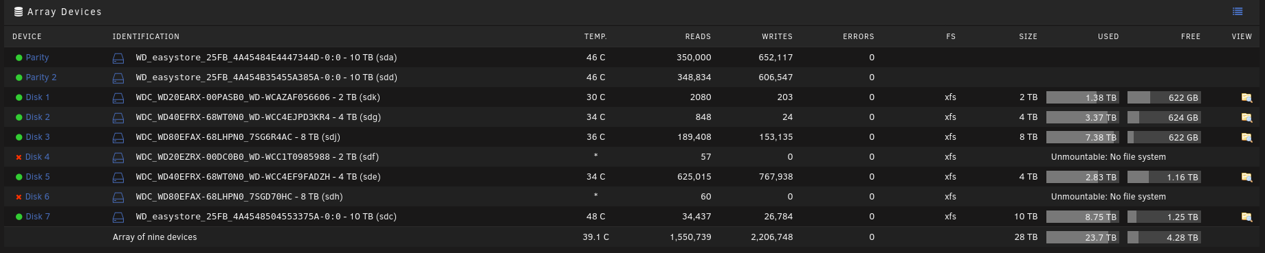

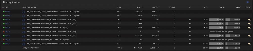

Two drives failed, I have two parity disks, yet the contents are not emulated
Recently I had two drives get marked as disabled, but luckily I have two parity drives. Unraid says that both of these drives are emulated, however I am seeing various missing files in my array. Why is this happening and how can I fix this? A parity check was done a week ago, and many of these files would be included in that. I've attached a screenshot of my drive setup in Unraid below.
Further, another problem is that these two drives seem to get marked as disabled every few weeks. No idea why, but I will run SMART long tests on them and they will come back as working. From here, it seems the only way to get them up and running again is to wipe the array and create a new one, and then these drives are marked as working. On this, I have two questions. Why are these drives getting marked as disabled in the first place? It seems to exclusively happen during parity checks. Secondly, is there a way of knowing that these drives are actually fine besides SMART tests, or is that the best option? The process of clearing the array and creating a new one works, but I'm very afraid that at some point it will not and wiping the array will clear my parity drives, and therefore I will lose all of my data on these drives.
The drives are emulated, but unfortunately the emulated drives are unmountable as shown in the screenshot.

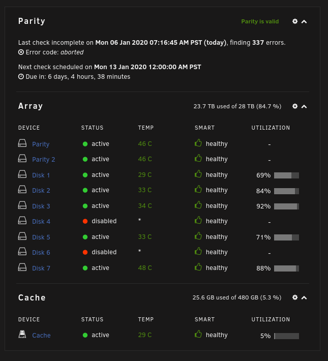

SMART for disabled disks looks OK. Do you have any SMART warnings on the Dashboard for any of your other disks?
Would it be a notification or something in the panel on the dashboard? Everything says active except for the drives in question. Here's a screenshot of it.
That looks good. The green "thumbs up" in the SMART column would be a yellow "thumbs down" if you had SMART warnings.

This is not very good:
It implies parity is not valid, even if that was a correcting check, since it didn't complete.
