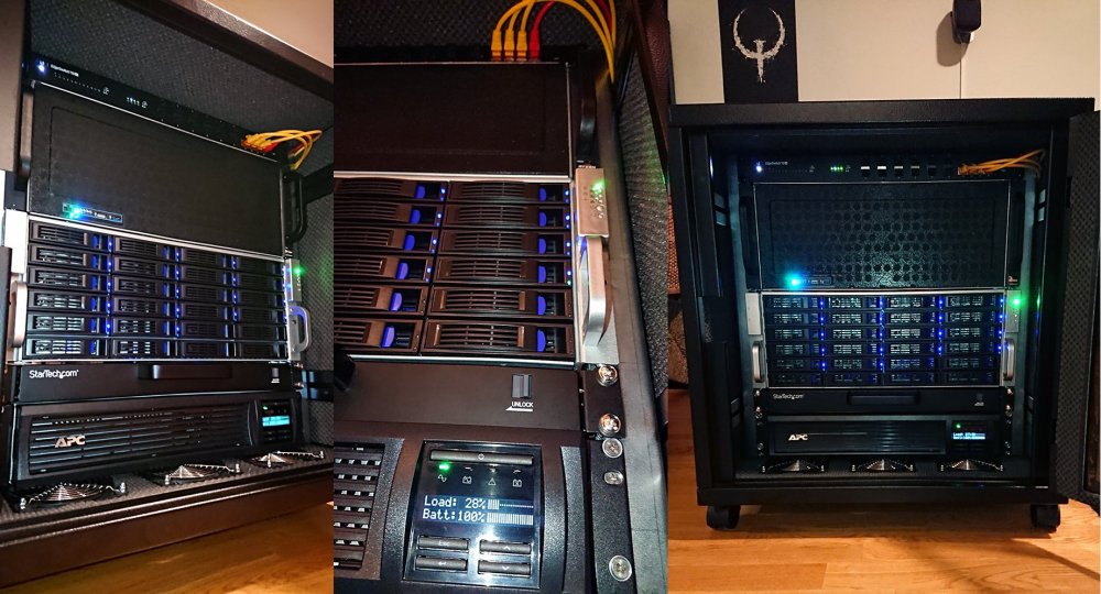

My unraid journey, i finally settled... Sound proofed rack was the way to go!
I started my unraid journey in october 2019 trying out some stuff before i decided to take the plunge and buy 2 licences (one for backups and one for my daily use).
I am working with IT and knowing how much noise rack equipment makes at work i had no plans what so ever to go that route. My first attempt at an unraid build was using a large nanoxia high tower case where i could at max get 23 3.5mm drives into, but once i reached around 15 drives the tempratures started to become a problem. Also what i didn't see was how incredible hot the HBA controllers become.
I decided to buy a 24bay 4u chassi to see what i could get away with just using the case and switching out the fan wall with noctua fans and such to reduce the noise levels. I got a 24bay case that supports regular ATX PSU because i know server chassis usually go for 2U psu's to have backups and they sound like jet engines so i wanted none of that.
Installing everything in the 24bay 4u chassi the noise levels were almost twice as high compared to the nanoxia high tower case even when i switched the fans out and used some nifty "low noise adapters".
Next up was the idea of having a 12U rack that is sound proofed, is it possible? How warm will stuff get? What can i find?
I ended up taking a chance and i bought a sound proofed 12u rack from a german company called "Lehmann", it wasn't cheap in any sense but it was definitely worth it! I couldn't possible be happier with my build.
From top to bottom:
10gps switch
AMD Threadripper WM host server
Intel Xeon Unraid server
Startech 19" rackmount kvm switch
APC UPS with Management Card
In total 12u of 12u used!
Temps: around 5c higher than room temprature, unraid disks average of 27c.
Noise level? around 23db, i can sleep in the same room as the rack!
Edited by je82

Damn, that's pretty. On wheels too! Is that the Rosewill case or Norco?
Neither, its 2 logic cases

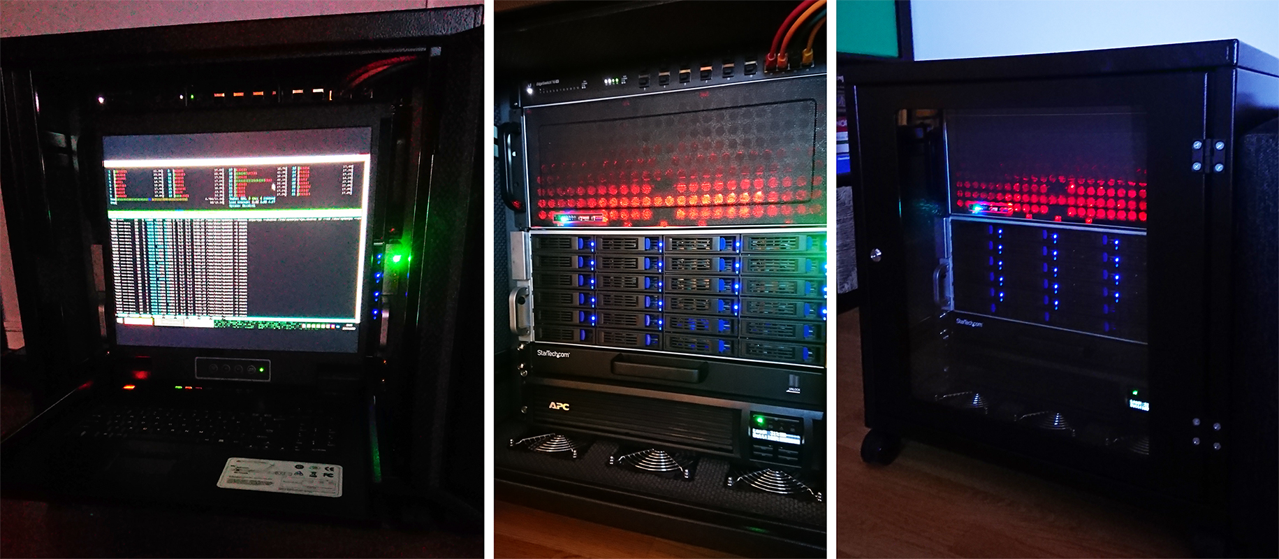

I added some leds to the threadripper case (red one), i really don't like leds but i think this one looks sorta neat, damn.... am i one of those people now?
