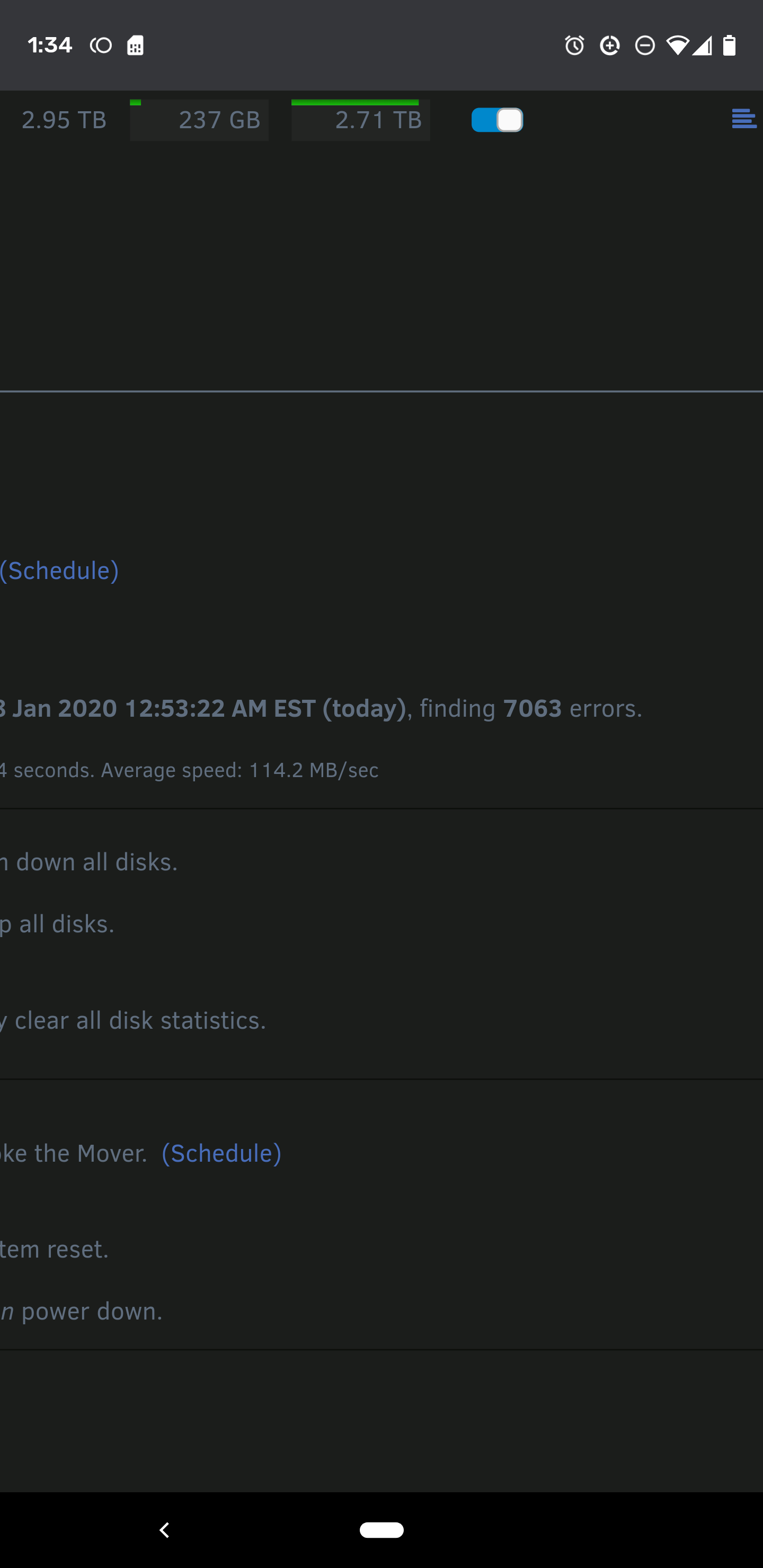

**RESOLVED** Parity check finding 7000 errors
Is this a sign of something bad?
Edited by Fiservedpi
Any unclean shutdown since last check? A few sync errors are expected after an unclean shutdown.
No, here's the smart report if I'm reading correctly all my hard drives are in prefail? All drives are less than 4 months old I did relocate the server 18 days ago
