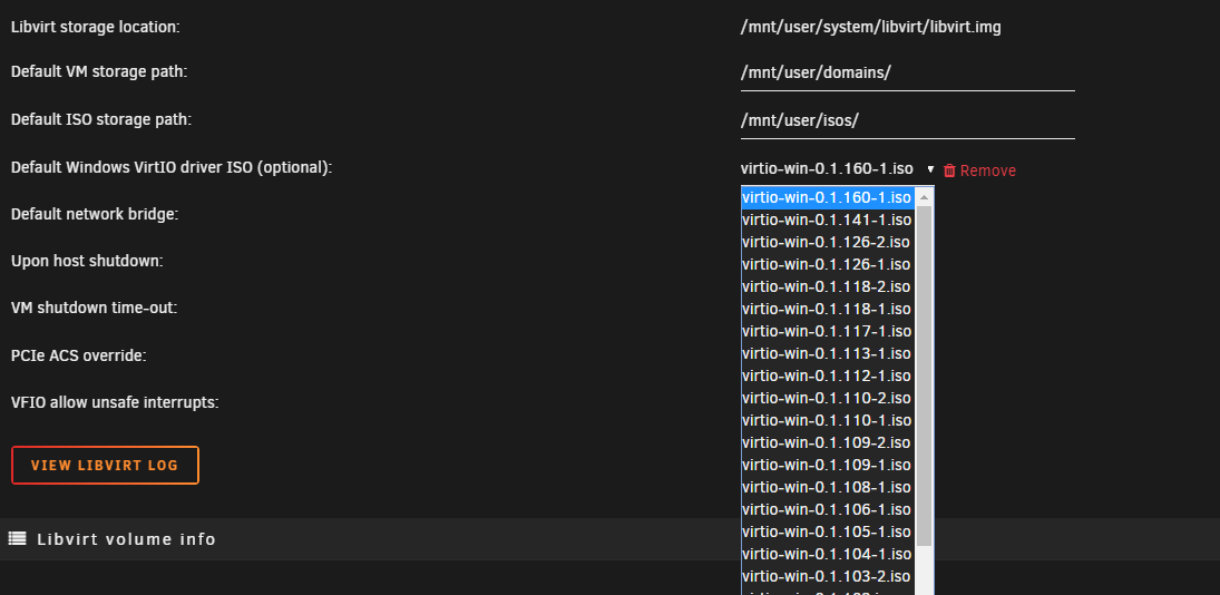

ok ok but the last is 160 for my part:
You are looking at the general settings, but you need to change the settings of the VM itself.
To be able to use version 0.1.173 you must have stored the image file in the "isos" folder, and then select it in the VM settings.
You're overcomplicating this.  Just download the ISO from your Windows VM.  Double-click the ISO and it will mount it as a drive letter.  Right-click on the VirtIO Ethernet controller in device manager, update drivers, then browse to the drive letter of the ISO and let it search.
