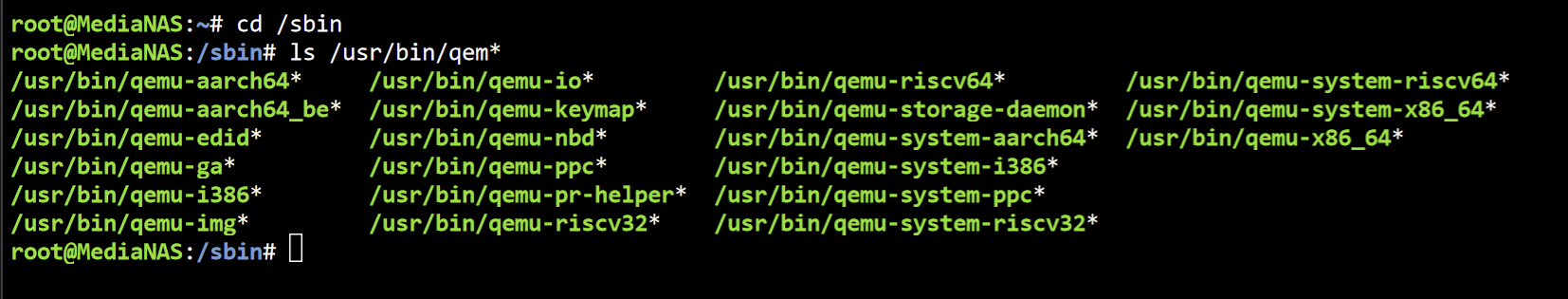

November 28, 20223 yr On 10/28/2022 at 9:16 PM, daschmc said: I'm running 6.11.3 and no such qemu files list on my machine.
November 28, 20223 yr On 10/28/2022 at 10:16 PM, daschmc said: 6.11.1 Linux 5.19.14-Unraid. root@Tower:~# /sbin# ls /usr/bin/qem* -bash: /sbin#: No such file or directory root@Tower:~# All good on 6.11.5 for me. Can't comment on earlier versions.
November 29, 20223 yr OK, following your commands in terminal I got the same result, the files exist. I was trying to navigate to usr/bin/qemu* with krusader docker before. Trying to build a template. What am I missing here?

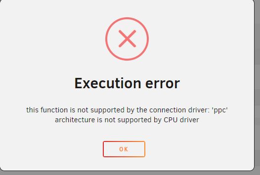

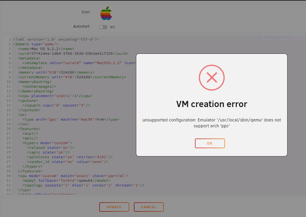

November 29, 20223 yr Community Expert 9 minutes ago, sasdakota said: And if I try just ppc, I get this. You need to change the emulator part in the XML to be the PPC binary. <on_crash>restart</on_crash> <devices> <emulator>/usr/local/sbin/qemu</emulator>
November 29, 20223 yr 4 minutes ago, SimonF said: You need to change the emulator part in the XML to be the PPC binary. <on_crash>restart</on_crash> <devices> <emulator>/usr/local/sbin/qemu</emulator> What do you suggest I change it to? If I try qemu-system-ppc it gives me no such file or directory error. Here is my failed ppc XML. It is a heavily modified winXP template. failed ppc.xml

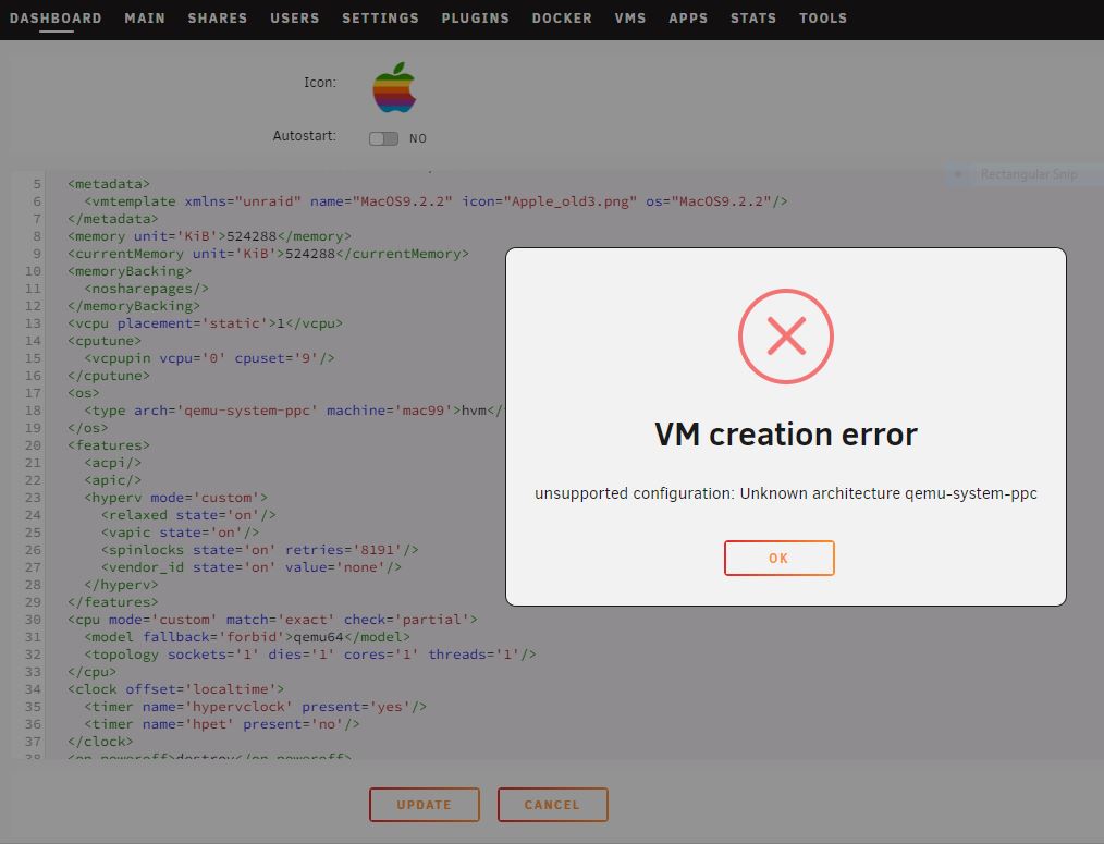

November 29, 20223 yr UPDATE: I got through the errors and was able to update the XML. However when I go to boot the machine this error comes up. Here is the current XML revision and error. Almost booted.xml
November 29, 20223 yr Another step taken, New XML (removed CPU driver). A new issue. master var store.xml
