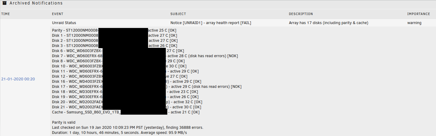

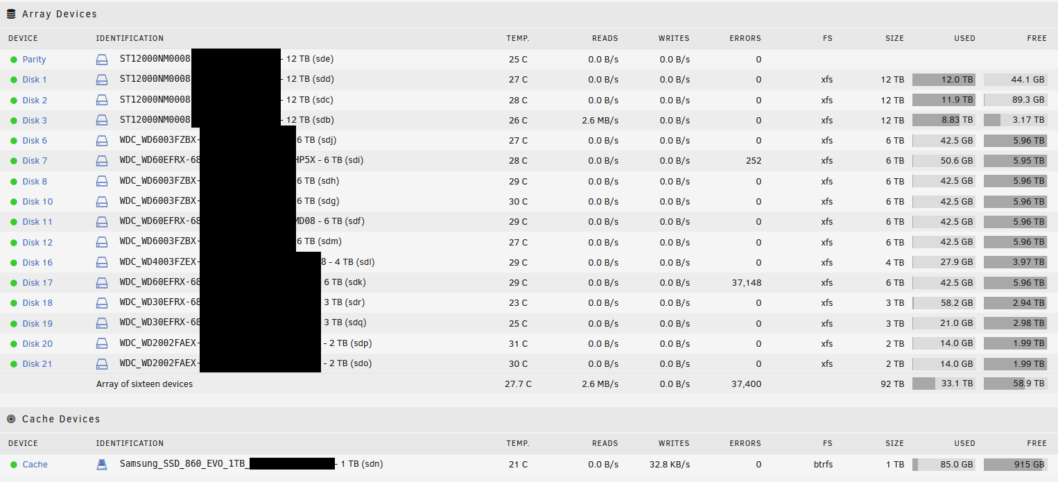

I am working through getting my first Unraid server off the ground.  So far things are going well, but I have two old WD Red drives that are apparently failing and out of warranty.  They have been running in a Windows box for years without issue, but are unable to complete the extended SMART tests and are showing read errors.  Both drives are currently empty and I was not planning to use them with any irreplaceable data.
What is the risk of keeping these disks in the array until they actually fail?  I am running single parity currently and have plenty of extra capacity at the moment, but it feels wrong just throwing away questionable disks.

You can do it but the only problem is that in a drive failure ALL other disks must be able to be read 100% to rebuild the data, so if you had a parity, these two bad disks and 2 good disks (where you stored important files) and one of the good disks died, then to rebuild you must rely on two known bad disks, and if that fails then even the important data is gone. I mean you can do it but know the risks. (In. other words in the event of a failure, your data is only as safe while it’s rebuilding as your least reliable disk).

Not simply a matter of drive failure during rebuild. Bad disks can also give bad data that makes the rebuild no good.

Actually you only lose the contents of the failed drives and not the whole array as with Unraid each drive is actually a discrete self-contained file system (one of its strengths in severe failure scenarios).   However the gist is correct in that with untrustworthy drives in the array you are at a significant risk of data loss.
