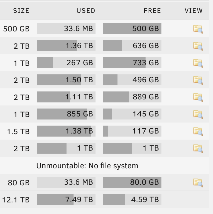

Looks like we have a winner. The drive I suspected was the old parity drive did indeed have an unreadable file system when I mounted them all as data drives (with nothing mounted as parity). I'll confirm that the important data is all there and accessible, then stop the array, assign the parity drive, and let it rebuild parity.
