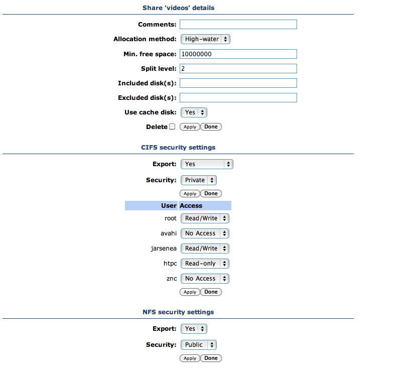

Can you take a screenshot of the area where you see "Export NFS" under share options?
I don't see this anywhere on my share options (even under the NFS heading) in 5.0-beta2... Curious?

Go to the settings page and enable NFS first
Here's what I did (remember, 5.0-beta2)
Under Settings -> NFS, I enabled NFS
Under Shares -> "Videos", I enabled NFS and set it to "Public"
I've attached what I see..
No where is there an "Export (NFS):" with a field that I can put a rule. The exception to this is if I put the security settings to "Private", I then get a "Rule:" field. However, putting anything in there, ie: *(rw) or *(rw,insecure) don't allow me to mount the NFS share.
Under 4.5.6 this was working perfectly.
