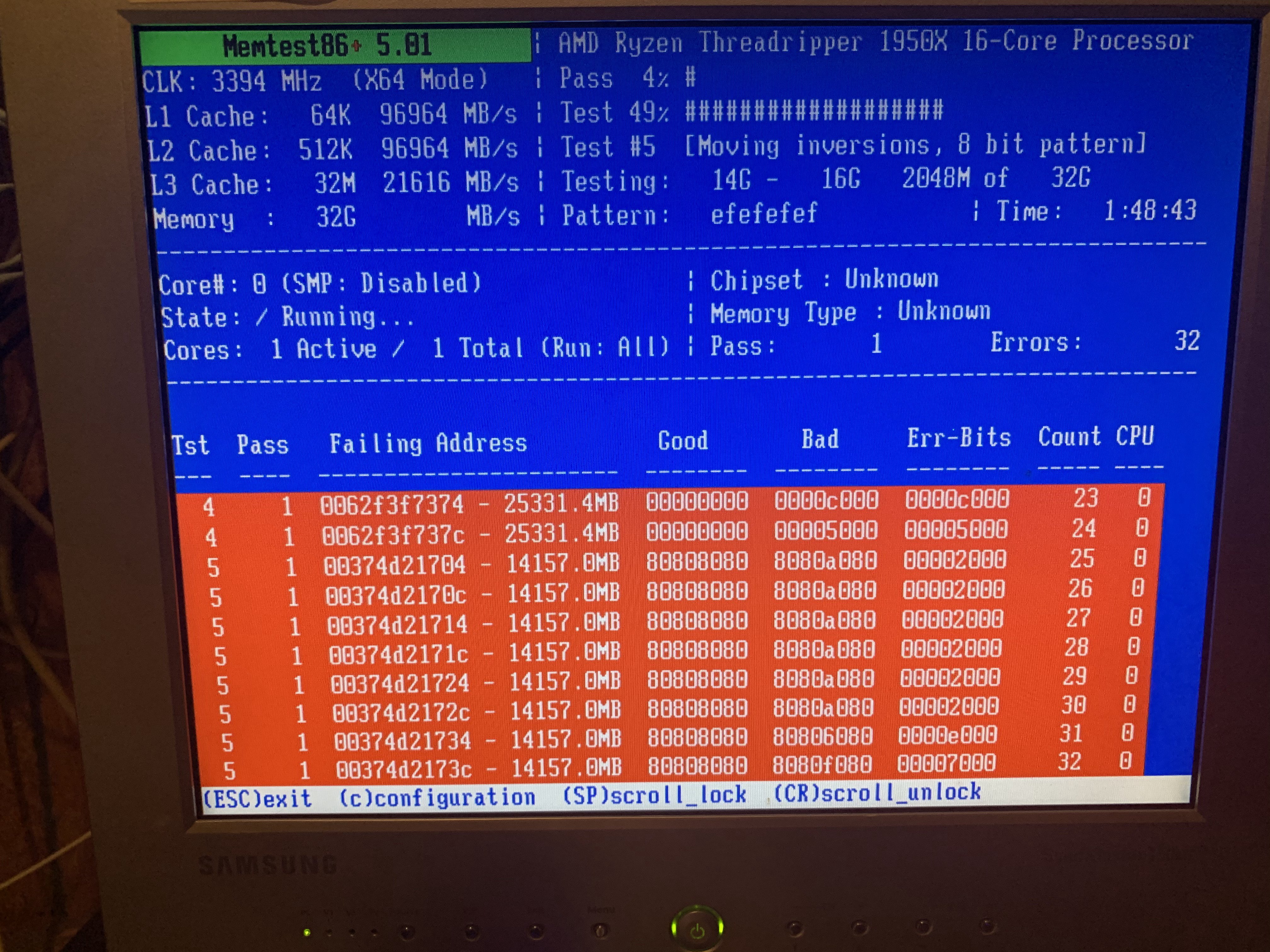

Did you run memtest?
Thank you for the suggestion!  I didn't think brand new ram would could have a problem....but once again I was wrong.  I have 4 X 8G modules installed.  Is there a way to figure out which stick is bad, or should I just start over will all new ram?

So I tested each pair separately ( two tests of 16GB).  Both tests show no errors, so I know the modules are not the problem. When I insert all four at one time I get a ton of errors.

OK...so I took the cowards way out.  I didn't feel like removing the cooler cleaning the TIM and reseating the CPU.   So I ordered 2 sticks of 16G ram and place them in the lower two (working) slots.  memtest showed 100% pass.  SO I think I'm good for now.  One long rainy weekend I'll attempt to reseat the CPU., which I think will solve the problem completely.
