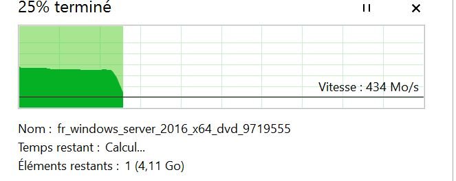

With turbo write you should be able to write to the array as fast as your slowest device, Unraid is not made for performance but it can be fast as long as the hardware used allows it, e.g.:
This is writing directly to the array, not cache, but all array members are a couple of disks in raid0.

Yes, but I wasn't writing to RAM, on the example above only the first few GB are cached to RAM as seen in the transfer graph, here's an example of a much larger transfer:
My point was that Unraid can be fast, the speed you're experiencing suggests some issue, either hardware or config.
