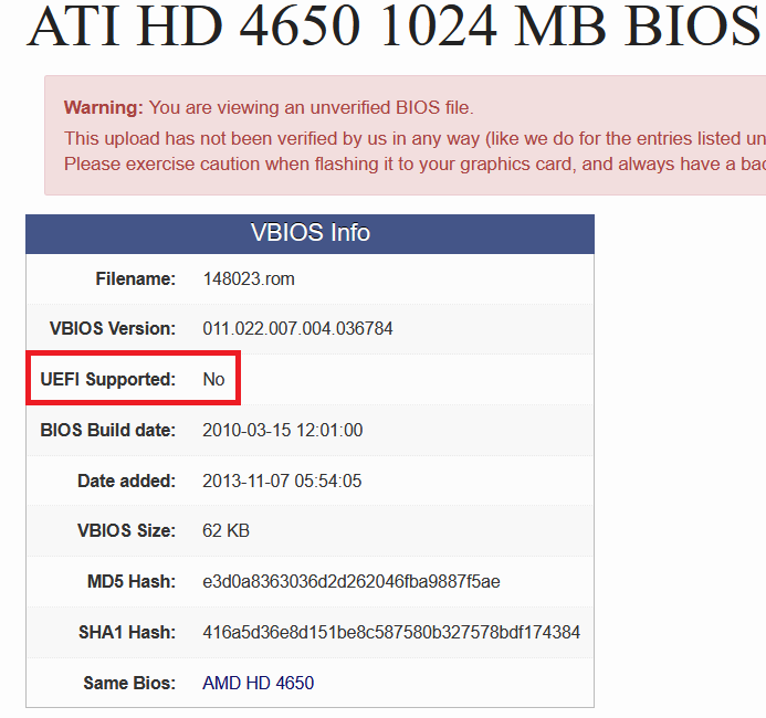

@Sparkles The BIOS of 4xxx gen AMD GPU's don't have UEFI support and therefore you won't be able to pass them trough to a VM. I don't think there are models sold with UEFI support. Below just an example from TechPowerUp
I did not know this. I however did put in a 750ti and am a still having the same issue. I even tried both cards as per another post i've seen since my Motherboard doesn't have onboard video
