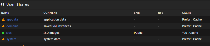

I have the same concerns about Use cache pool (for new files/directories):
Basically, my current shares are
I want to create shares for

I have 256GB SSD for cache pool

@trurl Please ignore the docker and VM shares that I have put additionally.
My main concern is what is the cache mode for all the shares including the Default shares.

The settings in your screenshot for the default shares is good. Up to you whether you want to cache anything else. If so, cache:yes would be the usual setting. Do you understand the differences?
https://wiki.unraid.net/Manual/Shares#Use_Cache_.28and_Mover_Behavior_with_User_Shares.29
All sorts of complicated scenarios are possible if you have multiple pools when postprocessing downloads for example. Understanding is the key to implementing what works for you.
