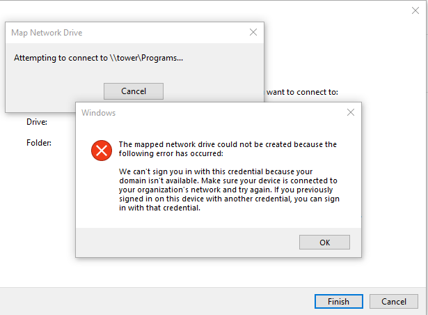

I tried to map a network drive for a share and received the following:
Edited by OriginalFlavor
added screen shot when mapping share

This is a company computer.  You own the company.  Don't you have an IT person?   As I look at this error  message, I suspect that you are using Active Directory and your computer is looking to connect to the Domain Server to check to see if the credential is valid.  When this can not be verified, it not going to give you access to anything.
It is not unusual for companies to lock-down company issued computers to prevent them from being exposed to 'contamination' when using outside networks.  Both from the standpoint of blocking access to external servers and access to the client computer.
By the way, Unraid as a server can not be a Domain Controller/Master for Active Directory but it can join a Domain (as I understand it).

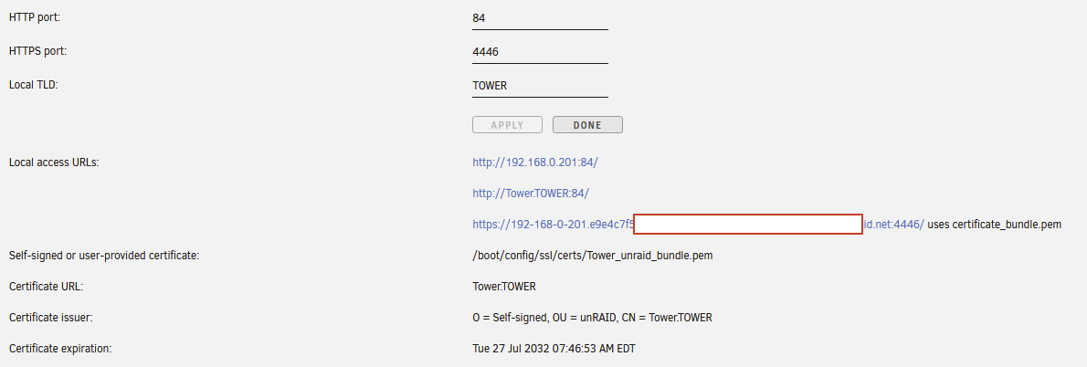

Hi Team....
I have a similar issue. For ages, everything on my network was \\TOWER... Windows shortcuts, Windows mappings, Libreelec Kodi shares on several devices, custom bash scripts, etc).
Nothing is now resolving to TOWER... It will be a chore to go back to get everthing working by changing to the server ip. There is stuff that was made years ago, which I forgot, that will require adjustments.
Is there a way to simply get \\TOWER back?
I have this in "Fix Common Problems"
This in Management Access:
Is there something I can change on my router (192.168.0.1)?
Thanks,
H.
