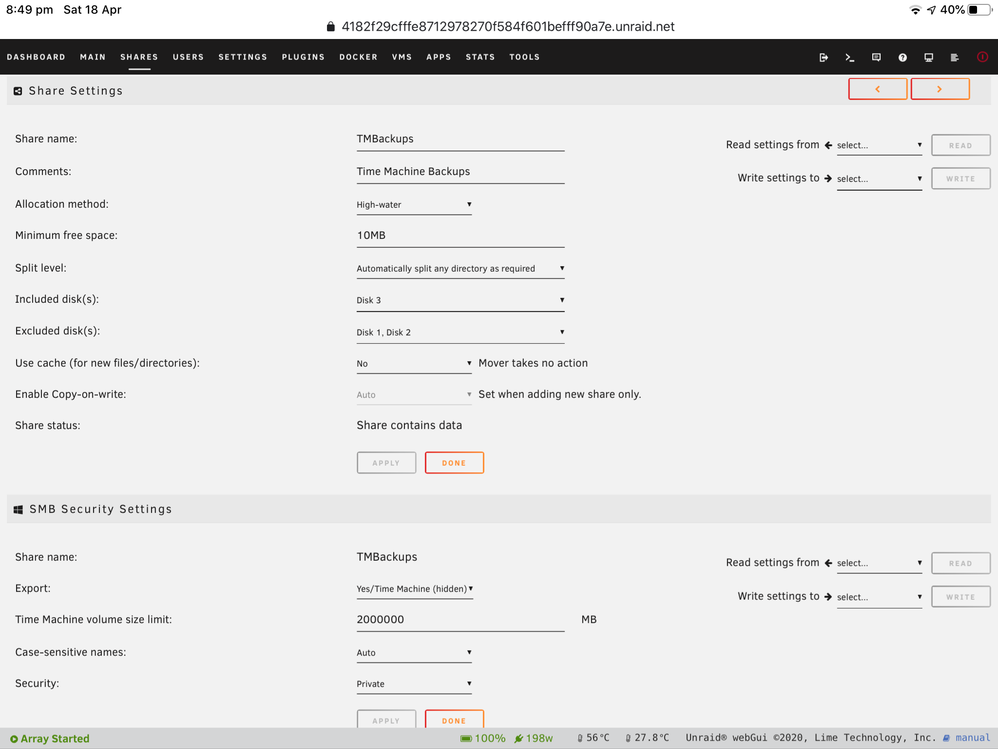

I have the same issue since 6.8.2 All my disks were constantly spinning! I realised that it was my iMac that also had stopped going to sleep, on checking file activity plug-in the only activity was time machine on disk 3 which is the only disk it uses, so something new in 6.8.2 is keeping the other disks spinning? If I switch off time machine all disks spin down. So I deleted the tm backup and reset everything and started a new backup and all disks are spinning again?! What is going on here?

Hi, I get a can't resolve volume error, which I think is to be expected as only Time Machine is connected to the share and will mount and un-mount it as required? Nothing else is mounted from the server, so I'm guessing its not that?
Cheers,
Tim
