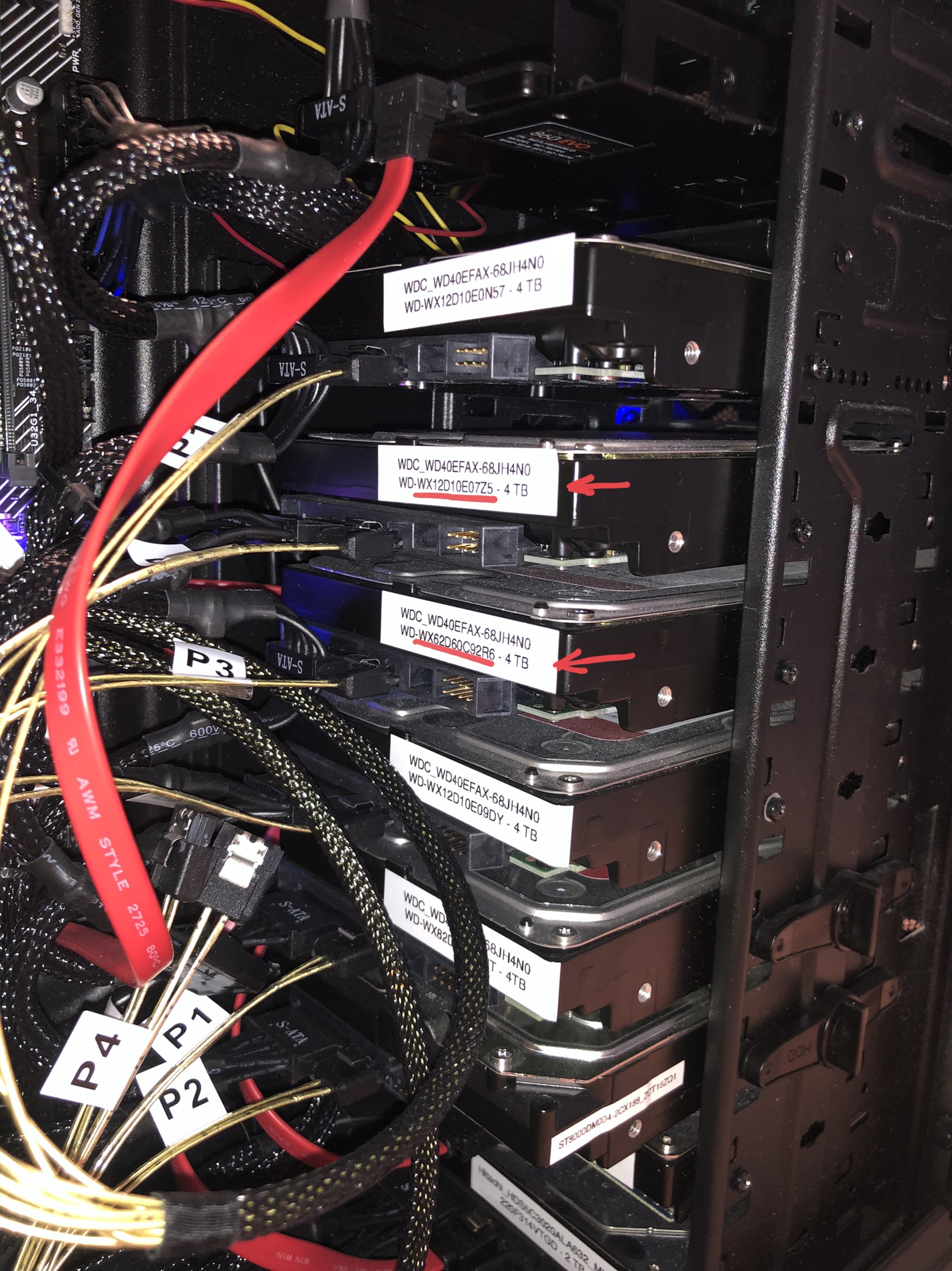

  7. Thanks for your reply! I see the following: Both disks are connected to the same Mini-SAS x4 (SFF-8087) cable on a LSI SAS 9207-8i controller The discs are just installed next to each other. See image! They are NOT connected to the same power cable of the power supply. A look at the syslog shows that all disks at boot (about 06:00) spun up and were imported. Later, they were spun down. But I don't know where to see when the errors occurred. Do I overlook something? Any further ideas? best regards Andy
