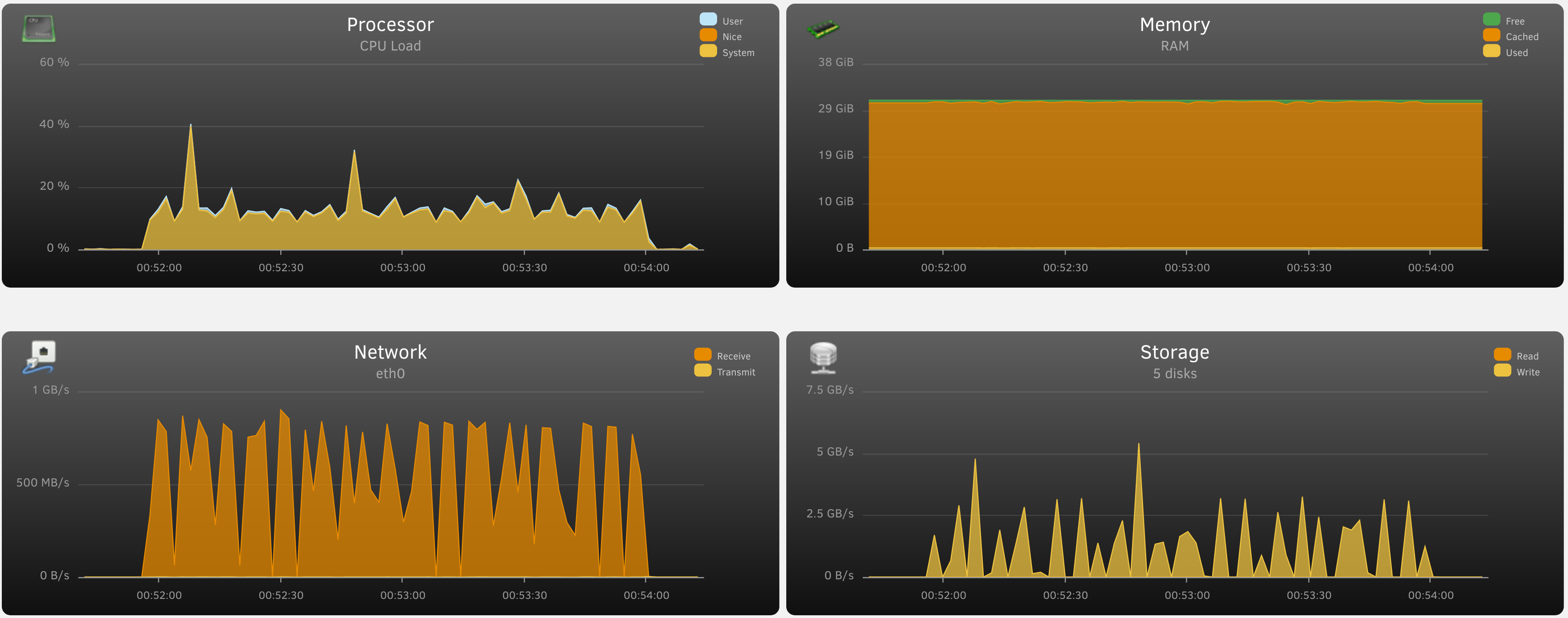

1. Write test directly into the array: user share with no cache enabled:
7:57 min -> 152 MB/s
This is a slightly disappointing result; even my old external USB drive was faster than this. But I think the reason is: Parity needs to be updated at the same time(right?).
Disk settings (md_write_method) is set to reconstruct write. I understand this should be the fastest option?
As you can see in the picture above: there is no constant stream of data over the network. It looks more like pulsing. Same for the drive activity.
Is this considered to be normal?

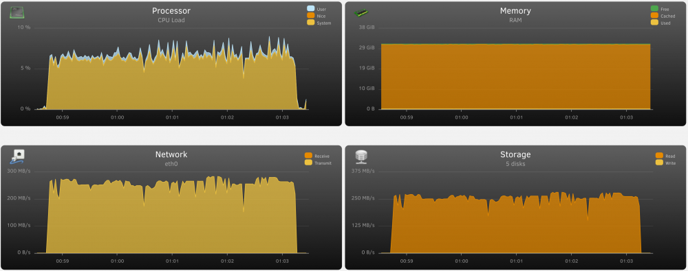

2. Read test directly from the array: user share with no cache enabled:
4:37min -> 261 MB/s
As the read speed relates directly to the performance of a single drive... I think this result is acceptable.
As seen above: network and drive activity seem to be just the same... and a constant stream of data. Looks ok, right?

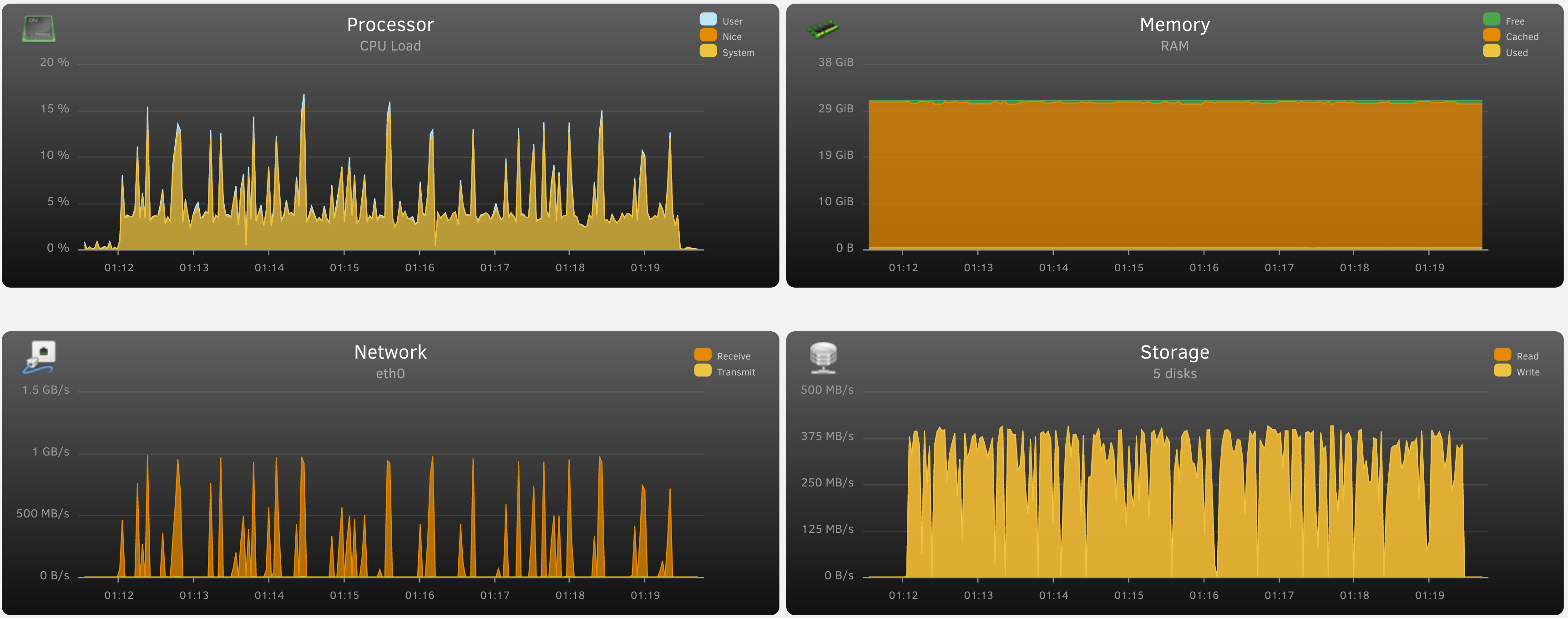

3. Write test to a cache only user share:
2:05min -> 579 MB/s
Now with this result I'm very disappointed. As far as I understand parity is not updated when writing to the SSD cache?
What setting could have an influence here? (Cache pool of 4 Samsung 970EVO)
Again there is no constant stream of data.
That's normal?

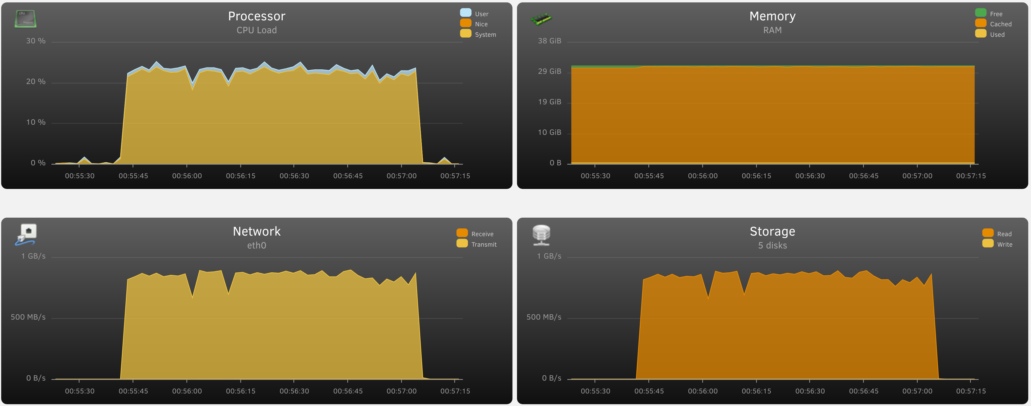

4. Read test from a cache only user share:
1:24 min -> 861 MB/s
Again a slightly disappointing result.
The stats above seem to be ok.... it's just too slow. I was expecting to get at least >1 GB/s from a 10Gbase-T network.

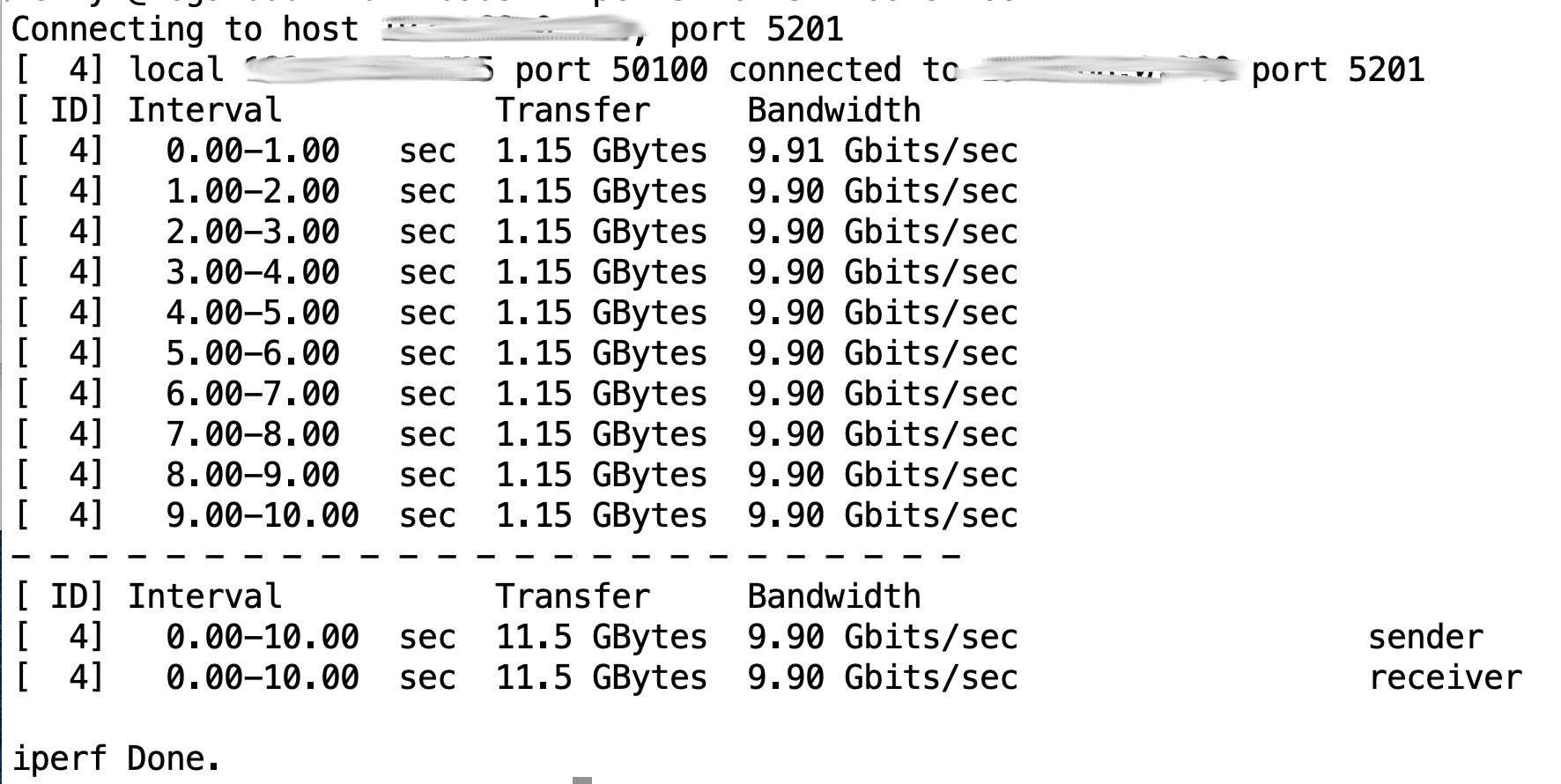

Hello all,
I just did an iperf check to reconfirm the issue is not the network itself. Here are the results:
Looks pretty solid I think.
