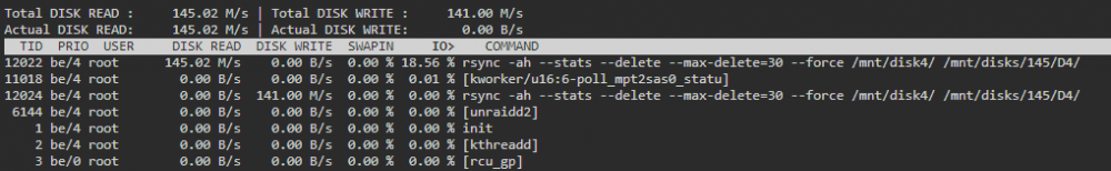

Due to I haven't network transfer to do this time, but I would show a local transfer by rsync.
For example, array disk rsync to a UD disk ( ~200GB data, large file ), a steady 145MB/s could be achieve.
