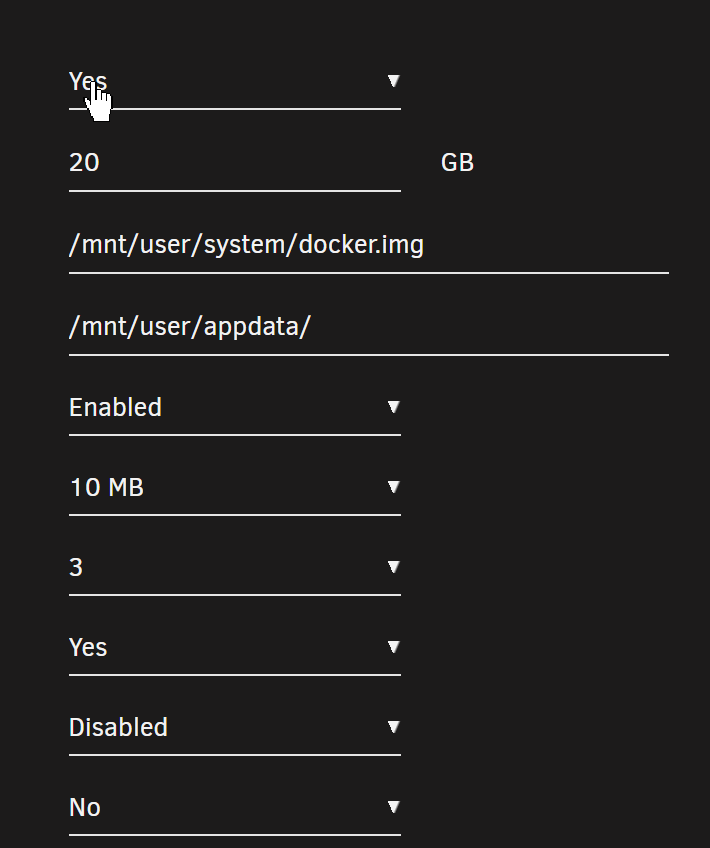

I have removed the Docker image file and then created a new one.  Here is what that looks like:

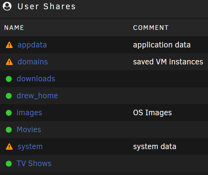

You still have a lot of unused config/shares .cfg files that makes it difficult to see which shares you still have. Maybe a screenshot of the User Shares page for future reference as you progress?
Ah ok.  How can I clean those up?  Just delete them?  Don't want to bork the whole thing.  I just want my movies and tv in tact.  I bought filebot and I ran some renames on that.  Want everything up to par before I bring up nzbget and sonarr and radarr.

Still a little unsure about your anonymized share names. Some are showing up in the diagnostics with upper case, but your plex mappings don't seem to match that.
Post a screenshot of the User Shares page.
Sure...
That doesn't agree with that last plex docker run you posted. Did you redo your plex docker since you posted that?
Yes, I think I changed to TV Shows from shows.  That was FileBot moving things around for me.  Do you need me to post anything to confirm that?
