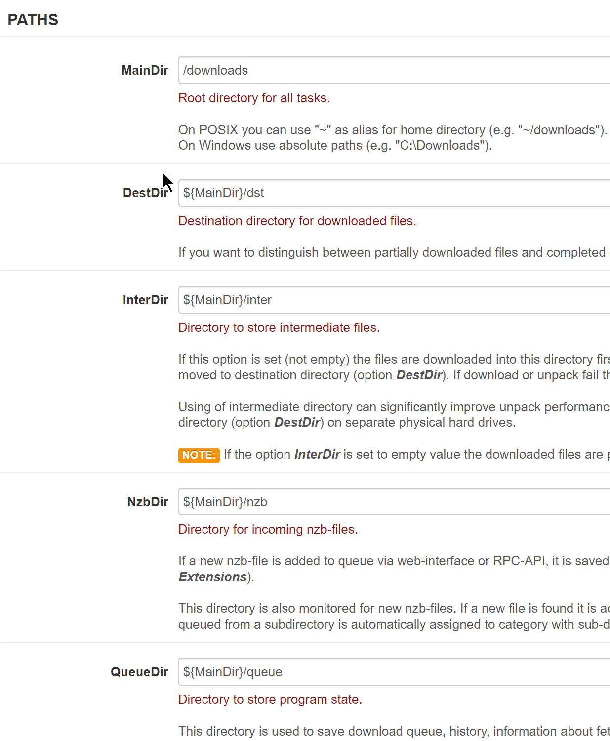

Here are the paths inside nzbget:

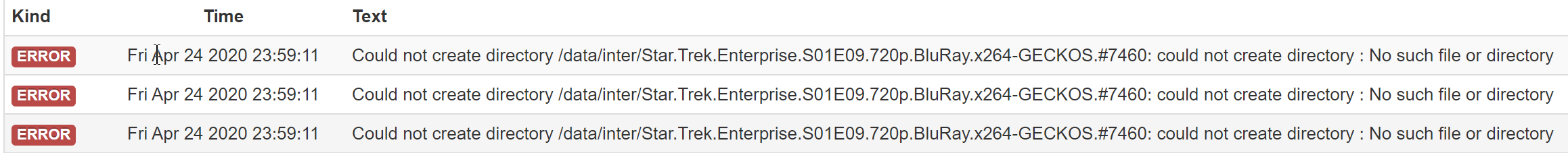

5 minutes ago, aneelley said:
Seeing an issue now with nzbget fetching files.  It seems to be looking for a directory called /data but I am seeing error messages, "Could not create directory /data/inter/......then it lists the download (show, etc)"
Where are you seeing this?
In the messages for nzbget.  Screenshot:
Is this an NZB you added yourself?
Note, I only have Plex and Nzbget going.  Have not installed radarr or sonarr yet.
And you aren't using the appdata from a previous install?
As in, added to NZBGet manually and since you installed it fresh?
I swear I deleted it but when I see all those downloads rolling, I am thinking I did not.
No, it appeared once I started the container.  Not sure what to do at this point.  Really don't want do have to have Plex reload all of it's metadata.
I found out the issue.  So I had removed the appdata/plex folder.  The issue was in /mnt/user/downloads/inter directory.  It was full of intermediate download files.  Removed nzbget container and removing the inter contents and then I will re-install nzbget.
That is done and nzbget has been re-installed.  Now to configure it:
