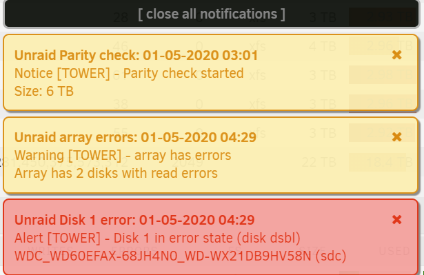

This morning after opening UnRAID I saw a warning that 2 disks have read errors and 1 disc is in error state and disabled.
They're both new WD RED 6TB drives that I've been using for the past few months. One of them is a Parity disk and the other is used for storage.
Under Array Devices, the Parity device has a green indicator next to it like nothing is wrong, but Disk 1 (the other WD drive) is disabled.

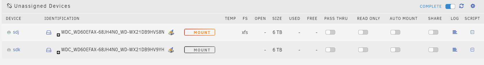

Both drives now appear under 'Under Unassigned Devices'. I'm confused why both of them got unmounted automatically (never happened before) and for some reason the data drive that's offline has the orange 'Mount' option and the Parity drive which appears as though it's active (green), is grayed out.

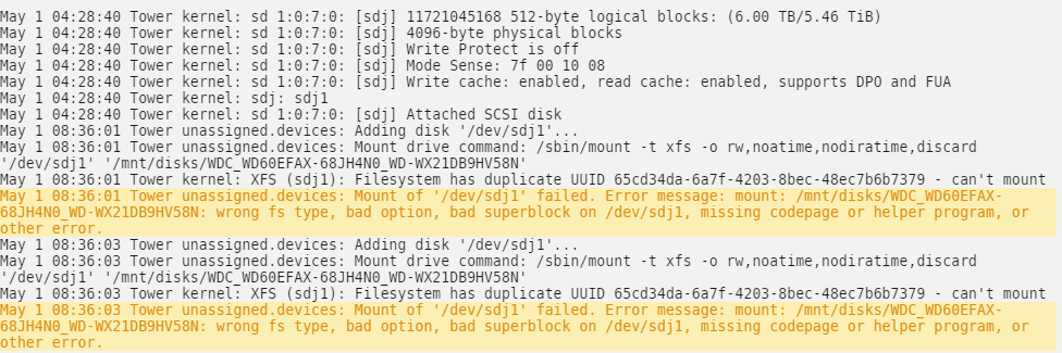

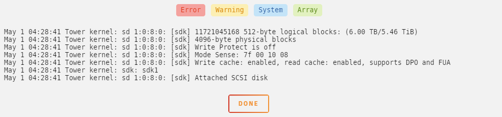

I'm unable to get the SMART report for both drives. I tried spinning up the disks to get it, but it won't let me. I was able to get the Disk Log for both drives.
Disk1
Parity Disk

Definitely before since syslog went back about a week. But then a parity check started at 3am this morning (scheduled I assume) and disk1 and parity both starting giving read errors.
Was your previous parity check completely clean?

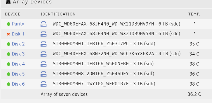

Quick update.
Just restarted after checking everything.
  • First thing I see after signing in image.png.0197b21cd7f23f5fcd82ac33205c4841.png
  • Both drives are mounted
  • Parity drive looks fine now
  • Disk 1 is still disabled
This is expected since the error count resets on reboot.
And it will be disabled until it is rebuilt. When a write to a disk fails, Unraid updates parity anyway so that failed write and any subsequent writes can be recovered, but now that disk is out-of-sync and has to be rebuilt from parity.

There was a problem with both disks at the same time:
May  1 04:28:34 Tower kernel: sd 1:0:0:0: device_block, handle(0x0009)
May  1 04:28:34 Tower kernel: sd 1:0:2:0: device_block, handle(0x000b)
May  1 04:28:36 Tower kernel: sd 1:0:0:0: device_unblock and setting to running, handle(0x0009)
May  1 04:28:36 Tower kernel: sd 1:0:2:0: device_unblock and setting to running, handle(0x000b)
1:0:0:0 is disk1, 1:0:2:0 is parity, this suggests a cable/power issue, they like share a mini SAS cable, could also be a power connector, like a splitter, if shared by both.
Which explains why disks that started out as sde and sdc became reallocated as sdj and sdk under Unassigned Devices.
