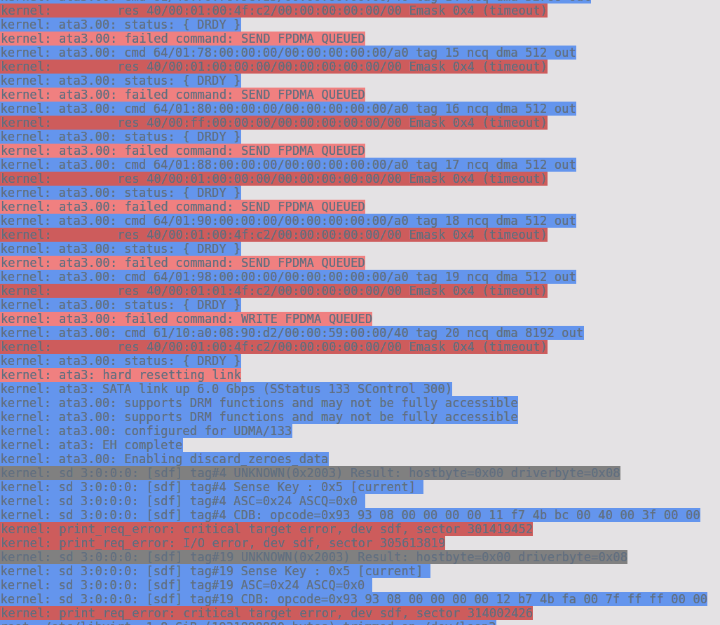

I get seemingly random print_req_error: I/O errors (which then causes odd docker/vm/share corruptions/issues) when the array has been on for several hours, usually at idle.

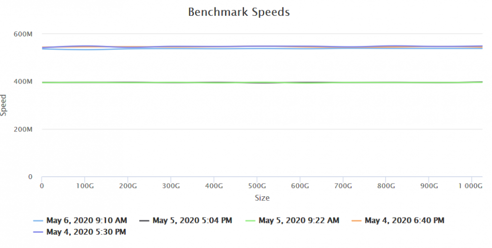

    • Unfortunately, onboard Asmedia SATA controller has massive speed degradation (blue line vs green/black lines in image below) compared to controller card.

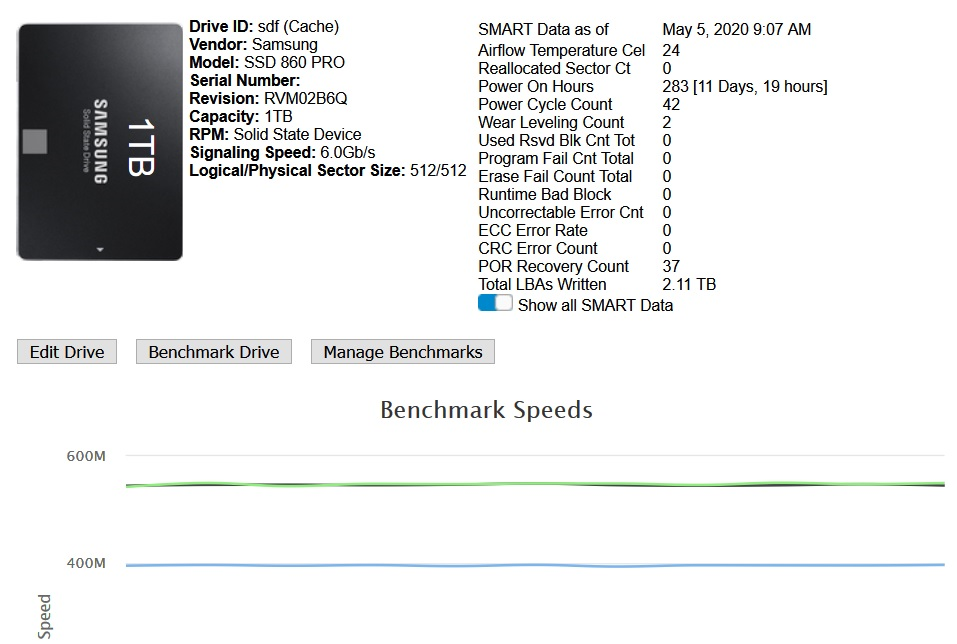

Been hammering away at this one for awhile. The SSD is new, I have a hard time believing it is at fault, especially since these errors reference apparently random and different sectors.

So this looks like it is a TRIM issue as I have that set to run daily at 5A and it just goes haywire with the system.
I was browsing the web and came across another post of yours @johnnie.black from a year ago. So the issue is that there appears to be only one specific subset of cards with a downgraded flash that supports TRIM.

Well, after moving the cable to the onboard AMD controller, success. At least now I know the drive isn't bad.
And speeds look to be back up to where they were with the LSI controller. Not quite sure what the issue was with the onboard Asmedia controller, but maybe I have a hidden BIOS setting that needs tweaking.. or that particular port was bad..
It's a PCIe x1 controller.

13 hours ago, Skrumpy said:
I thought even with PCIe x1 you could still get decent speeds depending on the protocol?
Max theoretical bandwidth for a PCIe 2.0 x1 link is 500MB/s, max usable bandwidth is around 400MB/s.
