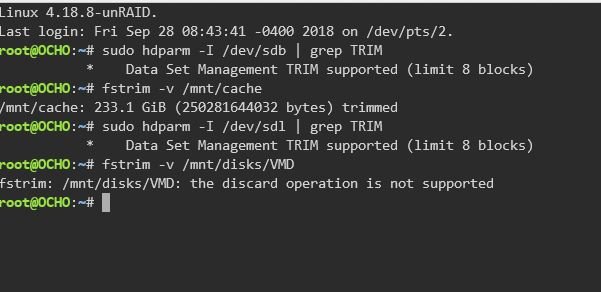

Confirmed a 9300-8i (P16) resolves the TRIM issues with BTRFS.
root@arnold:~# fstrim -av
/etc/libvirt: 920.7 MiB (965439488 bytes) trimmed
/mnt/disks/vm_ssd_1: 219 GiB (235152539648 bytes) trimmed
/mnt/cache: 202.6 GiB (217502179328 bytes) trimmed
