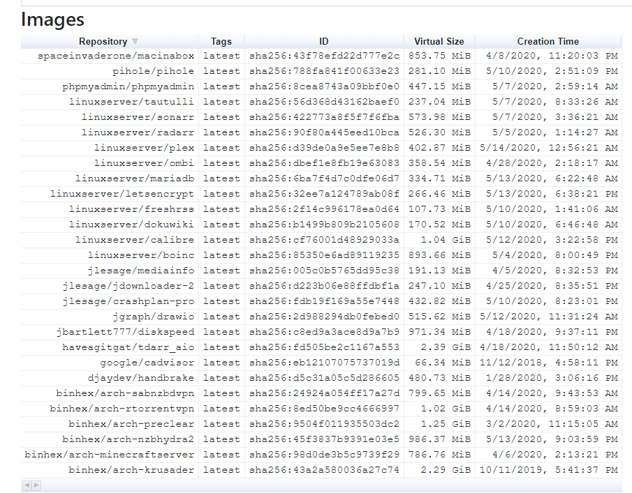

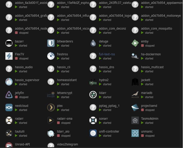

Way too difficult to read. If someone else gave something like that to you would you even try to make any sense of it? Maybe a screenshot would be better unless you want to go to the trouble to reformat it into clear columns.
Really all I wanted is a list without all those details for each. A screenshot of the Docker section on the Dashboard page. I thought we could get into the other details as needed. And those details you dumped there will not really be sufficient for the problem of filling docker image since that also depends on settings within each application.
Do you understand docker mappings of host paths to container paths? Do you know Linux is case sensitive? Do you know to use absolute and not relative paths to refer to the container paths within the application? Do you know why I'm asking these questions and what their importance is?

You certainly have a lot of dockers. Do you really need all those, or are you just experimenting? Are you really using emby and also plex, for example? Many of those I have no experience with or even know what they are for. Probably we are not going to get into the details of many of them so it would be best if you can figure this out on your own.
Well most ot them (on the top) are container relate to my Home Assistant instance.
Right now I'm exerimenting. I have issue with plex and I'm testing emby to see if it has better performance. In the same experiment there are involved others containers like unmanic and tdarr. But they are normally stopped so I will start with other container check that evey path is correct.
OK I've checked all the containers and the path seems right.
Maybe the one can be this : full-text-rss
It is not based on a unraid template and it has not any mapped path. It is based on this : https://github.com/heussd/fivefilters-full-text-rss-docker
How can I check if it is the right one?
