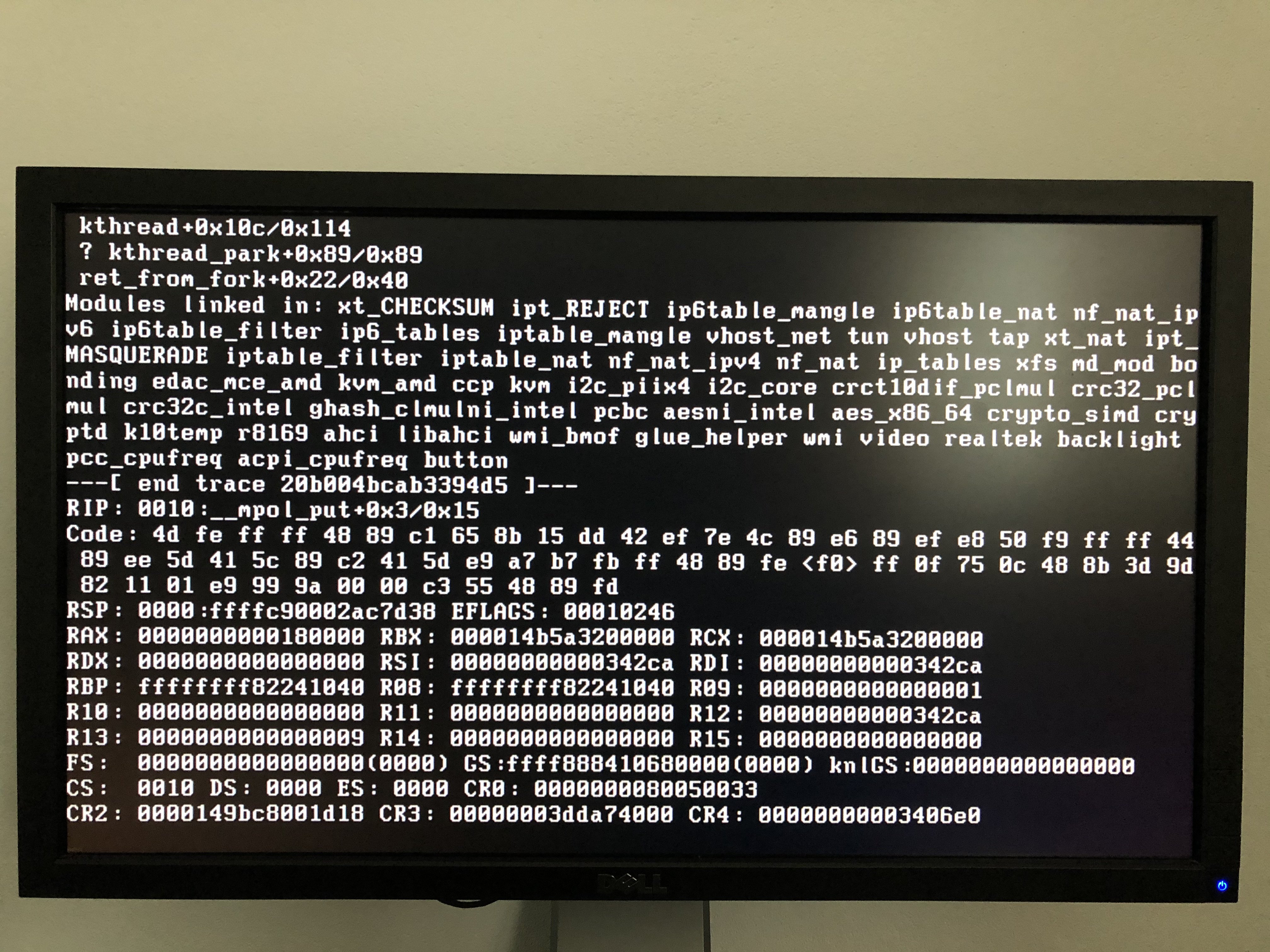

i watched videos from spaceinvaderone, how configure a ryzen pc for unraid but my system runs sometimes 2 oder 3 hours and sometimes 1 day but then i cant reach my server. i have to reset manually 😞
svm mode is enabled, iommu is enabled, c state is disabled and i wrote rcu_nocbs=0-7 to syslinux configuration. but it wont still work!
please, help me *cry*
/edit: i don't get a log file because i have to reset my system.

i checked the ram, there are in slot A2 und B2. In BIOS was DRAM frequency on AUTO (DDR4-2133) but i changed it to DDR4-2933.
and i found a second c-state option.
in CPU Common Options - Global C-State Control is now disabled (was still on AUTO) and in DF Common Options - DF C-State Control was already disabled.
i'll try it!
my last session was about 3h, i took a picture

okay, i think i found my problem 🙂
My server is now online for 3 days and 21 hours. At first I thought I had to change Dram to 2900 MHz, but now I've changed it to 2600 MHz and the server is running all the time.
Yes, like posted in the link above 2666Mhz is the max supported speed for that CPU, anything above that is overclocking and likely to cause issues with Ryzen and Linux.
