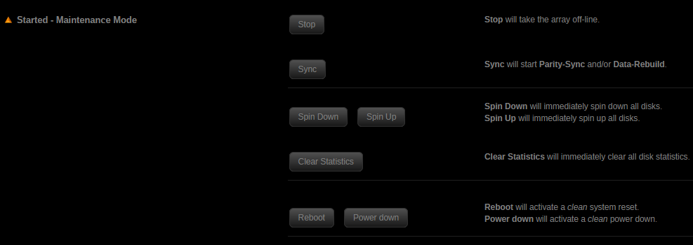

Assign the disk and start the array. Then post a screenshot of Main - Array Operation.
Thanks again for the help.
FYI, in case it matters. I started in Maintenance Mode.
EDIT:
Edited by JPilla415
I've never done that or seen anyone else do it when they are trying to rebuild a disk. It might work if you pressed the Sync button (at least according to the description), but I would be more familiar with what is happening if you started it in normal mode. And I don't know why you would want to do it in Maintenance mode anyway. I don't see how that would be any safer than doing it the normal way.

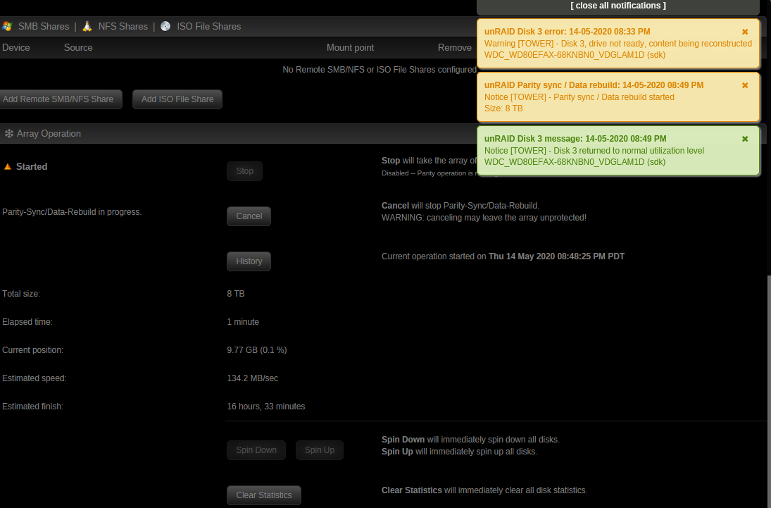

Just start it in normal mode and post another screenshot.
And you still have the original disk (I assume) in case something doesn't work out for some reason, so all the files are still on that original disk.
I was trying to play it as safe as possible, keep the array in the exact same state, so that I could always load back in my old data disk and USB config in case I had a disk failure during the re-build. Things seem fine now, as soon as I started the array in normal mode the rebuild fired off on its own. I guess if you're in Maintenance Mode, the data rebuild doesn't start automatically, as per the wiki. That paired with my missing "step 2" in the wiki, had me concerned.
Edited by JPilla415

Well, data rebuild is at 10% and things look alright so far. I really appreciate the assistance earlier.
Fine to rebuild in maintenance mode, just need to press sync to kick it off.
Of course this means your array is offline until done and you start normal so many would not want to do it that way. Interesting that I have never seen this done or recommended.
It's not a common thing but I've seen some users who usually do it like that, it's safer in case a different disk fails during the rebuild since you can use the old disk and parity will still be 100% in sync, it won't be just by starting the array normally, even if no other changes are done, and while this is usually not a big deal if you need to use the invalid slot with xfs disks it will be with btrfs disks, since they have a transaction ID and just by doing a single mount it will be out of date with the old disk.
That is what I had come to understand. I know data rebuilds can put more stress on disks than day to day use (at least in my case), and I like to play it safe when rebuilding. I only have one parity drive at this time, and until I have dual parity set up I don't mind the system downtime if it helps to de-risk things.
Good to know that manual intervention is needed to start the rebuild when in maintenance mode. I didn't recall that being necessary in the past, but it is completely possible that I am forgetting.
