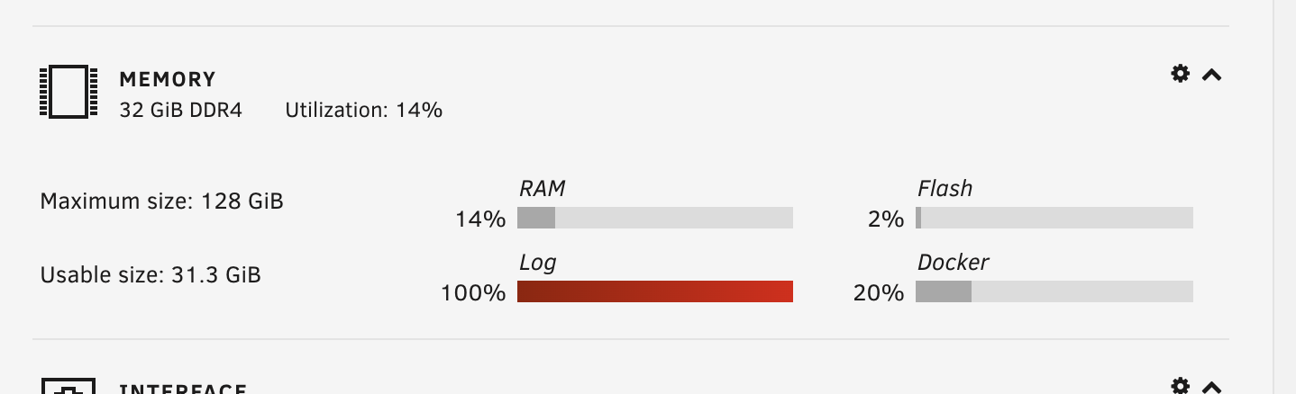

Log 100%
Under the memory section on the dashboard. Log is 100%? Is this bad? What causes this?
Thanks!
OK I rebooted and it went away, but I still would love to know if anyone knows common issues that would cause that.
