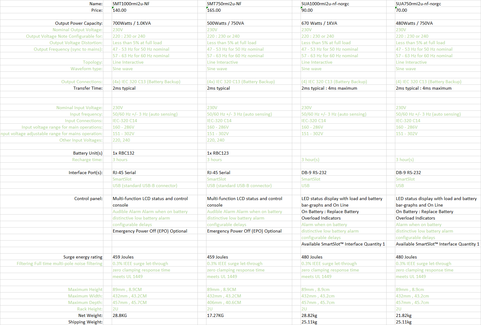

I think I've whittled it down to these 4. The 2 end products seem to be older LED models while the first two are LCD info panels hence the price difference.
I'm not sure if there is any potential features on this list (or missing must have features that aren't on any of them).
Uneducated guess would tell me that the 1st product (140) is the better one (I don't understand why it's cheaper than the 2nd product)?
Any suggestions/tips?
image.thumb.png.265546ac5b7244322ea84f86e071c0a0.pngimageproxy.php?img=&key=e5eec7c5c933ca16
Edit: forgot to mention: Features listed in green are the same across all 4 products
Edited by Dal1980
I don't understand why you will compare the price different on those old unit, it mainly depends on their condition and price setting from seller.
They just two series SMT and SUA, SMT should be replacement for SUA and have some advance feature but those not importance.
SUA (my one) are quite old model which mfg over 10years, that means they should have life time issue, so half in price could be understand, you should consider that too.
Pls also understand the purpose of UPS, for me, drive power capacity and battery capacity always are two main factor for selection. Otherwise don't waste space, money on that, because it can't provide reliable protection.
Edited by Benson
Form table list, the only thing draw my attention was the weight of SMT750, it should because build with a small capacity battery. ( like previous mention 84WH ). Your setup should use ~200w power usage during system shutdown, so have 20+ min, if consider the degrade of battery with time, it should still acceptable.

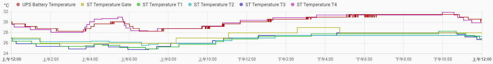

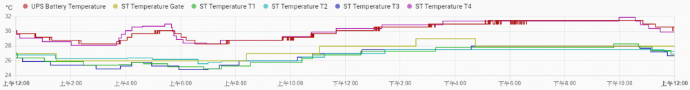

Below is a temperature measurement FYR, T4 are the UPS surrounding temp, you will found it always higher then room temperature ~4C, it only apply ~170w loading actually, that means UPS also use lot of power.
For the communication language, I haven't much idea, but I think NUT or APCUPSD most use "old" language to communicate.
