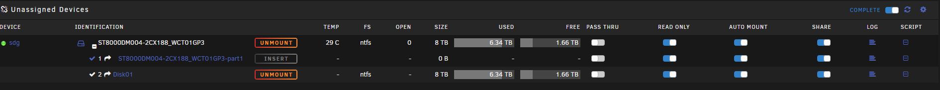

Almost got this -- and appreciate the help thus far.  I've enabled the share in the drive and auto-mounted it in Unassigned Devices. I'm simply not seeing in the windows share.  Am I missing something altogether here?  Thanks!
It might take a few minutes to appear after enabling, if it takes long reboot Unraid and it should appear at array start.
You have to share it in Unassigned Devices.
That's what I've got set up there... am I missing something else here?
*I just enabled Pass Thru and that seems to have resolved my issue.  I'm guessing that was the missing link?
Edited by AdrianF
Addding Pass-Thru update.
Read only is not needed (but should be OK) and you have two partitions, share only the larger one, but there might be an issue because of having both, you'd need to ask on the UD thread.
I'm doing the Read Only as a precaution because I don't want to delete anything JUST IN CASE something goes wrong with the migration.
I just hit 5.01TB on the last file and it switched to the second drive while using W10 and the shares.  Looks like I'm finally in business to put the second drive in once the rest of Disk01 is finished copying.
