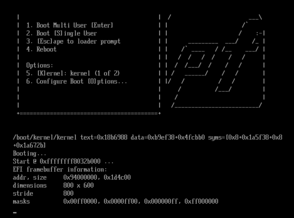

pfSense not booting
Hello.  When I launch PFSense for the first time I get stuck on the black screen where it says booting... and nothing else happens

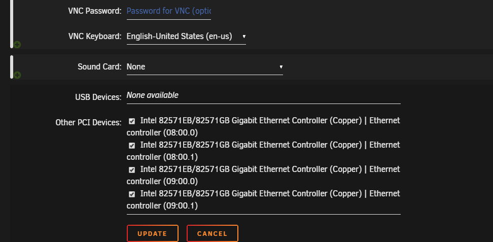

I did some searches and someone mentioned it has to do with the CPU pinning but I pinned 2 threads on 1 core.  I even tried switching the pinning to a different core.  I had 1 and 7 pinned but now I have 5 and 11.
So Im a little lost here.  I used the vfio plugin to get passthrough working.  I also had to enable ACS override to get the IOMMU groups broken up.

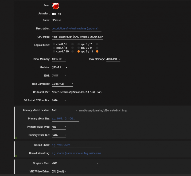

Here is my pfsense VM config
Part 1
Part 2
I asked on the pfSense thread but nobodw was responding.
I have attached my pfsense logs and my IOMMU group in txt files.
Any help would be appreciated.

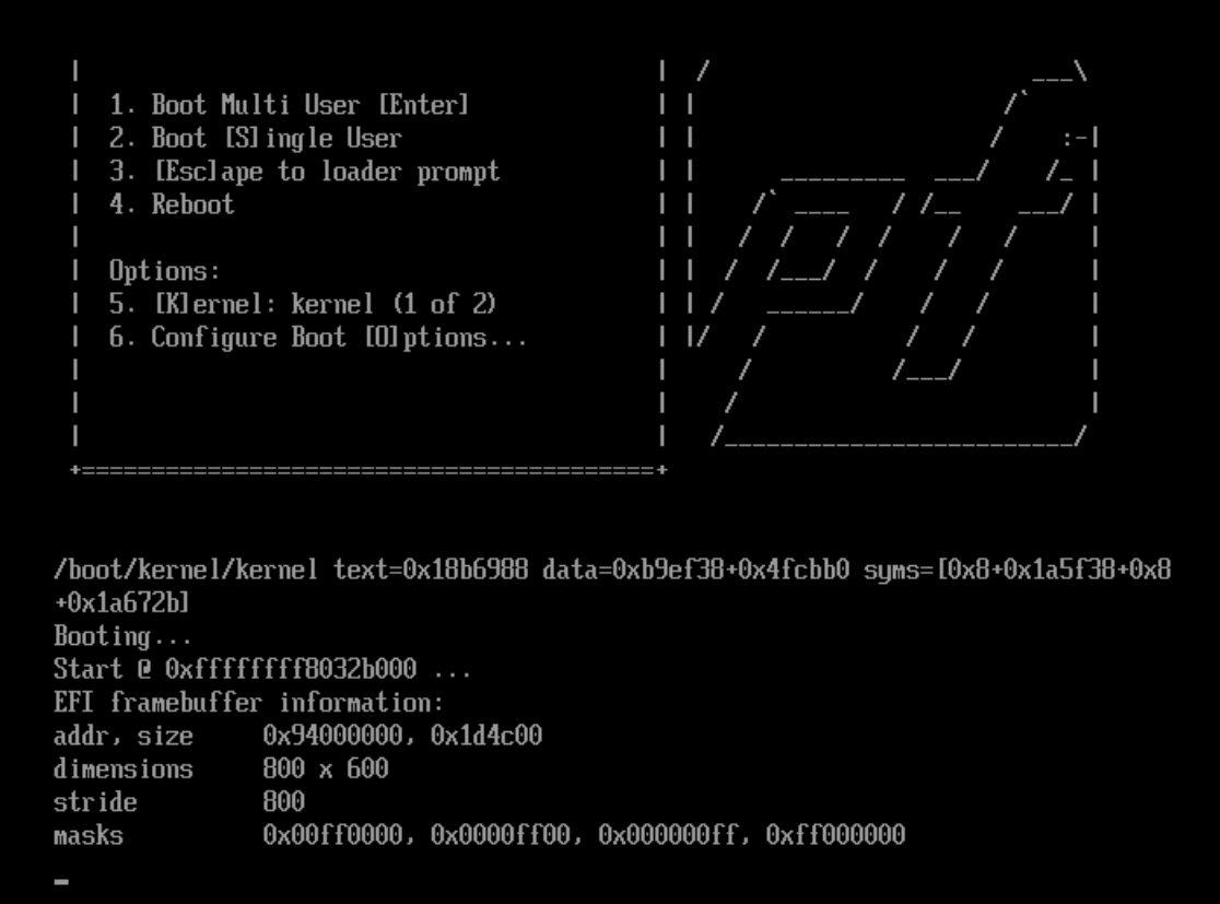

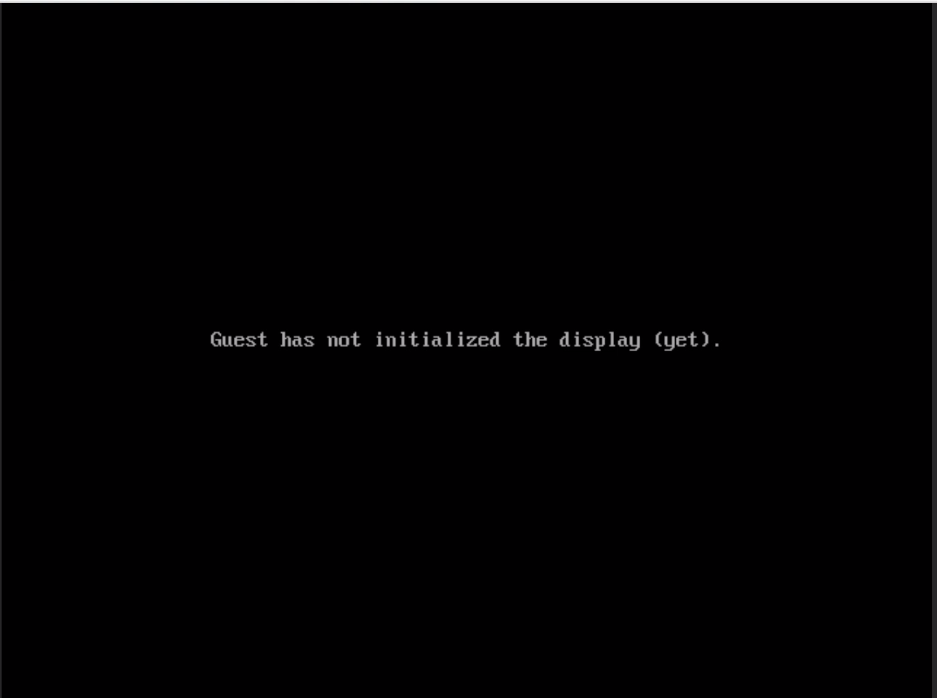

I switched it to q35-2.6 and I get the following when launching VNC.
I tried 2.7 and it reverts back to the original issue.  Stuck on the boot screen.  I have attached log.

did you install on 2.6?  if not, reinstall on 2.6
I switched it to 2.6 and uninstalled and reinstalled on 2.6 as well.  I tried 2.7 and the if drivers as well.  2.6 is the only one that gives me the guest has not installed the display.  The rest get stuck on the boot screen.
