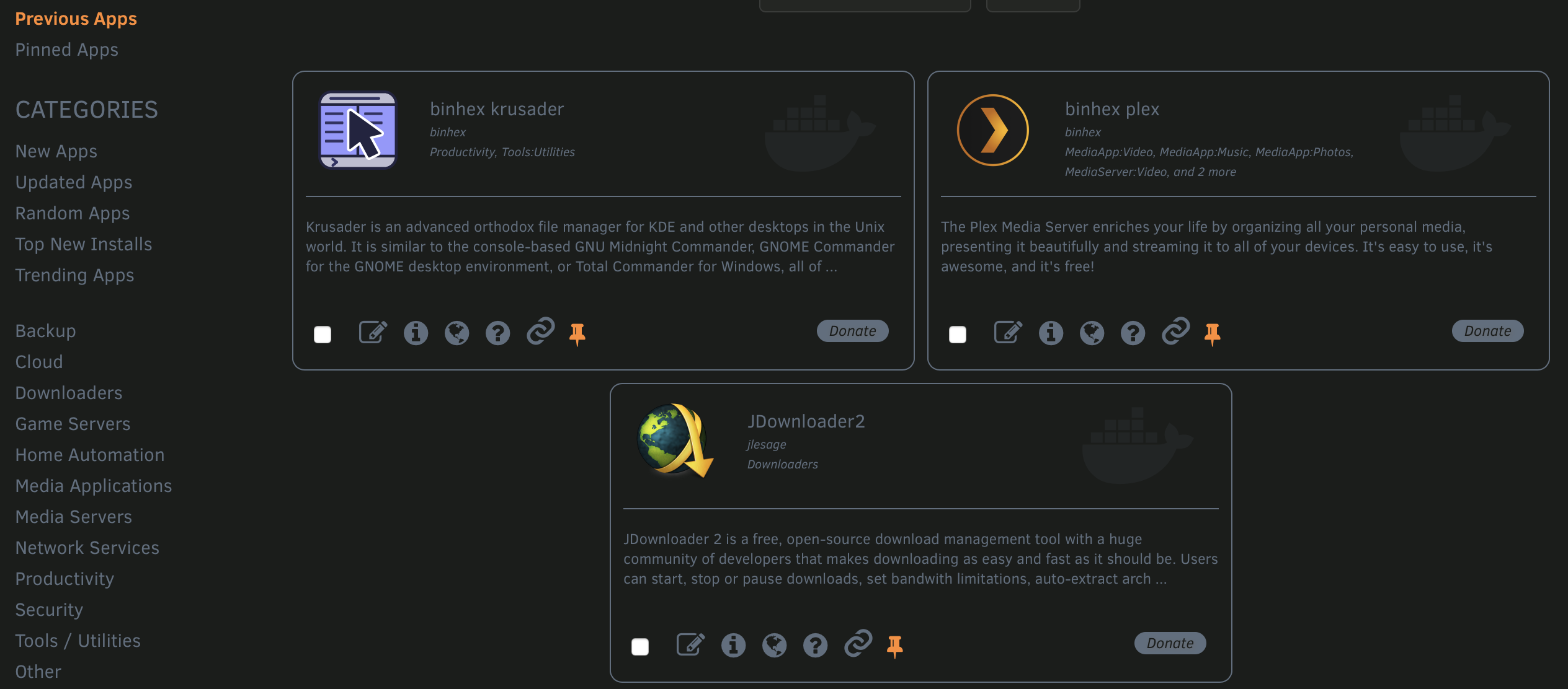

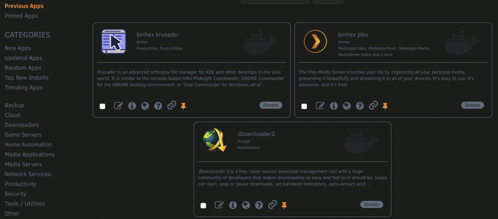

Hello again,
Please take a look at these pics... These containers were installed before, but diappeared.
I clicked on re-install... and hope, my data is not lost yet.

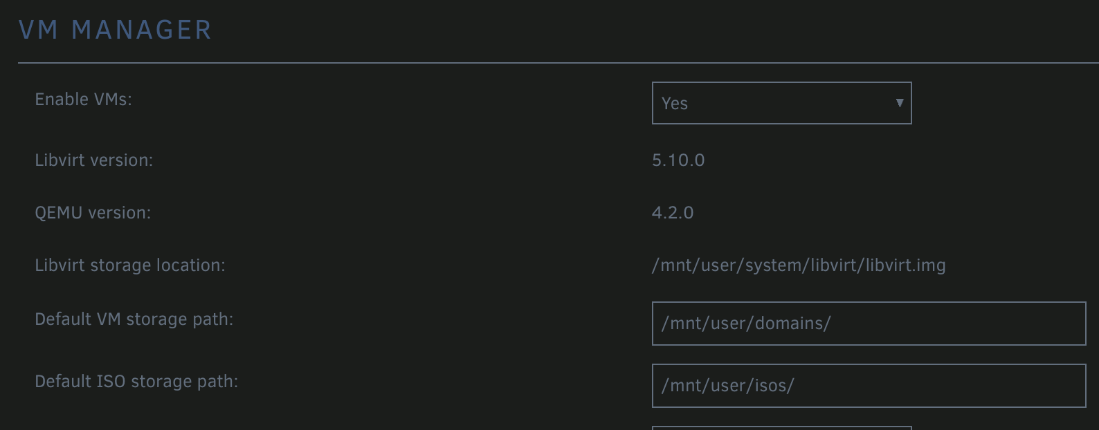

@johnnie.black I did not find your mentioned setting. Please take a look at my second pic.
Thanks in advance.
Settings -> Docker
and
Settings -> VM manager
(some options will only show with advance view enable)

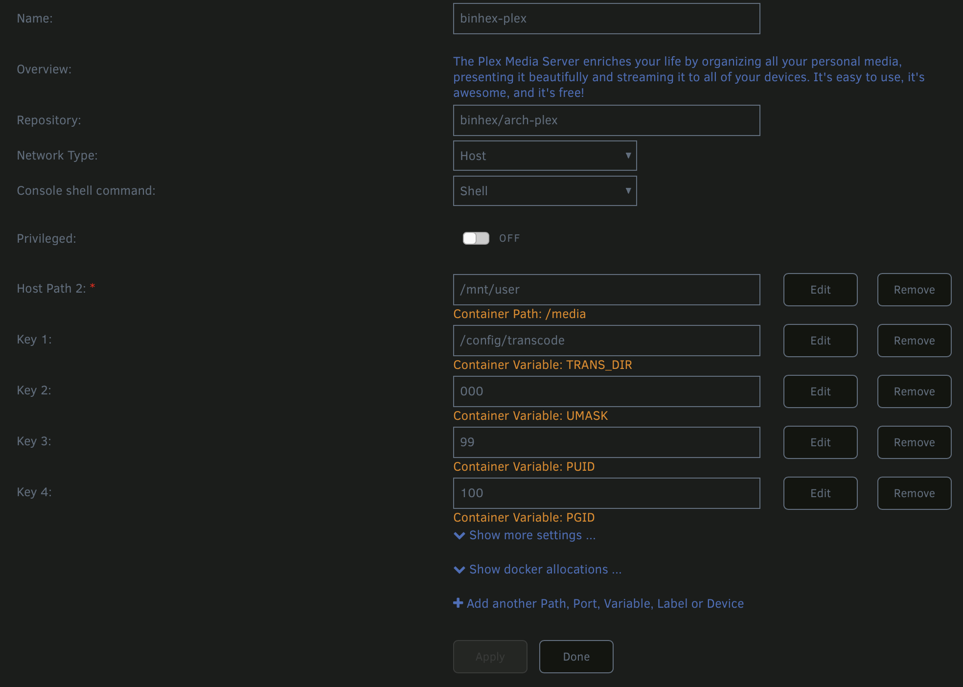

Okay, plex docker container is running... Thank you.

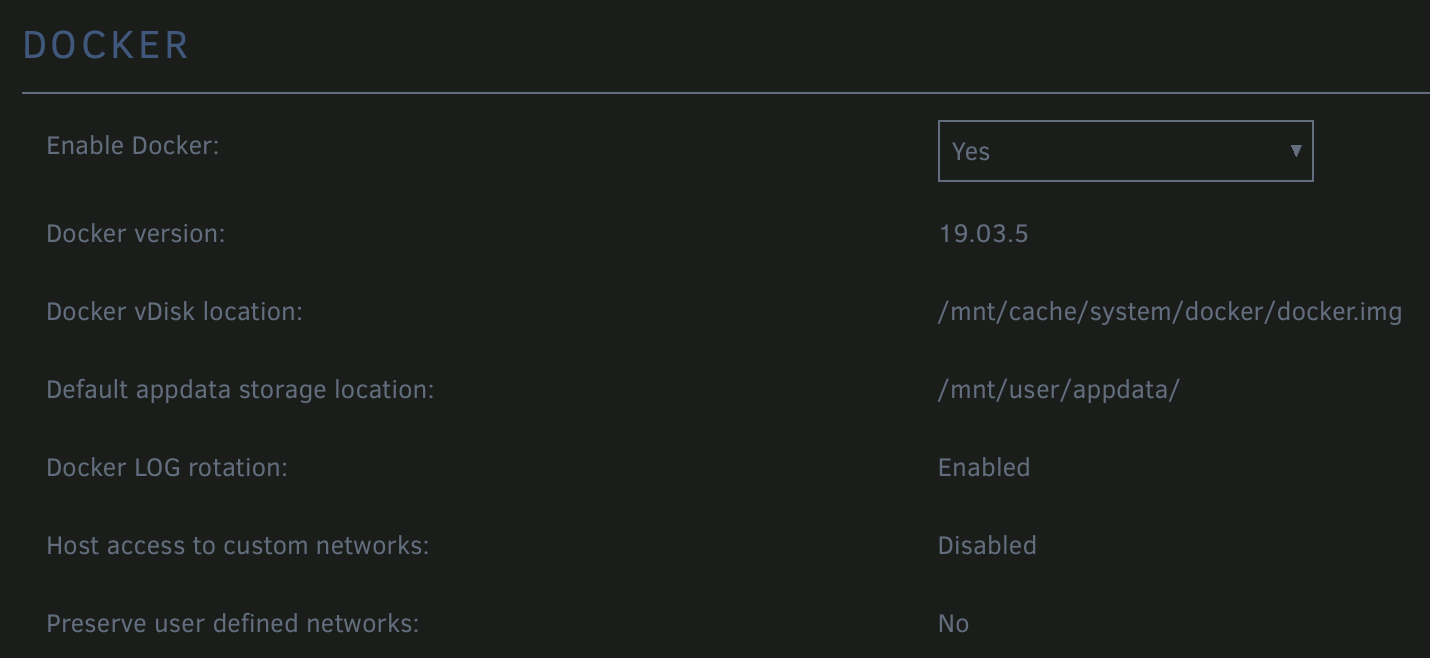

This is how it is looking right now:
Recommended doing the same for appdata, but note that as of last diags there were some files on disk1 and cache, so you need to move them first.
So, in docker settings I have to change /mnt/user/appdata to /mnt/cache/appdata, right ?

And, for the VM Manager settings I have to change /mnt/user/system/libvirt/libvirt.img to /mnt/cache/libvirt/libvirt.img ?
