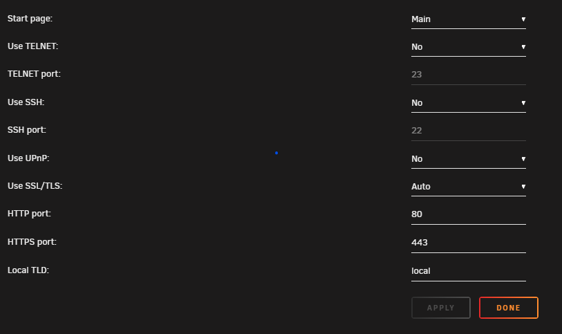

June 30, 20206 yr Author I just realized that I had opened the ports to the dashboard long back when I followed some tutorial. The server was off for 3mo, and I just got back into setting everything up. Forgot about this setting. 😧 . I have turned of these setting in Management access as follow. What should I do now, if the server might be compromised.

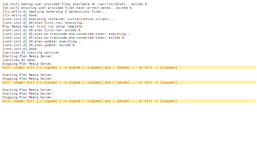

June 30, 20206 yr Author Seems like plex still has the same issue even after creating new docker container. [s6-init] making user provided files available at /var/run/s6/etc...exited 0. [s6-init] ensuring user provided files have correct perms...exited 0. [fix-attrs.d] applying ownership & permissions fixes... [fix-attrs.d] done. [cont-init.d] executing container initialization scripts... [cont-init.d] 40-plex-first-run: executing... Plex Media Server first run setup complete [cont-init.d] 40-plex-first-run: exited 0. [cont-init.d] 45-plex-hw-transcode-and-connected-tuner: executing... [cont-init.d] 45-plex-hw-transcode-and-connected-tuner: exited 0. [cont-init.d] 50-plex-update: executing... [cont-init.d] 50-plex-update: exited 0. [cont-init.d] done. [services.d] starting services Starting Plex Media Server. [services.d] done. Stopping Plex Media Server. kill: usage: kill [-s sigspec | -n signum | -sigspec] pid | jobspec ... or kill -l [sigspec] Starting Plex Media Server. Stopping Plex Media Server. kill: usage: kill [-s sigspec | -n signum | -sigspec] pid | jobspec ... or kill -l [sigspec] Starting Plex Media Server. Stopping Plex Media Server. kill: usage: kill [-s sigspec | -n signum | -sigspec] pid | jobspec ... or kill -l [sigspec] Starting Plex Media Server. Stopping Plex Media Server. kill: usage: kill [-s sigspec | -n signum | -sigspec] pid | jobspec ... or kill -l [sigspec] Starting Plex Media Server. Stopping Plex Media Server. kill: usage: kill [-s sigspec | -n signum | -sigspec] pid | jobspec ... or kill -l [sigspec] [cont-finish.d] executing container finish scripts... [cont-finish.d] done. [s6-finish] waiting for services. s6-svwait: fatal: timed out [s6-finish] sending all processes the TERM signal. [s6-finish] sending all processes the KILL signal and exiting.

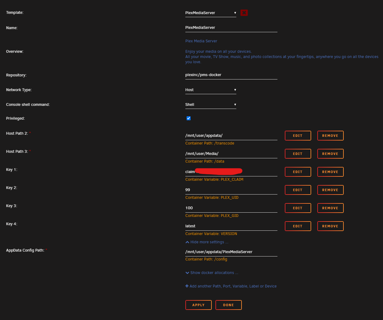

July 1, 20206 yr Author I'm attaching the pics and diagnostics during each stepDiag-AfterEnableDocker.zip Diag-AfterPlexStarted.zip Diag-AfterEnableDocker.zip Diag-BeforeEnableDocker.zip Diag_AfterPlexCrash.zip Edited July 2, 20206 yr by trurl delete docker run because it contained plex token
