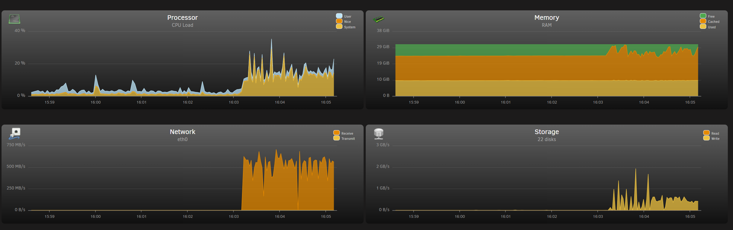

Im have some very inconstant write speeds. When transferring via SMB to a cache drive I get anything from 110MB/s to 2MB/s and hover around 50MB/s. When reading from the array or cache I get about 107MB/s constantly. When I watch the stats it looks like it caches with ram, the once ram fills it basically pauses the transfer, dumps to my cache drives, then starts the transfer again. I have tried transferring without the cache drives and I have basically the same result but with it dumping to the array.
Why isn’t it just writing to the cache drives? They have a 550MB/s read/write so caching to ram seems useless when I can only transfer at gigabyte speeds anyway. Is there a way for the system to not use my ram as data cache?

When you do the transfers on the main page does the write speeds on the cache reflect what you are seeing as well? How big of files are you testing with? The pictures a interesting.
hey thanks for the response. Small update, The problem isn't as bad if a transfer using a windows machine (the above screen shots are from a mac). However, even in windows, It will still do this "cache with ram, the once ram fills it basically pauses the transfer, dumps to my cache drives, then starts the transfer again". If i don't use the cache drives it will transfer at 108MB/s for hours if needed. So it only seems to be a problem if i use cache drives but this behavior makes the purpose of cache drives pointless.
To answer your questions, yes I will see that nothing is writing to the drives in the main page, then it will spike for a few seconds at 130+MB/s while it writes to the cache drives. I have been testing with anything from 10GB to 200GB. I work in media production so i often have large files like this.

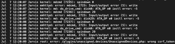

I can say looking at your sys log it's jammed packed full of these errors. It's interesting because I don't see any drives labeled disk29 or disk0.
Jul  6 02:49:28 Jarvis kernel: md: do_drive_cmd: disk29: ATA_OP e0 ioctl error: -5
Jul  6 02:49:29 Jarvis kernel: mdcmd (5077): spindown 0
Jul  6 02:49:29 Jarvis emhttpd: error: mdcmd, 2723: Input/output error (5): write
Jul  6 02:49:29 Jarvis kernel: md: do_drive_cmd: disk0: ATA_OP e0 ioctl error: -5
Jul  6 02:49:29 Jarvis kernel: mdcmd (5078): spindown 29
Jul  6 02:49:29 Jarvis kernel: md: do_drive_cmd: disk29: ATA_OP e0 ioctl error: -5

I tried running the cache drives off of the Mobo, same result. Do you have any idea what could be causing these errors? They seem basically constant. My full DiaLog is posted above.

Disk 0 29 are parity disk, SAS disk not support spindown, you may try set those disks "individual" never spindown .
Thanks! ill change that setting now and see if that at least clears up those errors.

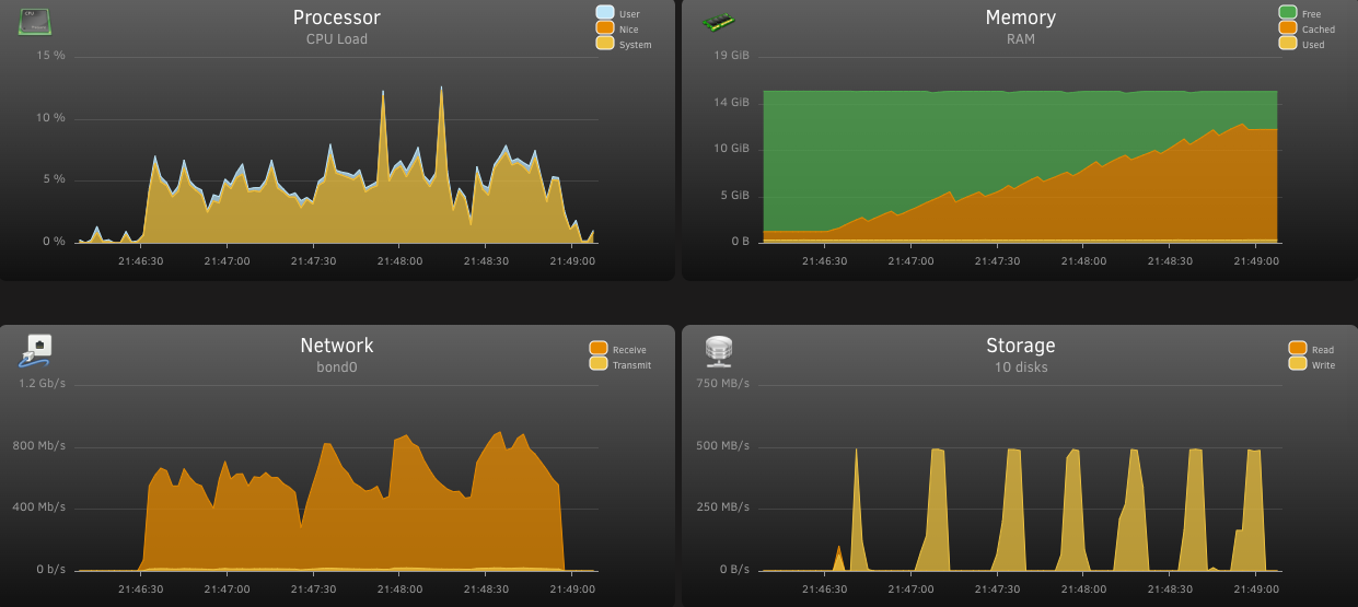

Alright so did my tests.. First question do you have the Dynamix Trim Plugin installed?
If you have it installed make sure its running regularly. If you don't make sure you get that. Second under "settings", "global share settings", "enable direct io". I would personally do the trim first test. Then do the direct io second & test. Below is my results.. The problem I ended up hitting is my nvme started to get to hot and thus throttling. It was at 550megs a second which is pretty good transfer speeds. It did crater twice but that was also when it started throttling down pretty hard.
Thanks! I set those drives to never spin down and that seemed to stop those errors. I also moved my cache drives to the on board Sata ports so now Trim is working. However, I still have the same results. The most recent speeds I am seeing is it will start at 116MB/s for a while until ram is full, then sits around 60-70MB/s.
