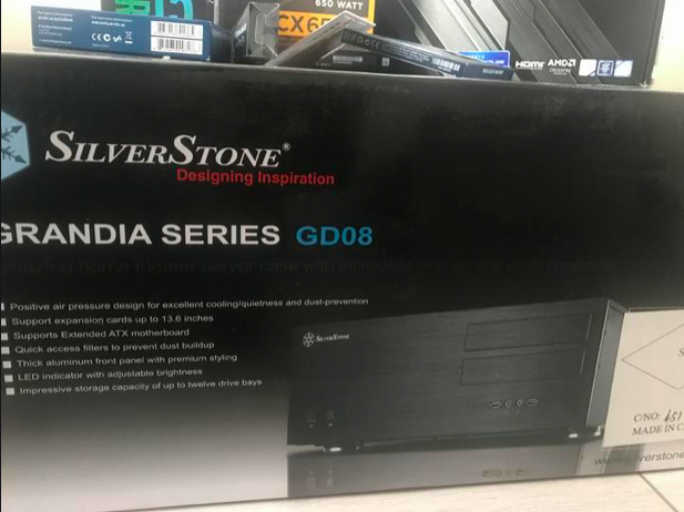

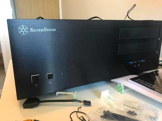

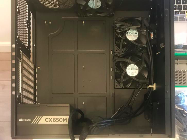

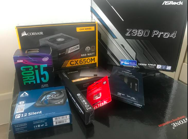

Case: Silverstone ATX GD08B
Fan: 120mm (intake) Arctic P12
Fan: 80mm (exhaust) Arctic F8

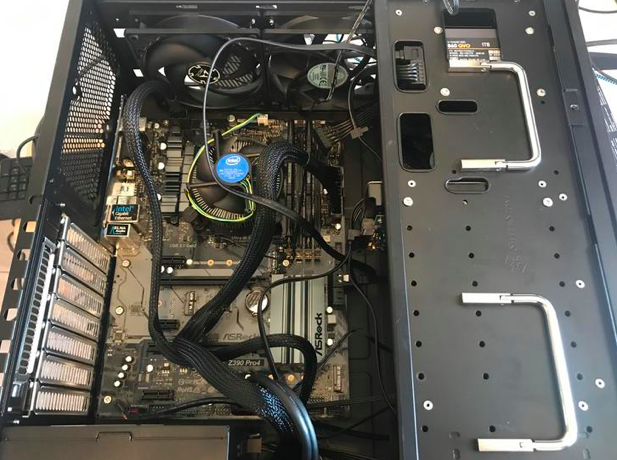

Mobo: ASRock Z390 Pro4
CPU: Intel i5 9400
Heatsink: Stock
GPU: TBC (Onboard until Ebay'd)
RAM: Crucial Ballistix 2*8GB DDR4 2400 MHz
PSU: Antec EA550G Pro 550 Single rail 12V@45 amp
Flash drive (OS): SanDisk Cruzer Fit 16GB USB 2.0
HDD 1 (Cache & VM SSD): Samsung 860 QVO 1TB

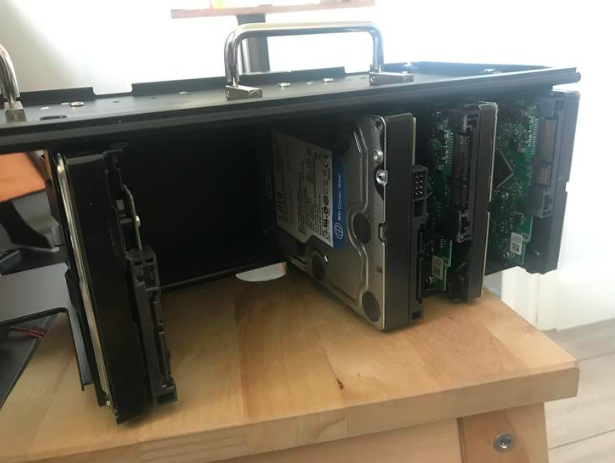

HDD 2: Old Hitachi Deskstar 500GB @ 7200
HDD 3: Old Hitachi Deskstar 500GB @ 7200
HDD 4: Old Western Digital 500GB @ 7200
HDD 5: Old Western Digital 1TB @ 7200
HDD 6 (parity): Old Western Digital 2TB @ 7200
I would expect these old drives to die off so as to make room for denser, more energy efficient ones before I filled them. I figure the PSU should be enough for even the worst case of consumption on the old drives(?).

Using drives that you don't trust to hold data is a very bad idea. Unraid's drive recovery uses all the capacity of all the drives to maintain parity, and when one drive fails, all the remaining drives must be perfect to rebuild the failed drive.
So, be sure to fully test any drive that will be included in the parity array, and discard any that show signs of failure.
Thank you for the word of caution!
I didn’t realise the pool drives were being used like that, I thought all parity data was on the dedicated parity drive so that’s an eye opener 🙃
They will all be put through their paces before being put to use. The important data has both a local and off-site backup I plan to maintain should disaster strike.

Absolutely loving how smoothly everything has gone so far!
All drives pre-cleared and parity build now in progress. Thankfully it is only 1TB parity, so estimated at 3 hours 🙂
