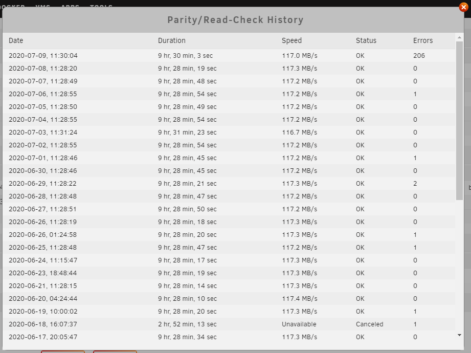

Here is the result of my party checks

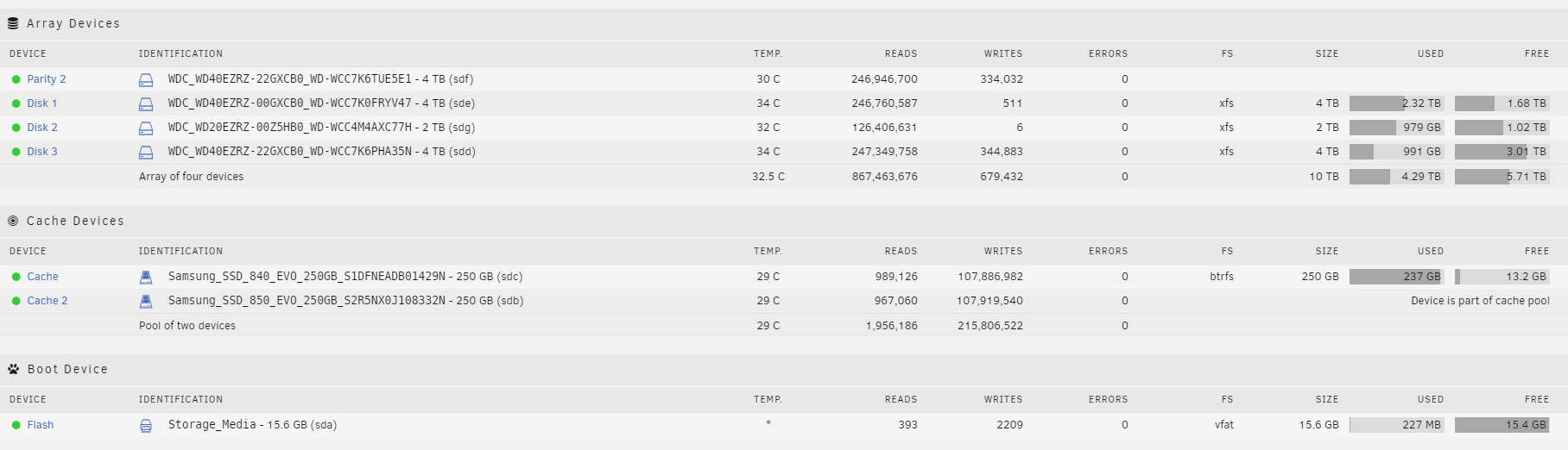

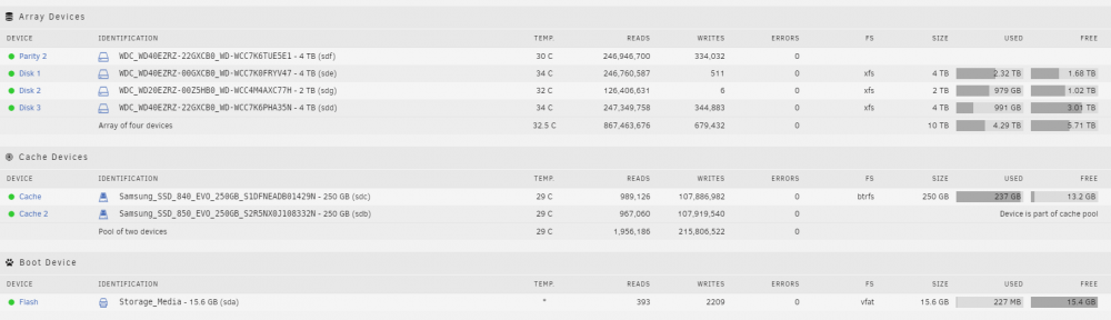

Here is the current status of my disks (system uptime is 15 days, 10 hours):

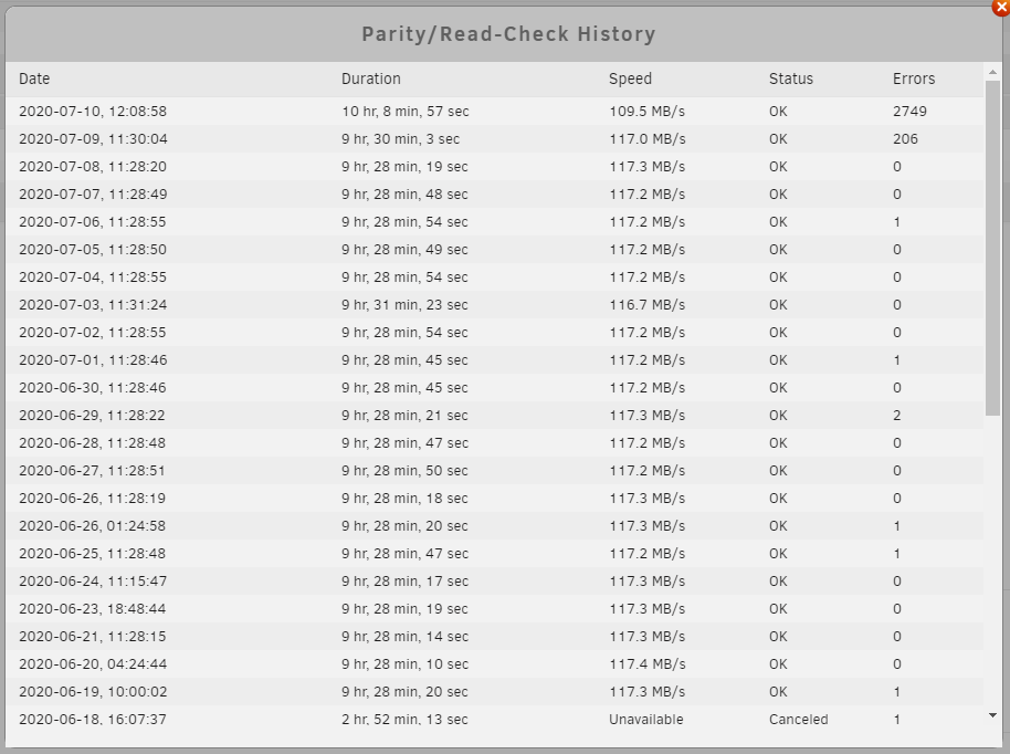

There were 2000+ errors in my latest run:
I have another run going right now. I'm a bit surprised that there were so many sync errors, I've never had this many before. I'm running another non-correcting check now, I will try to post that later today when it finishes.

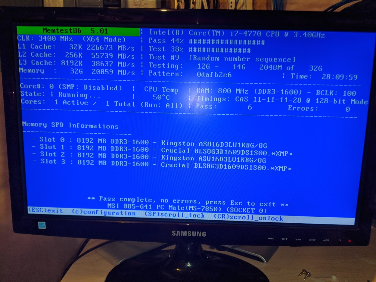

I ran memtest86 for over 24 hours and no issues, its still running now and I will probably keep it running until tomorrow. The only thing left I could think of is maybe swapping out sata cables? Also this is non-ECC ram which I know is not ideal, but this is the second time I've run this test for over 24 hours and never had an issue.
I agree that it would make a lot of sense if it was a ram issue but it seems like memtest can't reproduce the issue, is there anything else I should try before buying new ram?
