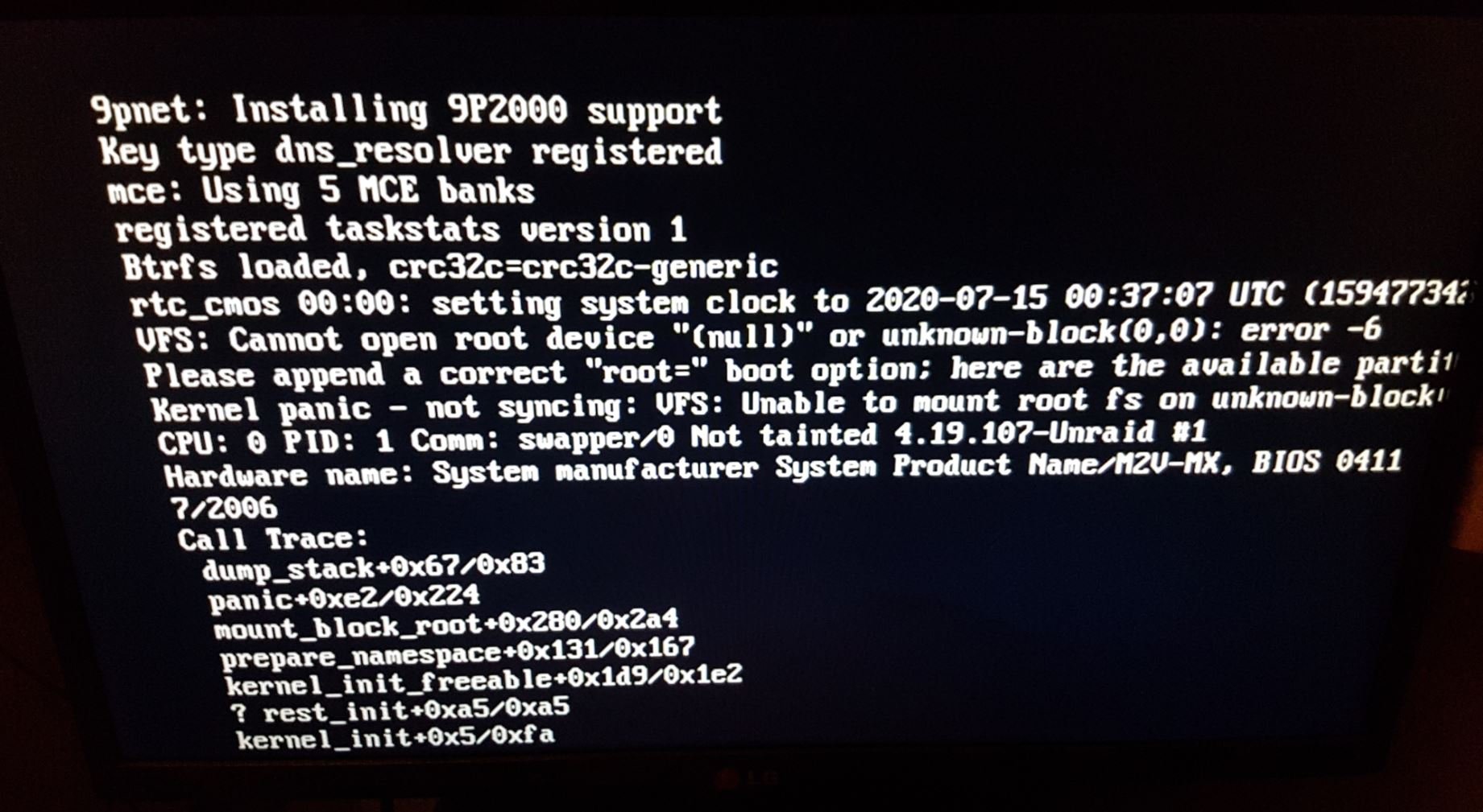

So back to where the boot stalls.  The boot doesn't seem to make it through all the way as I was expecting to be able to login to the web portal. Instead the below text is the lines several lines I see on the screen.
mount_block_root+0x280/0x2a4
prepare_namespace+0x131/0x167
kernel_init_freeable+0x1d9/0x1e2
Is someone able to tell me what I'm missing?

I was able to take a picture of the screen to show where the OS boot stops at

Try adding more RAM, this might also help.
Wow thanks! I added a 512mb stick and now it is running!
If anyone has any clue why this happened, please let the rest of us know especially for people who have a surface/general understanding of unraid (me)

Maybe you were OK on 5x with you specific setup. I think unRAID 6x requires more RAM than the old version you were running.

Still not going to be enough to get the full benefits of V6, and even if you stick strictly to NAS functionality, you may still have some problems, such as upgrading from the GUI.
Probably a valid point.  I now know my setup is limited and will consider in the future what is needed if I need to upgrade.  I'm aware my motherboard is limited to 4 SATA connections and therefore may need to look into a new system or find a decent PCIe controller to add additional ports (preferred approach for now).  But the main thing is that my OS is running with the new version!

Don't even think of using anything except NAS functionality till you get more RAM. If you want to use dockers you should consider 4G to be minimum and more is better. If you want to use VMs then you would need enough RAM to give the VMs what they need plus more for Unraid and dockers to use.
Even with strictly NAS, there are some things that may not work without more RAM, because those things use RAM for temp storage. Upgrading from the webUI will download to RAM before writing the upgrade to flash, and getting Diagnostics will compile those diagnostics in RAM before downloading them. And Diagnostics are very important for letting us troubleshoot.
