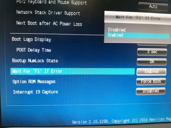

July 20, 20206 yr Community Expert 6 minutes ago, johnnie.black said: look for that option in the BIOS. e.g., this is how it looks on the Asus board I'm working now, but it's not the same on all, some have more advanced options where you can chose on what errors it halts or not, and some might not have any option:

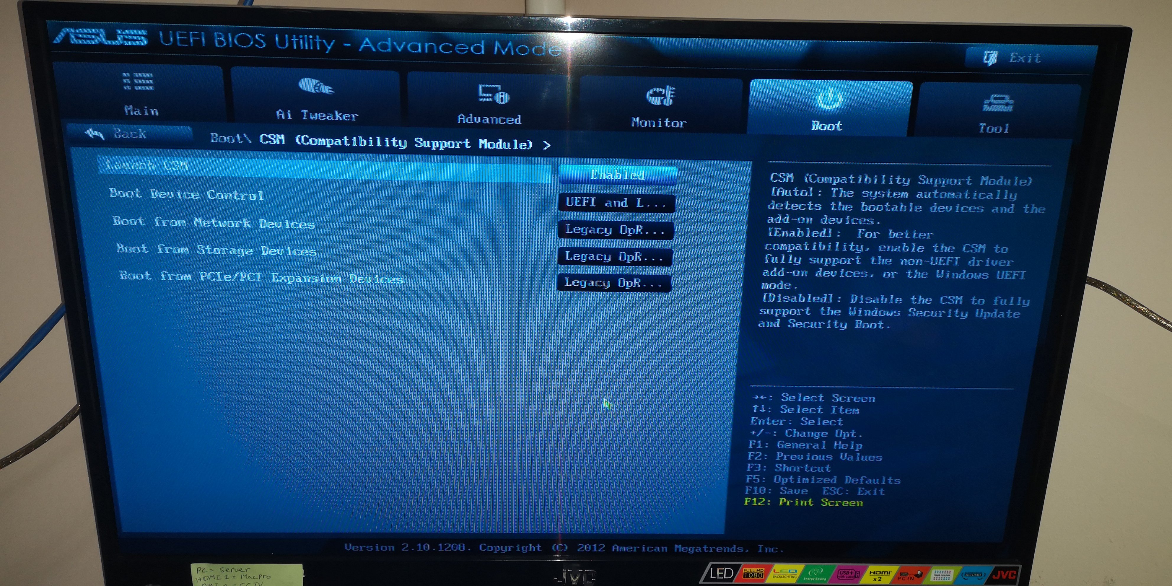

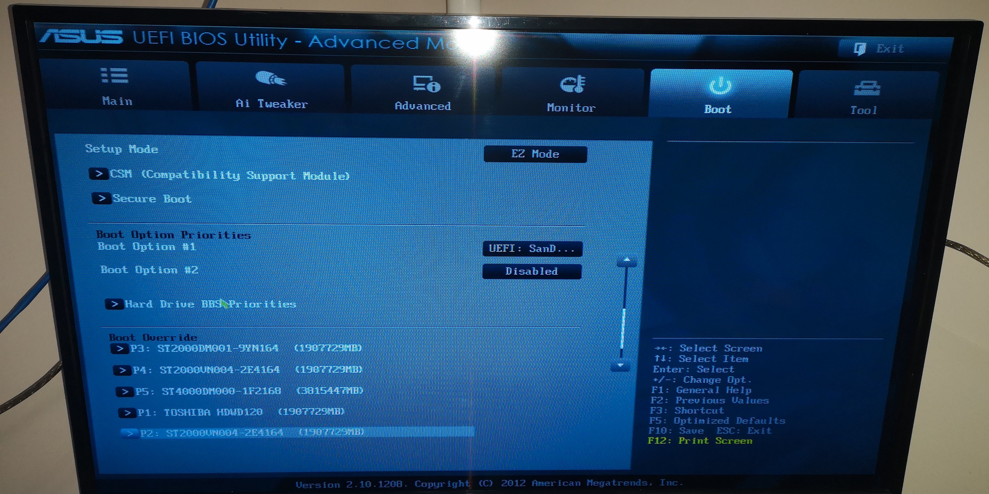

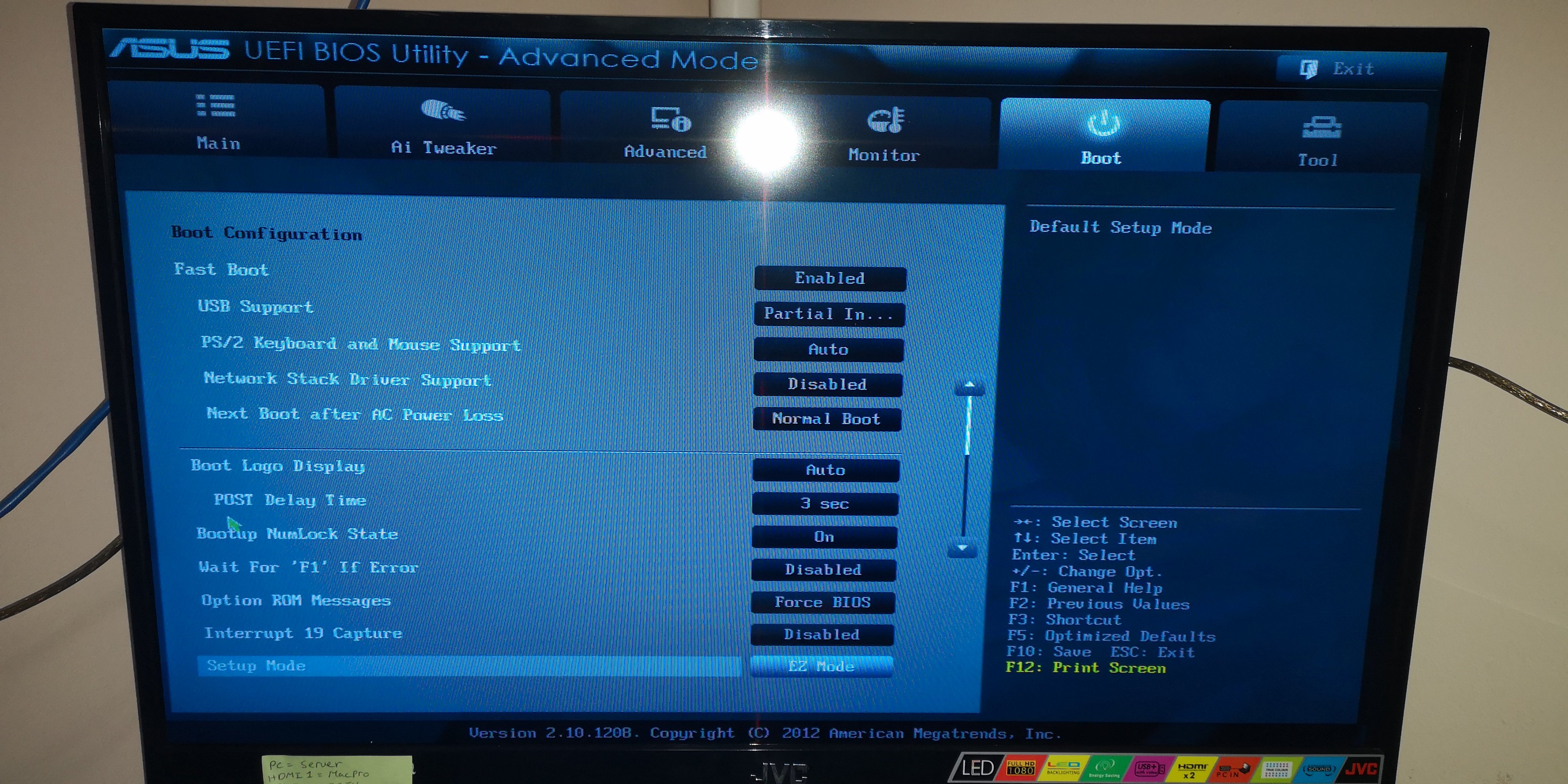

July 20, 20206 yr Author Thanks for your quick responses, my Bios boot options are similar options as the image above. i tried the "wait for F1 if error" before but did it again now just incase. With the function disabled I, powered on again and removed the keyboard, the system does the same when the keyboard is removed, sits and waits for it to show up before booting. Shut it down again and booted up with the keyboard in and get the same black screen. nothing moving forward. Another shutdown with the power button and change usb slots for the thumb and boots to lime technology os. Disabled multiple boot options under 'Launch CSM' (Boot from network, boot from storage, boot from pcie) leaving 'Boot Device Control' on 'UEFI boot only' did not boot into os just black screen. disabled 'Launch CSM' still black screen. Maybe there's something else in the shots attached you can see with likely more BIOS experience than I.
July 21, 20206 yr Community Expert 13 hours ago, Be-Art said: sits and waits for it to show up before booting. That would be a BIOS bug, look for a BIOS update or contact ASUS support, or just get a cheap keyboard and leave it connected. 13 hours ago, Be-Art said: leaving 'Boot Device Control' on 'UEFI boot only' did not boot into os just black screen. Make sure UEFI boot is enable in Unraid, you can easily check by looking at the EFI folder on the flash drive, if it's named EFI- rename to EFI.
