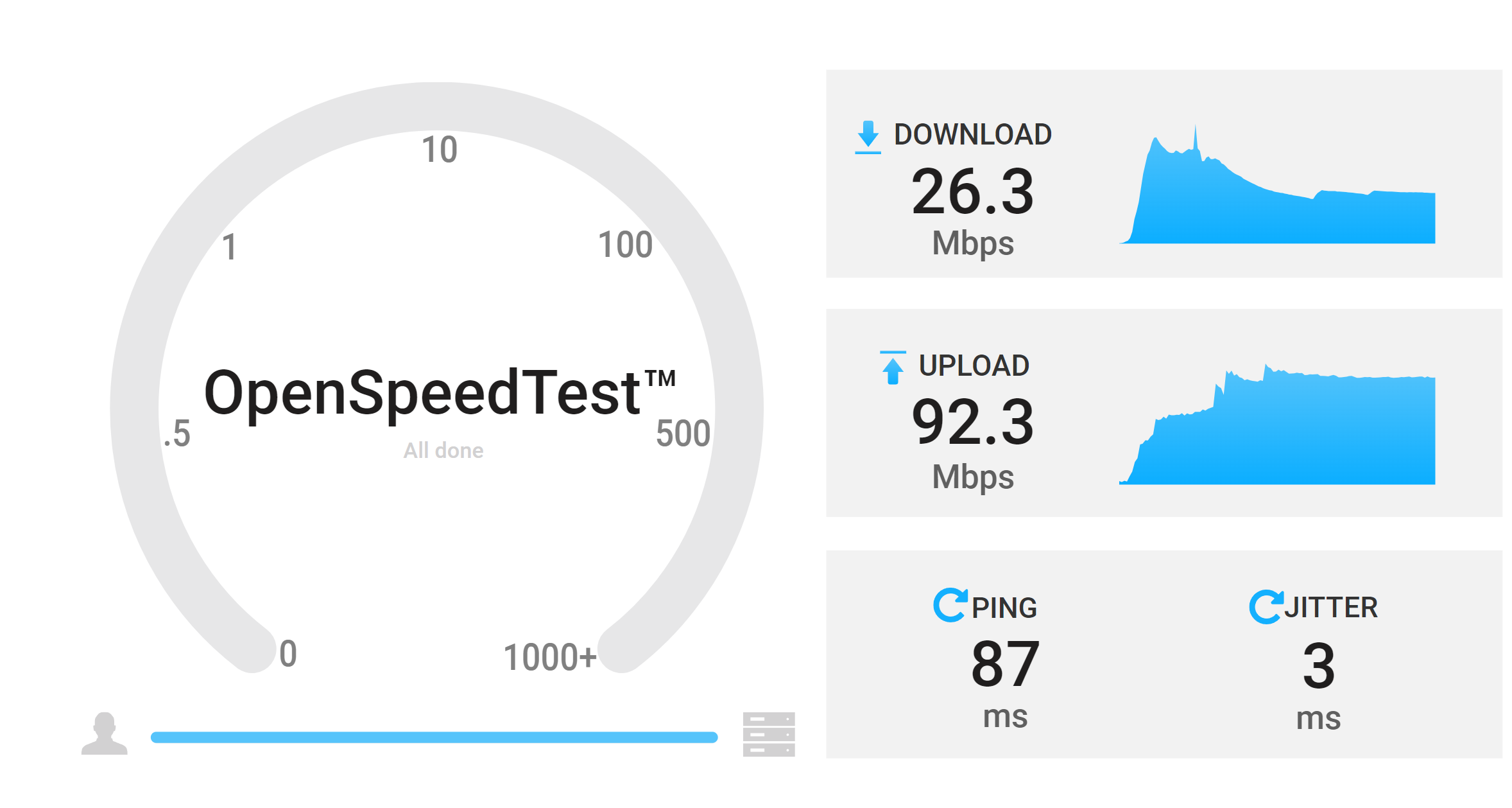

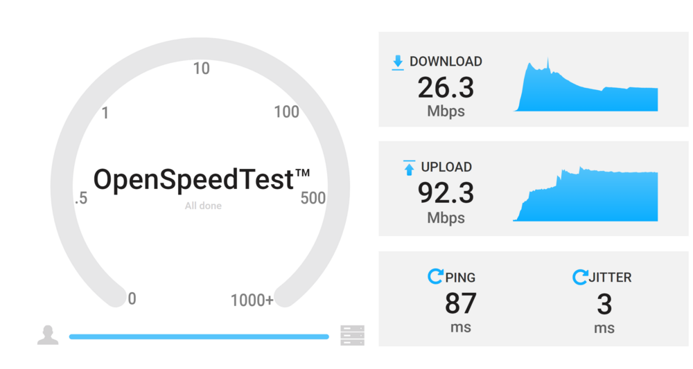

  5. Thanks for the feedback above, Been many months. I have left it and re-visited from time to time. I recently went through this issues with another PCIE card. Then i re-visited the PCIE configurations to try get this working and still no joy. Actually This Open Speed Test report is slower when setting 'active backup' on for the GBE port on the motherboard and the Mellanox running the main link.

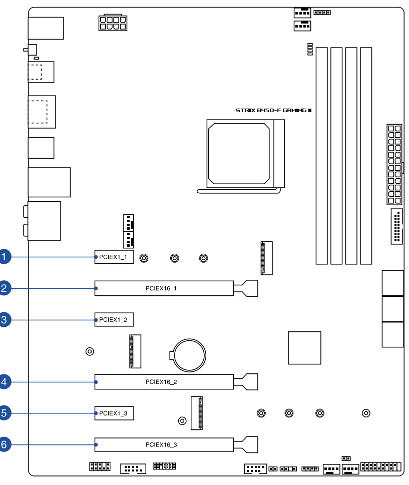

  6. As at last night i have all but two drives in the array present, they should have been present as they run through the same card. I tried alternate PCIE slots and would get this result in X16 slots. Today i removed the NVME M.2 from slot A and second M.2 on a PCIE card into PCIE X1_3. migrated the data to SATA SSD's (docker and vm cache drives) to clear lanes. I dont fully understand lanes and how they function. This seems to be part of the issue, i dont understand why the physical configuration would have changes even after a Bios update.
  7. I have a similar issue and i need help with a unit labeled on ebay as a "SA3120J PCIE Adapter 20 Port 6Gbps PCI-Express X1 to SATA 3.0 Controller Cards U" Has been functioning fine since March 2023. It dropped in fine no special action needed if memory serves. Saturday afternoon the server stopped functioning, was spinning but cannot reach GUI or services, so hard shut down Removed a Mellanox card as its not in service, I dont have a CPU with graphics so i have to put a GPU for Bios access. I try looking through further to other threads on this forum and r/unraid. Eventually i lean into bringing the bios up to date as it was two years behind. After hours of tinkering the Sata controller is in the same x1 pcie slot it has been for the year but wont see the drives that belong in the assigned devices pool. Eventually i discover the card will work in X16 slots but not all the drives, 2 remain missing, i swap them to another port they remain offline. I try run those to another PCIe card and unraid does not boot fully. I tried briefly the SA3120J in another machine with a SSD drive, it did not see the drive. I am did not modify that machine as its a backup unraid server. I am in South Africa, Its not so easy to replace the card in a couple days, I see many people rate the LSI HBA. phantom-diagnostics-20241103-2202.zip

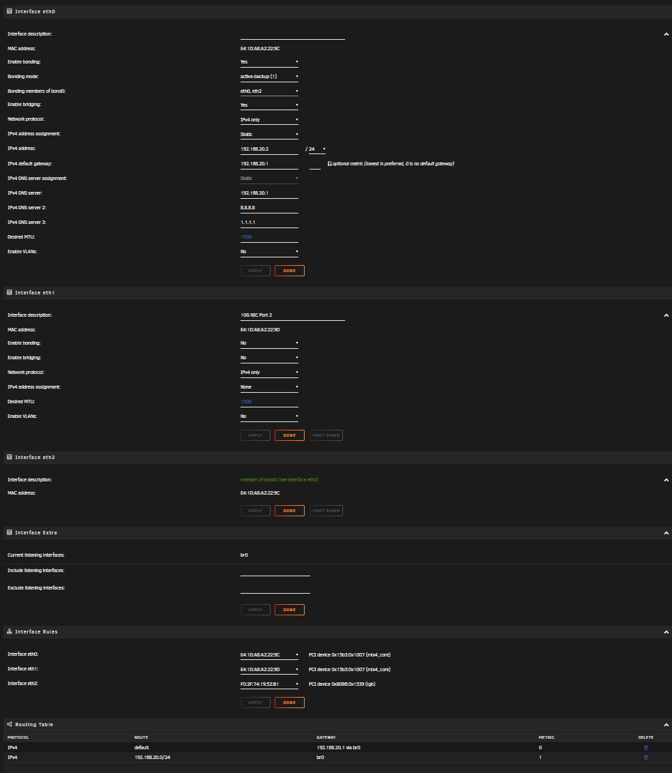

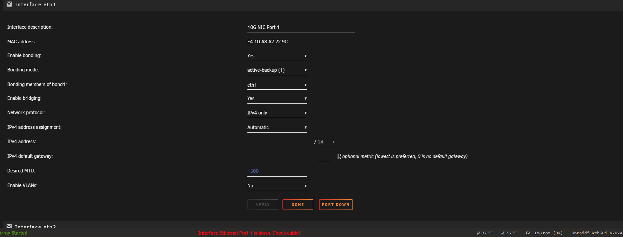

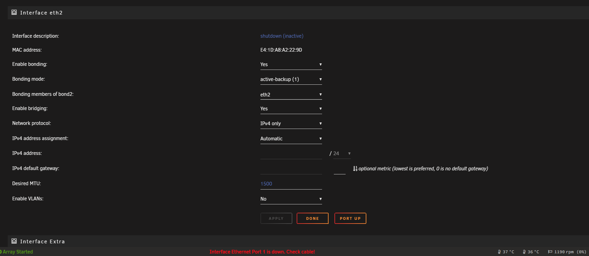

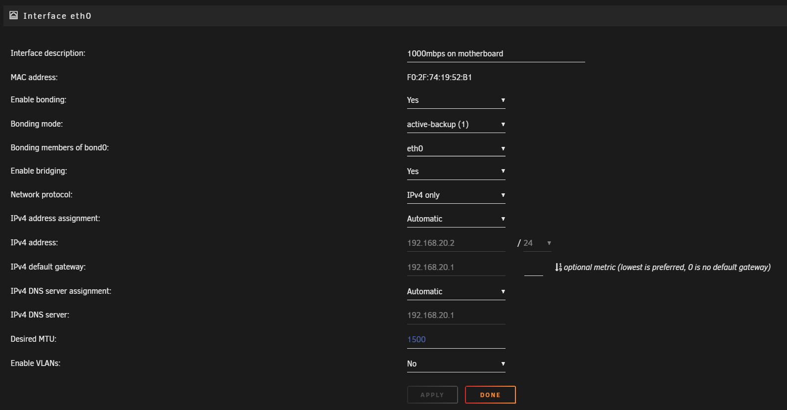

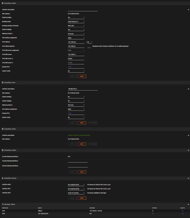

  10. Hey @Cael817, do you mind sharing your config info with me, i am stumped. I have got SFP+ fiber transceivers now because of the check cable statement and still no communication. Greatly appreciated if i could know if there is anything special configured on your eth1 before bonding to eth0.

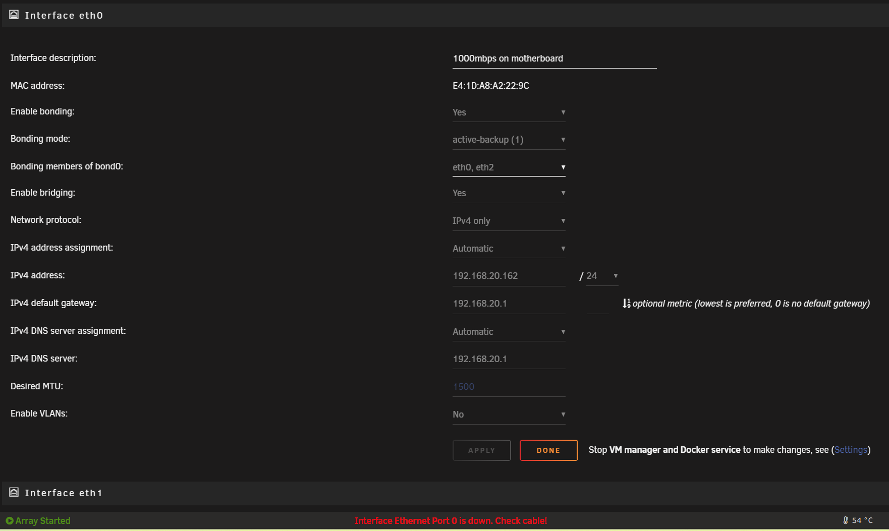

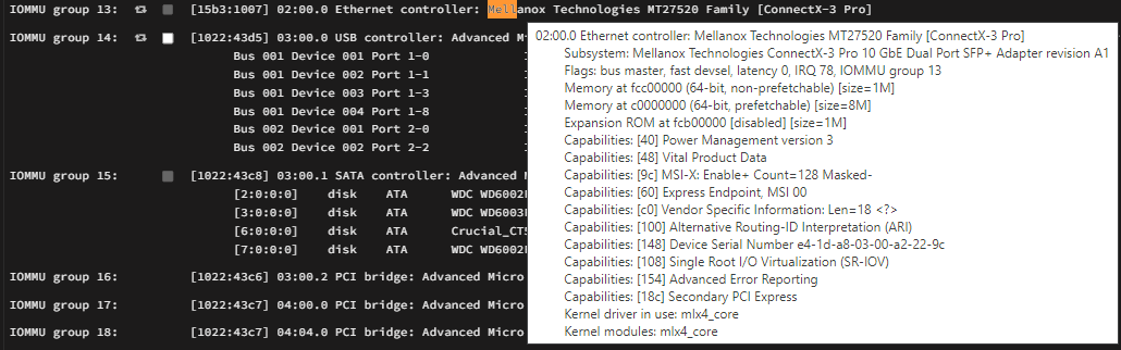

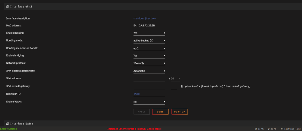

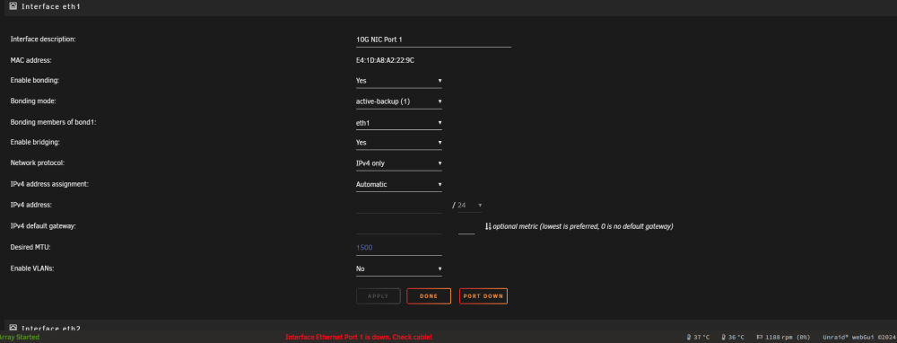

  11. Thanks for the support @Cael817, taking the time to look out the information to help me is very kind of you. Through some experimentation I think you made the 10g port the eth0 using the "Interface Rules" and the 1GBE your eth1. I have replicated making NIC p1 = eth0, NIC p2 = eth1, GBE = eth2. I have bonded eth0 and eth2. eth0 picks up a ip from DHCP on UDM and Unraid is accessible by this DHCP provided address in addition to the static address assigned by the UDM router to the GBE /eth2 port. If i pull eth2 Unraid is inaccessible. In addition i have the warning "interface ethernet port 0 is down. check cable!" I'm still uncertain if it is a config or cable issue. perhaps you could share your config of your eth1. Perhaps there is something i am overlooking with my inexperience with sfp and NIC. EDIT: to include the interface dashboard view. It will alternate on/off eth0.

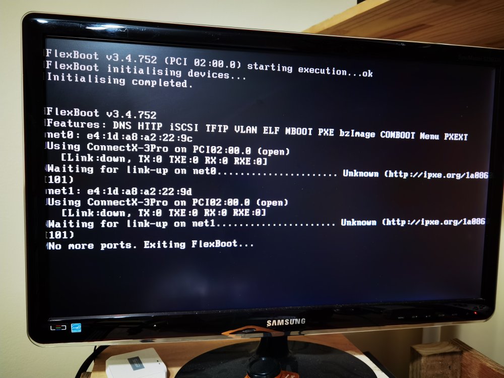

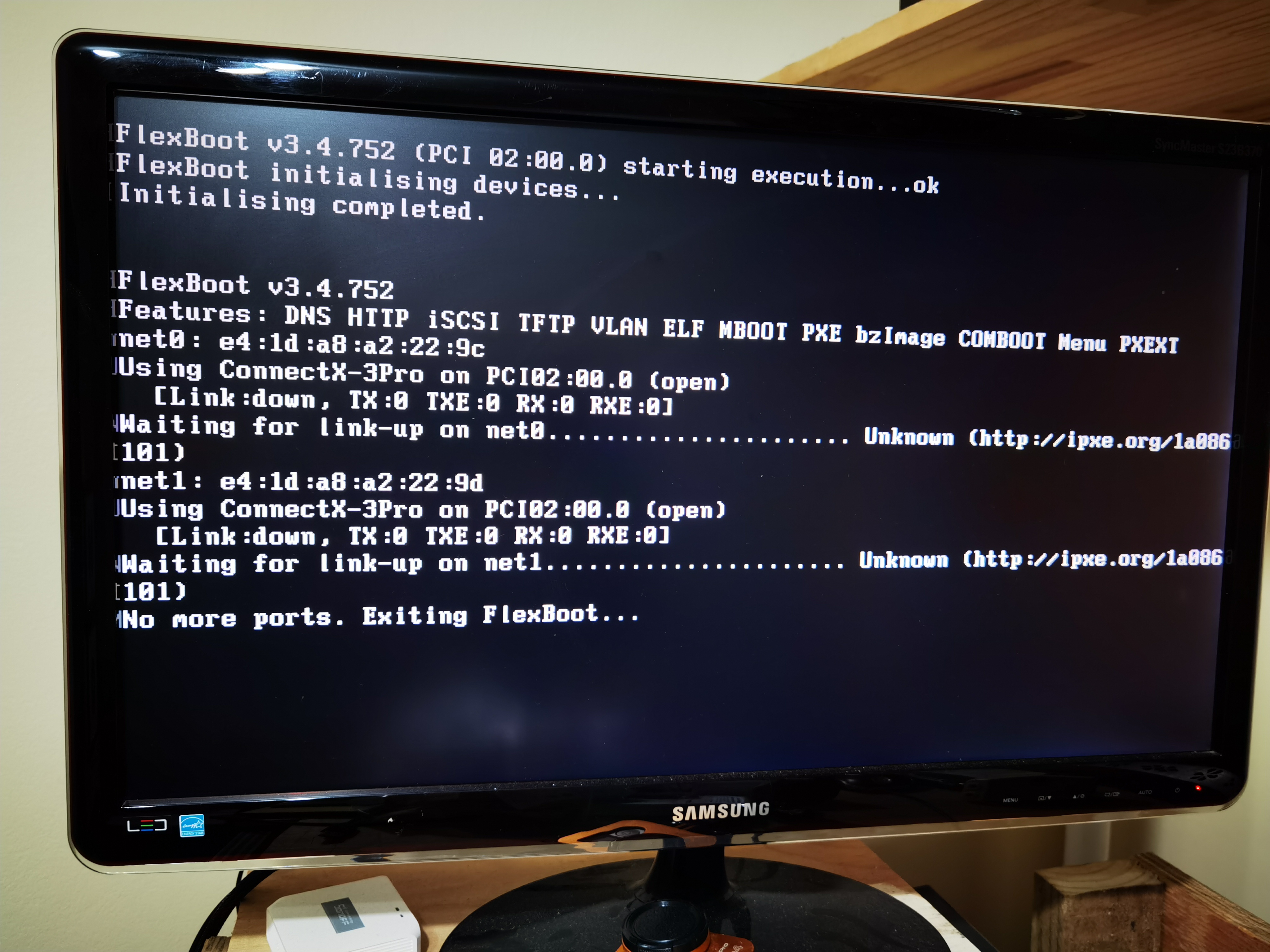

  12. Hey, I am trying to use this same card as above. One SFP+ port on the Mellanox card via Linkbasic Direct Attached Copper 1m 10G SFP+ Uplink Cable to SFP+ port 11 on UDM Pro. The card shows in the unraid network settings setup. However when i try configure the device shows online for a few seconds then drops. eth0 is existing 1000mbps port. I am not sure if this is a configuration thing of hardware is cable or pcie slot. i also had a short lived issue with getting stuck in the flexboot initialisation as the USB was not reading. Port one was connected to the UDM at the start. @Cael817 how did you configure? I have set rules for the port to go to the same vlan as the existing GBE. I have set the SFP to a new ip address manually with ETH1 mac address so when it joins the network it will be at an ip i know. then i can replace it with the existing static one services call to.
