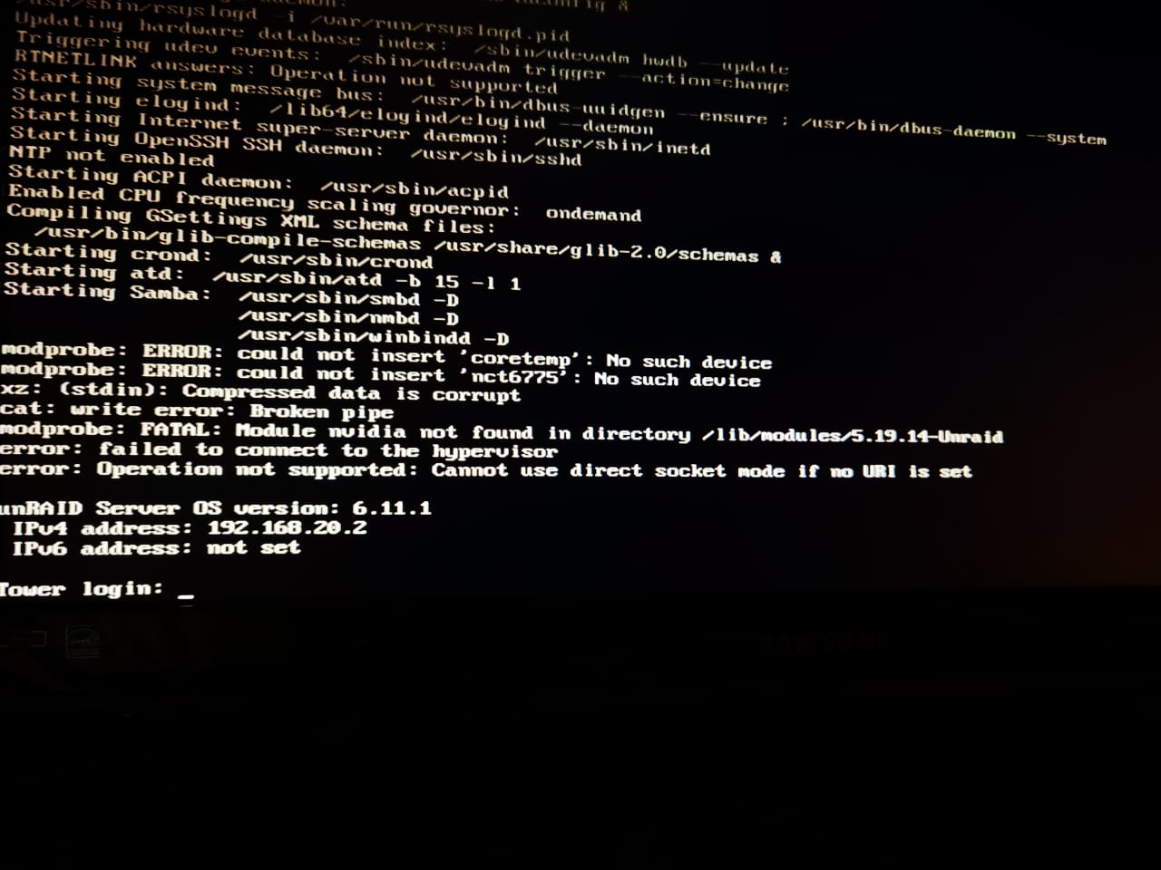

  19. tried the above, now get this issue. Server still auto restarting after this tower login ad os version screen.
  20. I was not busy with nvidia manually. as mentioned above. I needed to add a sata drive and move m.2 from pcie to MOBO. The Nvidia updates are automated to run think at 9am (i am pretty sure) with the rest of the docker updates. The system was shutdown, hardward changes done and booted up again, now cannot access UI. Have removed Nerdpack manually as i noted it stated incompatible on the diagnostics.
  21. I am getting Error: FATAL: Module nvidia not found in directory /lib/modules/5.19.14-unraid Yet on the unraid USB in the path pictured a package exists. I took the server offline, moved an NVME from a pcie to the motherboard m.2 slot and added a hard drive via SATA awaiting preclear. Once this error shows it shuts down and reboots doing the same process the second time.

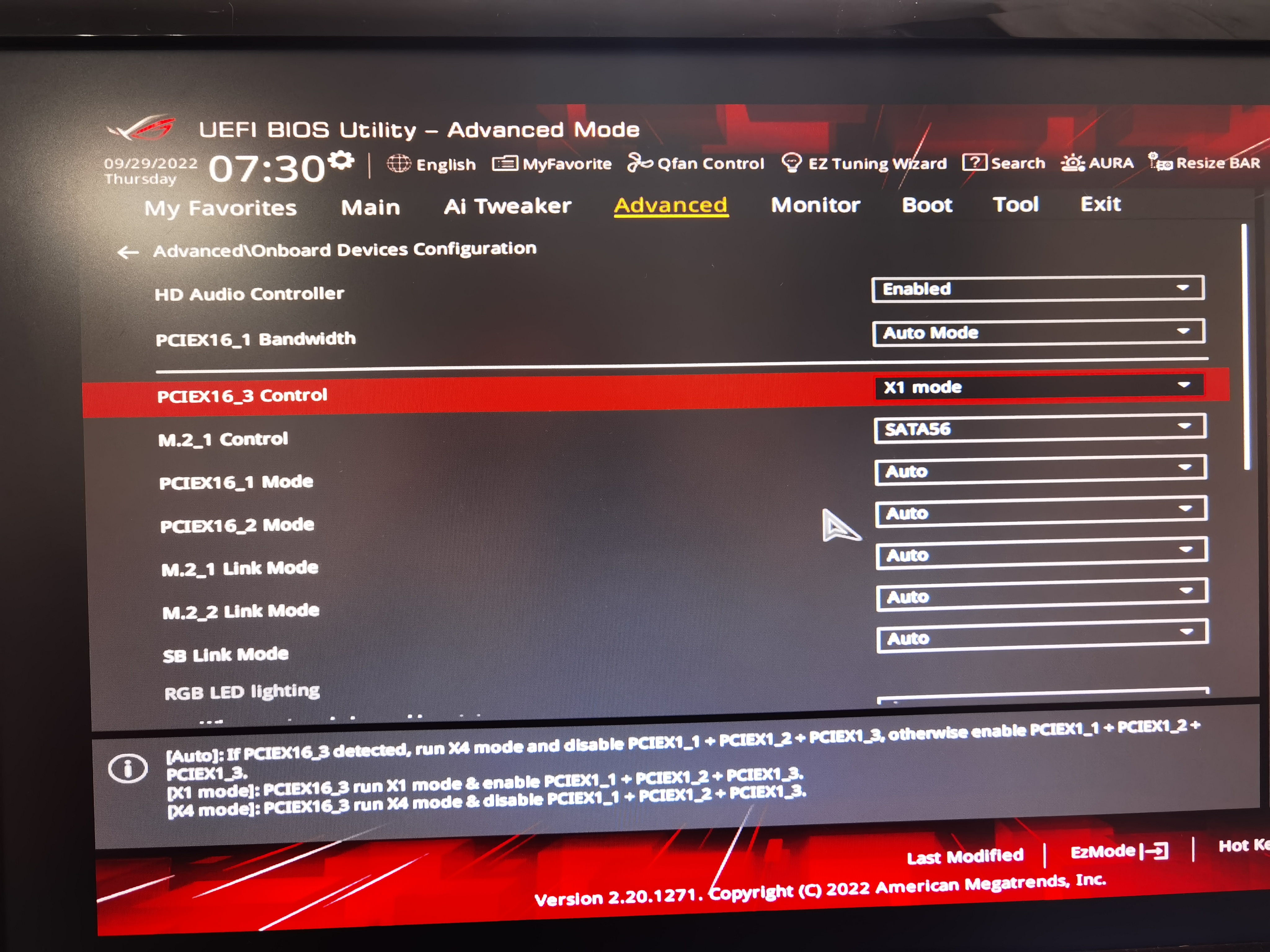

    Solved, for searchability maybe it helps someone else. Motherboard: Rog Strix B450-F Gaming II CPU: Ryzen 5 4500 SATA Ports 5 & 6 turn off when m.2_1 is operating in sata or pcie mode. Solution setM.2_1 to "sata56" My second external SATA controller is a PCIEx1 and the PCIEx16_3 controller needed to be set from Auto to "x1 Mode". See screenshot. still having issues with Ryzen 5 4500 onboard graphics wont output on the HDMI, i want to remove the gpu eventually to conserve power. I do not find an option for graphics in the bios like i did with Intel board. my First ryzen Cpu. EDIT: seems ryzen 5 4500 does not include a CPU graphics, so i have to keep the card.
