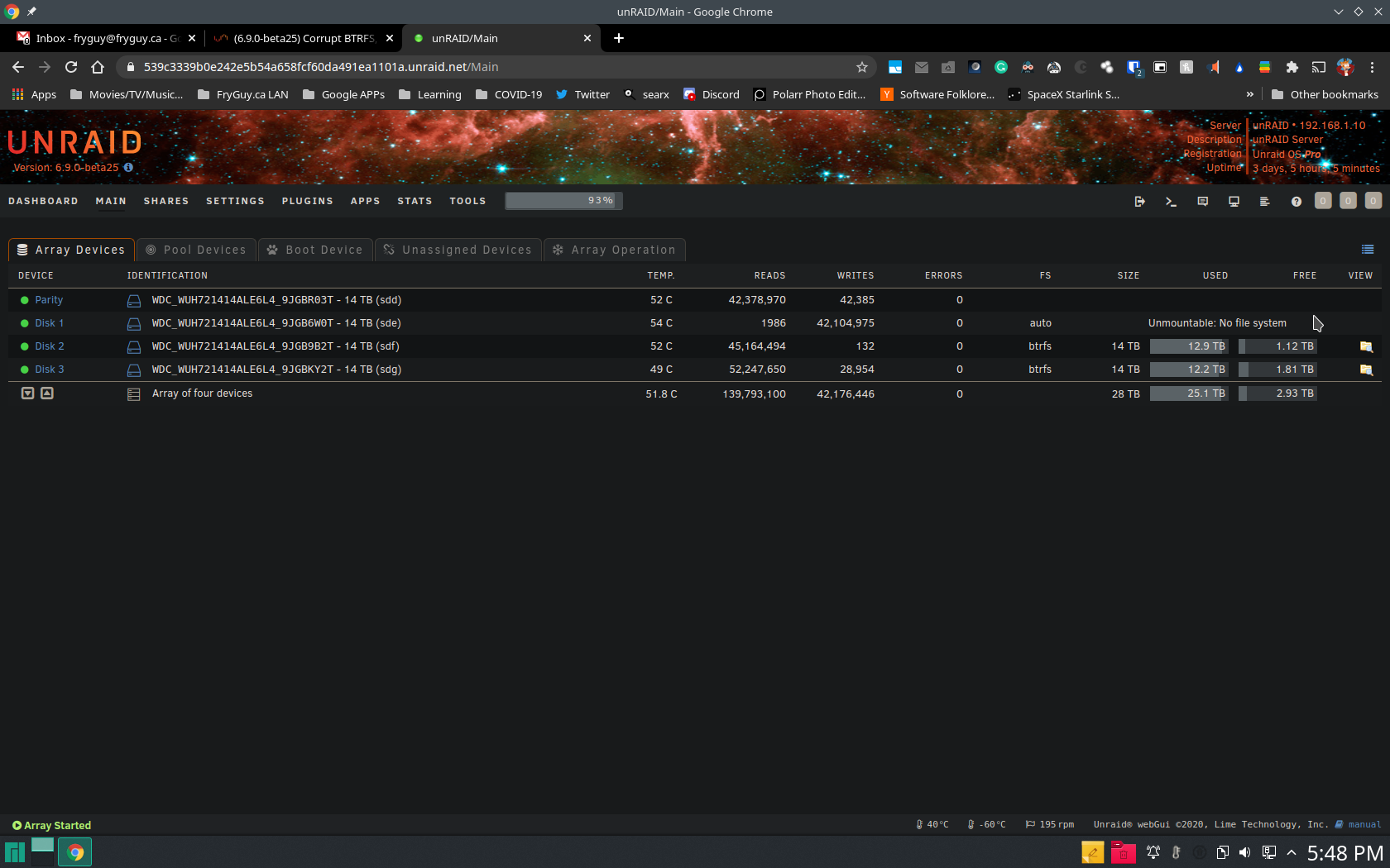

August 1, 20206 yr Community Expert 1 minute ago, FryGuy said: The array will start with the emulated disk and everything is green. This is a bit confusing and makes me question your use of "emulated" again. Maybe a screenshot would clarify.
August 1, 20206 yr Author 4 minutes ago, trurl said: This is a bit confusing and makes me question your use of "emulated" again. Maybe a screenshot would clarify. I don't know what else you would call it when the array is running with the parity "emulating" the missing disk as part of the array. Clear english definition usage of the word to me.
August 1, 20206 yr Community Expert 4 minutes ago, FryGuy said: I don't know what else you would call it when the array is running with the parity "emulating" the missing disk as part of the array. I don't see a missing disk in that screenshot, nor do I see a disabled disk. A missing or disabled disk would not be green, it would have a red X instead. So, parity is not emulating anything. You just have an unmountable disk, which usually means a corrupted filesystem.
August 1, 20206 yr Community Expert I apologize for not asking for diagnostics at the outset. It might have at least helped with communication.
August 1, 20206 yr Author 1 minute ago, trurl said: I don't see a missing disk in that screenshot, nor do I see a disabled disk. A missing or disabled disk would not be green, it would have a red X instead. So, parity is not emulating anything. You just have an unmountable disk, which usually means a corrupted filesystem. Ok that confirms my worst fears, hard to visually check and confirm every file/dir with such a large pool. That's exactly why I didn't want to start anything up and mess up my cache and database. Looks like it's going to be disaster recovery after all. I tested with UFS Explorer it looks like it will recover everything. Do you know of any other free BTRFS recovery tools (or i'll just web search)? It doesn't preserve dir structure but at least i'll get my files back from that corrupt backup. Thank you, terminology confusion and all.
