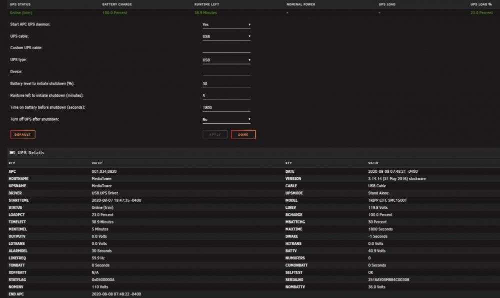

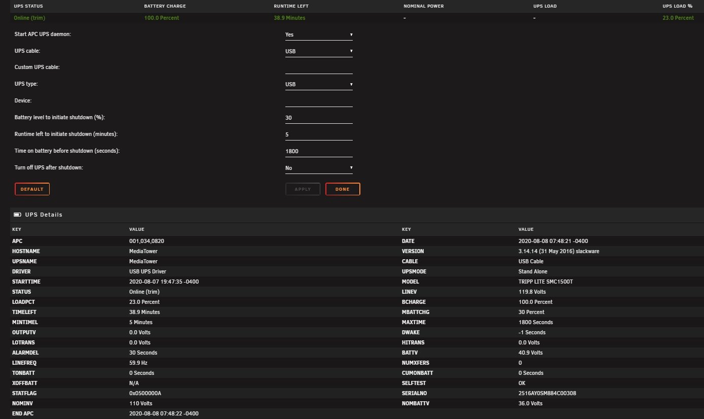

It shows a 38 Minute run time with a 23% Load.  Here are my ups parameters:

1 hour ago, a12vman said:
Battery charge dropped from 100% to 90% in that 30 second period as reported by unraid.
Basically, this says that the battery will be completely discharged in 300 seconds (5 Minutes).  You have the 'Runtime left...' set to five minutes, so that is probably where the problem is.  Remember that when you start the shutdown, the load spikes for a second or so when all of the drives spin up.  (It will then settle back down to a steady state value.)  It could be that the firmware in the UPS senses that spike and starts the shutdown based on that spike.
Second possibility.  Even if you replaced the battery, many UPS require that you have to run a special routine to recalibrate the battery sensing parameters.    (There is no way for the UPS to know that it has a new battery otherwise...)
EDIT:
Third possibility.  You got a bad battery.  Test by hooking a load to the UPS (Light bulbs are good) and see how long it takes to discharge the battery.  You should be able to find a chart on the UPS manufacturer's website for a runtime vs load chart.
Edited by Frank1940
Actually I think it is the 1800 seconds (time on battery before shutdown) which equals 30 mins. Mine is left at 0 and relies on the battery level and runtime of 10 minutes.
I also think @Frank1940 is correct that there is a routine to follow to re-initiate the battery.

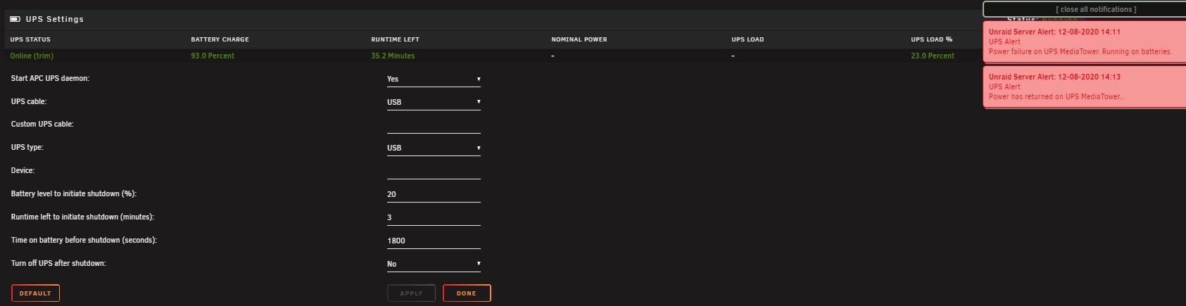

I set the Runtime Left to Initiate Shutdown to 0 and applied changes.
Flipped the breaker off and went right into shutdown again.
Aug  8 13:05:33 MediaTower apcupsd[26612]: Power failure.
Aug  8 13:05:39 MediaTower apcupsd[26612]: Running on UPS batteries.
Aug  8 13:05:50 MediaTower apcupsd[26612]: Battery power exhausted.
Aug  8 13:05:50 MediaTower apcupsd[26612]: Initiating system shutdown!
Aug  8 13:05:50 MediaTower apcupsd[26612]: User logins prohibited
Aug  8 13:05:51 MediaTower root: /usr/local/sbin/powerdown has been deprecated
Aug  8 13:05:51 MediaTower init: Switching to runlevel: 0
Aug  8 13:05:51 MediaTower init: Trying to re-exec init

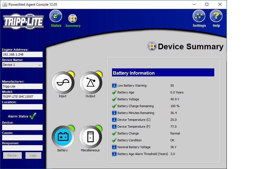

I installed the TrippLite Mgmt software on my laptop. everything looks good from what it is reporting on batteries. My next step is to do a manual load test on these batteries and see if they can deliver.

I hope this is the last time I have to post about my UPS.  I adjusted the 3 settings slightly.  Left both PSU's pugged into the UPS and have tested multiple times with the breaker shutoff for varying durations.  It is switching back and forth without causing a shutdown. Thanks for everyone's suggestions.
