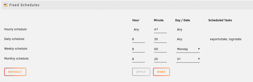

August 17, 20206 yr I know I must be missing the obvious, but how do I change the time when the array health report test is run? mine currently is every monday morning at 12:20am, and it's annoying as hell as I get a text message at that time. I have my phone programmed to sound on texts from specific senders, regardless of the do-not-disturb setting, in case of trouble.
August 17, 20206 yr You can find this in the Settings, the Scheduler is in the User Preferences section.

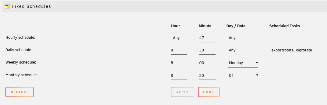

August 18, 20206 yr Author (note I did just change the weekly from 8:20 to 8:00. I'll be curious to see if the text comes in earlier than normal.) If you mean this, it apparently doesn't respect my settings for weekly, or it doesn't respect my time zone. I'm UTC -05:00 right now. I'm getting a text at 12:20am right now, and expecting it to be 12:00 next monday morning.
August 18, 20206 yr Oh, re-reading your initial post, I realise that my answer was not so accurate. Regarding your timing issues, did you adjusted the Time settings (also in settings) ? I do have it set correctly for UTC+1 and the events seem to start a the appropriate time.
August 18, 20206 yr Author If you mean 'Date and Time', yes they're correct for my UTC location as well as the actual time.
August 25, 20205 yr Author So the answer is, nothing I've changed did squat. 12:20am monday morning I got a text. If anyone has any ideas how to change what time the array health report is run, I'd appreciate it.
September 15, 20205 yr Author *bump* still getting the same message at the same time, and I can't find a way to change it. next step is to try and change the time zone on sunday, to see if it happens later, or earlier. I can't believe no one knows where this setting is.
