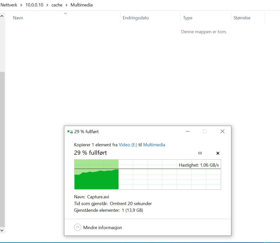

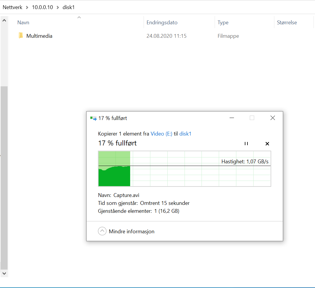

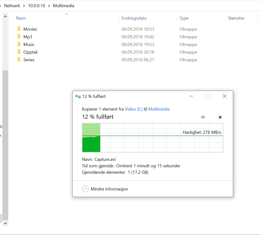

August 24, 20206 yr Author Thx for your reply. Unfortunately I've already activated Direct IO, with no better outcome. I've tried serveral different disks (from nvme, SAS, SSD and SATA) as cache disk, but with the same performance. Is seems like it's not using the cache drive correctly when writing to shared folder. Since I get better speed when writing directly to cache, than writing to shared folder through cache. 1.PNG - Shows copy directly to cache 2.PNG - Shows copy to sharefolder 3.PNG - Shows copy directly to disk1

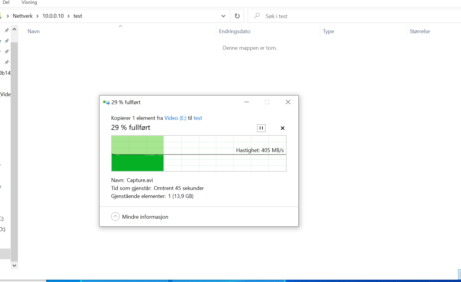

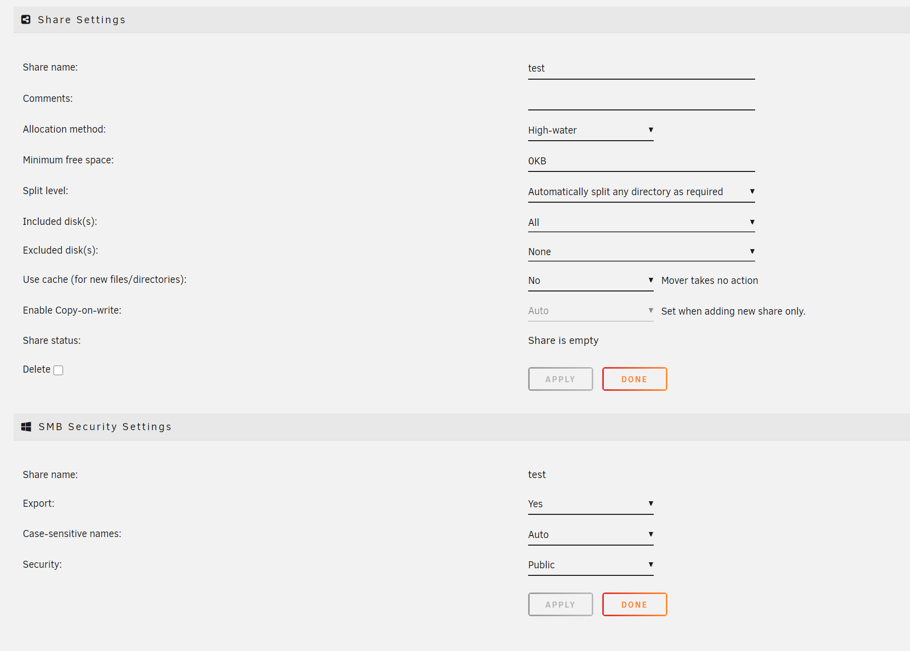

August 31, 20206 yr Author I'm talking MegaBytes (MB) Hmmm, let med post you some pics then. Pictures 1-3 is copy to share Test, without cache drive, on a 10Gb/s ethernet. As you can se on pic2, you'll see that I've disabled writing to cache. If enable cache on the share Test, I get lower speed.
August 31, 20206 yr Community Expert Are you sure that isn't just the RAM buffer? Does it stay at that speed all the way to the end of a very large file? How much RAM does your server have?
August 31, 20206 yr Author 64Gigs of RAM And that was a 20GB file. But still not the same same, as I have on another system, with cache and 10Gbe Edited August 31, 20206 yr by j44rs4

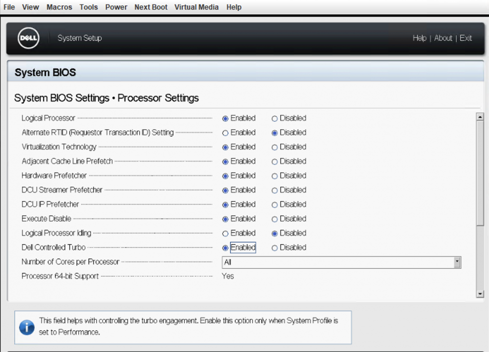

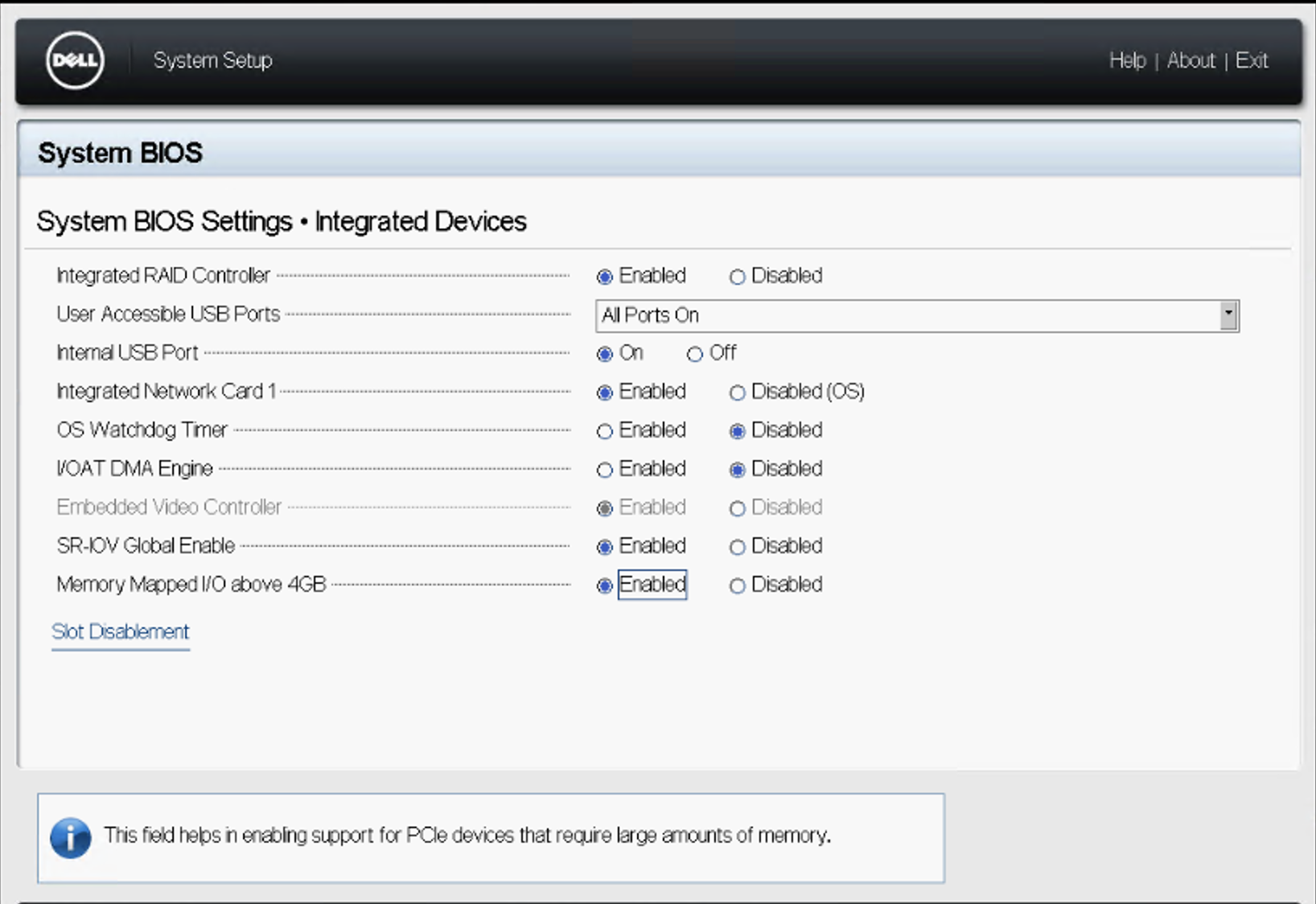

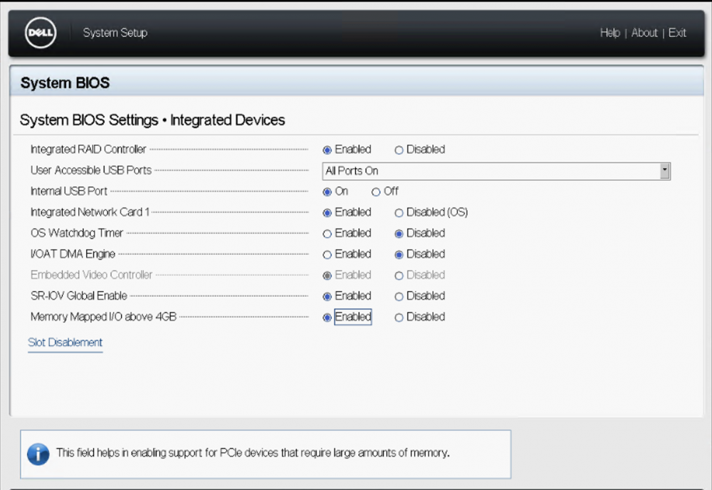

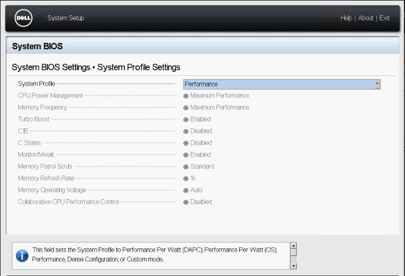

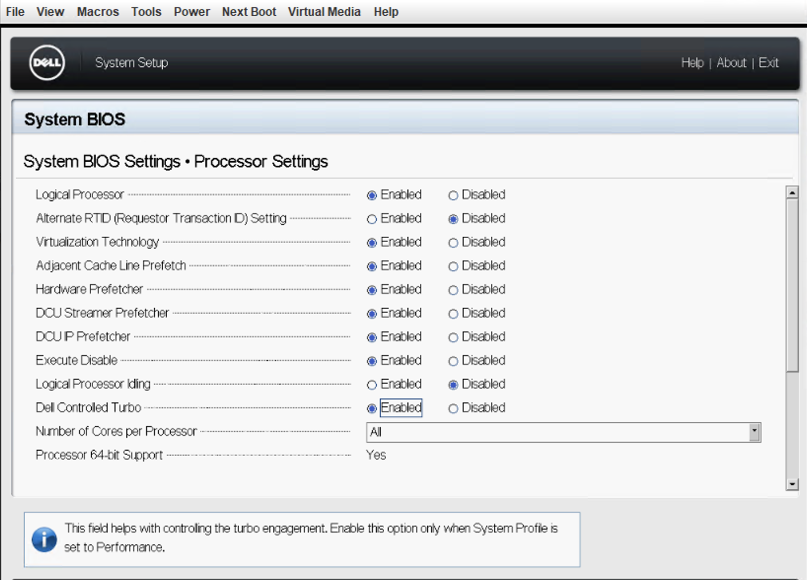

December 9, 20205 yr Author UPDATE. After many ways of testing, I figured out that none of the suggestions mentioned in this thread had any impact on the system. I also tried out with a Perc H730, to see if that could make any difference, since it has a PCIe 3.0 bus confirmed by DELL, and do support 12Gb/s bandwith. The test turned out to have no impact. Did some more testing, and reset my BIOS to FACTORY settings, and still nothing. Solution: Made some minor changes in Bios, as you can see from posted pics. 1. Changed the System BIOS Settings -> System Profile Settings -> Performance 2. Changed the System BIOS Settings -> Processor Settings -> Dell Controlled Turbo - ENABLED 3. Changed the System BIOS Settings -> Integrated Devices -> Memory Mapped I/O above 4GB - ENABLED Setting number 3. made the biggest impact.
