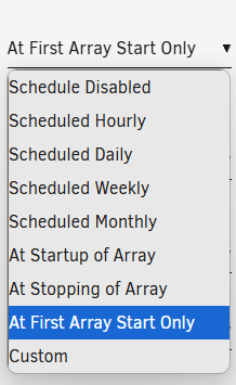

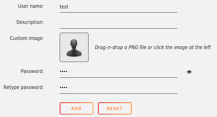

  3. DISCLAIMER: There are some commands that can lead to loss of data if misspelled or if you don't know what they perform. Please read the guide first, berfore tempting to make any changes, and make sure you understand the consequences of making changes to your system. I take no responsibility for others system. You make your own decisions. Since upgrading to UR 7.0 broke the well known ProFTPD, I decided to try and give you a simple guide on how to configure VSFTPD. As some of you know, VSFTPD come as a built-in service in Unraid, but many find it hard to setup. One of the main reasons, are due to reset of the config and the service on the next restart of UR. Bare in mind, that there might be some configuration faults in the vsftpd.conf file, so please guide me if there is something wrong. This have worked for my setup, so there might be other configs you rather prefere. Lets get started. The first thing you need to do, is setup a user account in Unraids "Users" settings. There are many guides on the net, on how to create this. I decided to create some Test-users (test, test1, test2), but you can use whatever name you want. It is not necessary to give the user any share rights, but it will be usefull if you want the user to be able to map shares locally in your network. | You also need to create a share to allow FTP into. Mine says FTP, and contains no files. Next, start the Terminal windows in your upper right corner of UR, and type the following. nano /boot/config/vsftpd.conf This will open an linux editor. Paste the following lines into the editor. # vsftpd.conf for unRAID # with suggestions from forum user 'nars' # connect_from_port_20=YES write_enable=YES chroot_local_user=YES allow_writeable_chroot=YES local_root=/mnt/user/FTP local_umask=0 # # No anonymous logins anonymous_enable=NO # # Allow only local vsftpd.user_list users to log in. local_enable=YES userlist_enable=YES userlist_deny=NO userlist_file=/boot/config/vsftpd.user_list check_shell=NO # # Logging to syslog syslog_enable=YES log_ftp_protocol=NO xferlog_enable=NO # # Misc. dirmessage_enable=NO ls_recurse_enable=YES listen=NO seccomp_sandbox=NO # # Enable PASSIVE mode pasv_enable=Yes pasv_min_port=60000 pasv_max_port=65535 To exit the editor simply press the key comination of CTRL and X. You will be asked to "Save modified buffer?", press Y, and next hit ENTER when asked "File Name to Write:" You have now created a general config for use with VSFTPD, with some extra parameters. # To jail the user to specific folder chroot_local_user=YES allow_writeable_chroot=YES # You might want to change this setting into your share folder. Mine share folder is FTP, see pic. above. local_root=/mnt/user/FTP # Prevent the user from seeing and accessing shares higher up in the tree. ls_recurse_enable=NO # Enable PASSIVE mode, is usefull behind router/firewalls, and need to open ports. pasv_enable=Yes pasv_min_port=60000 pasv_max_port=65535 Now open up Apps in your UR menu and search for User scripts, and install it. The reason why I choose this plugins instead of writing everything into /boot/config/go file, is to simplify the configuration of users accessing the FTP-server, and to do some other tweaks i.e. add some share folders. Start the plugin, and chose "ADD NEW SCRIPT" and give it a name, then paste the following lines into the editor, and save. cp /boot/config/vsftpd.conf /etc/vsftpd.conf /usr/local/emhttp/plugins/dynamix/scripts/ftpusers '1' 'test test1 test2' Explaining the config: # This line copies the newly created config file, and replaces the original in /etc/vsftpd.conf. Don't worry, this will make no harm to the original config file, as it resets when you reboot your server cp /boot/config/vsftpd.conf /etc/vsftpd.conf # This line enables the service, and allow the users test, test1 and test2 to access the FTP-server. /usr/local/emhttp/plugins/dynamix/scripts/ftpusers '1' 'test test1 test2' Notice that if you have other users, just name them in this config, with spaces for each user. Also rememer that these users will have to be added in your UR USERS configuration mentioned above. To autostart the service at every restart, just click on the dropdown menu on the right side of your script, and choose "At First Array Start Only" Now you have a working FTP-server with no shares, other than an empty folder. To add shares into your FTP-Server, you can either edit your newly created script in the "User Scripts" app, or you can create a new one. I choose the last option. "ADD NEW SCRIPT" and give it a name, then paste the following lines into the editor, and save. mkdir /mnt/user/FTP/Movies mount --bind /mnt/user/multimedia/Movies/ /mnt/user/FTP/Movies mount -o bind,remount,ro /mnt/user/FTP/Movies/ Explaining the config: # mkdir creates a new folder in my FTP share, where I can mount my shared folder Movies mkdir /mnt/user/FTP/Movies # mount command binds my shared folder /mnt/user/FTP/Movies to the newly created folder on my FTP-share. mount --bind /mnt/user/multimedia/Movies/ /mnt/user/FTP/Movies # another mount command to make my shared folder /mnt/user/FTP/Movies READ ONLY on my FTP-share. mount -o bind,remount,ro /mnt/user/FTP/Movies/ If you want to autostart the share, just follow the method mentioned above. By using this plugin, you can add as many shares from your UR to your FTP-server as you like, and it's way easier to do than editing the /boot/config/go file every time. To unmount the share just make a new script and add the lines. umount /mnt/user/FTP/Movies rmdir /mnt/user/FTP/Movies I think the config explains it self. That's it, and I hope this guide can be usefull for some UR members.

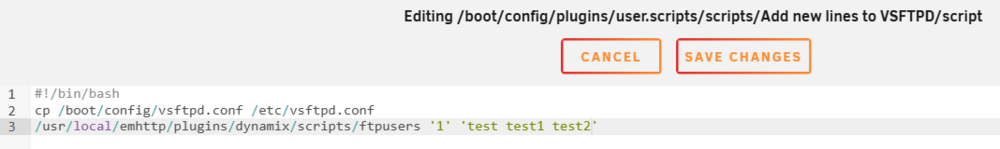

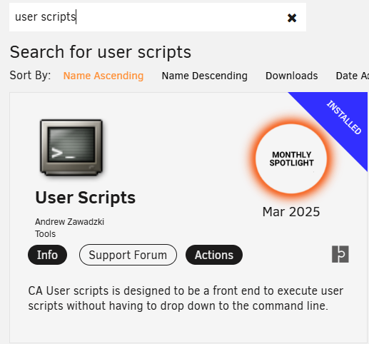

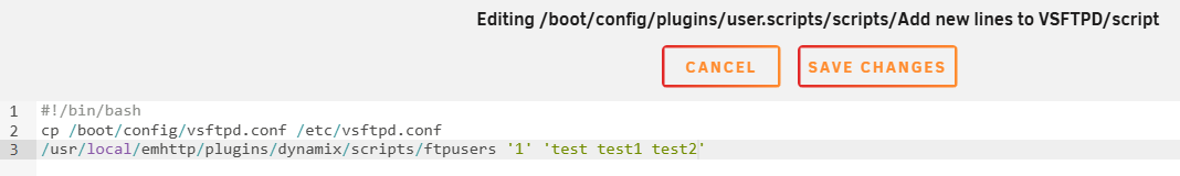

  5. @Binary100100 You could make a vsftpd.conf file in the /boot/config folder with your correct settings. Change the chmod to 644 just in case. chmod 644 /boot/config/vsftpd.conf --------------------------------------------------------------------------------------------- Start the plugin "User Scripts" and make a new script. Add the following lines. #!/bin/bash cp /boot/config/vsftpd.conf /etc/vsftpd.conf /usr/local/emhttp/plugins/dynamix/scripts/ftpusers '1' 'test test1 test2' This will copy your correct config file from /boot/config/vsftpd.conf to /etc/vsftpd.conf Last line is to automatic Enable the FTP-Server on startup. Remember to add the users you've granted access for in the end of the line. The reason why I use the "User Scripts" plugin, is because it's easier to change the users you want to grant access to.

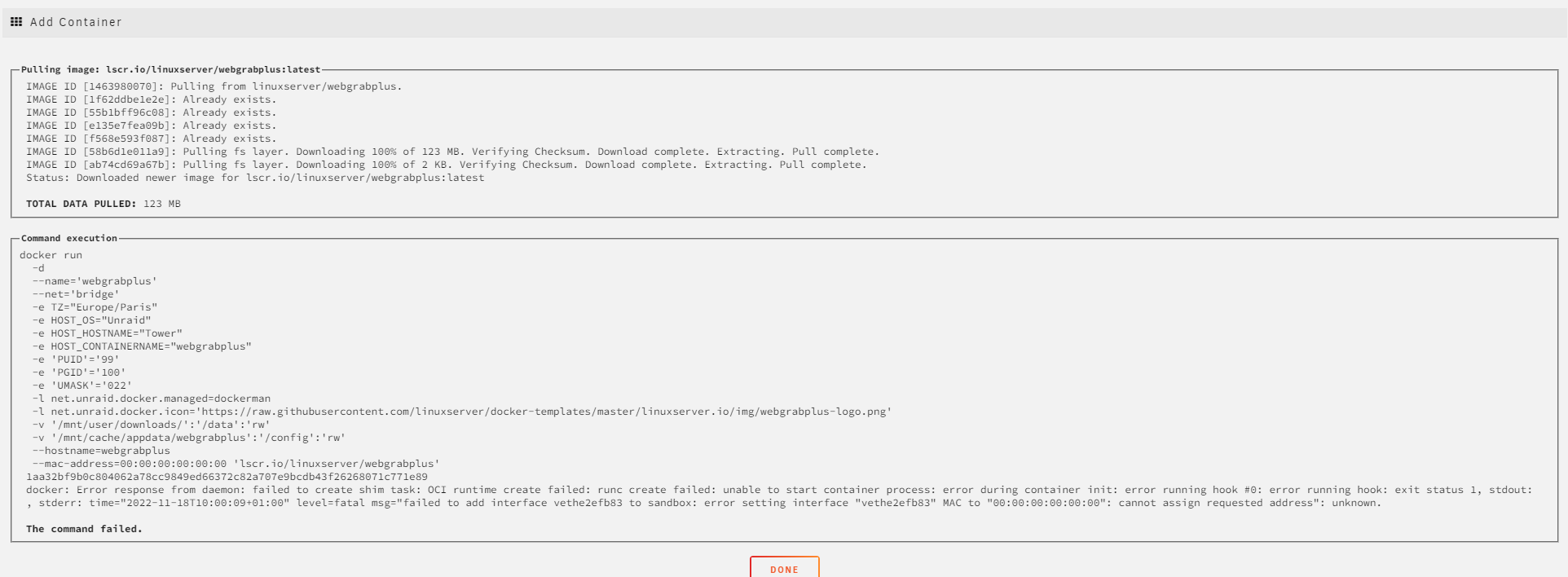

  11. Hi, I try to install the Webgrabplus docker, but it fails on install. Does anyone know what I do wrong? EDIT: If i delete "Extra Parameters" option "--mac-address=00:00:00:00:00:00" it will install, but then NO network is available. Any ideas on how I can fix this, or any parameters I need set?
