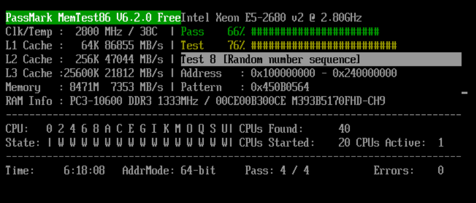

  • Ran Memtest86+ against the 8GB in there, no errors.

I don't think you mentioned actually doing memtest. You did talk about swapping memory, but it's possible a memtest would detect something such as a bad slot.
It would have to be one of the slot 1 (A and B) of the chassis, I removed all but two DIMMs and even swapped the brand/speed/size. I'll get that run on the 8GB in there in a little bit and get back to you here shortly.

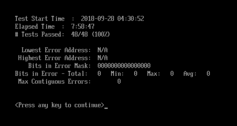

No errors after over 6hrs. Will try different USB ports when this is done.
No errors on the memtest. will try different USB ports next.
