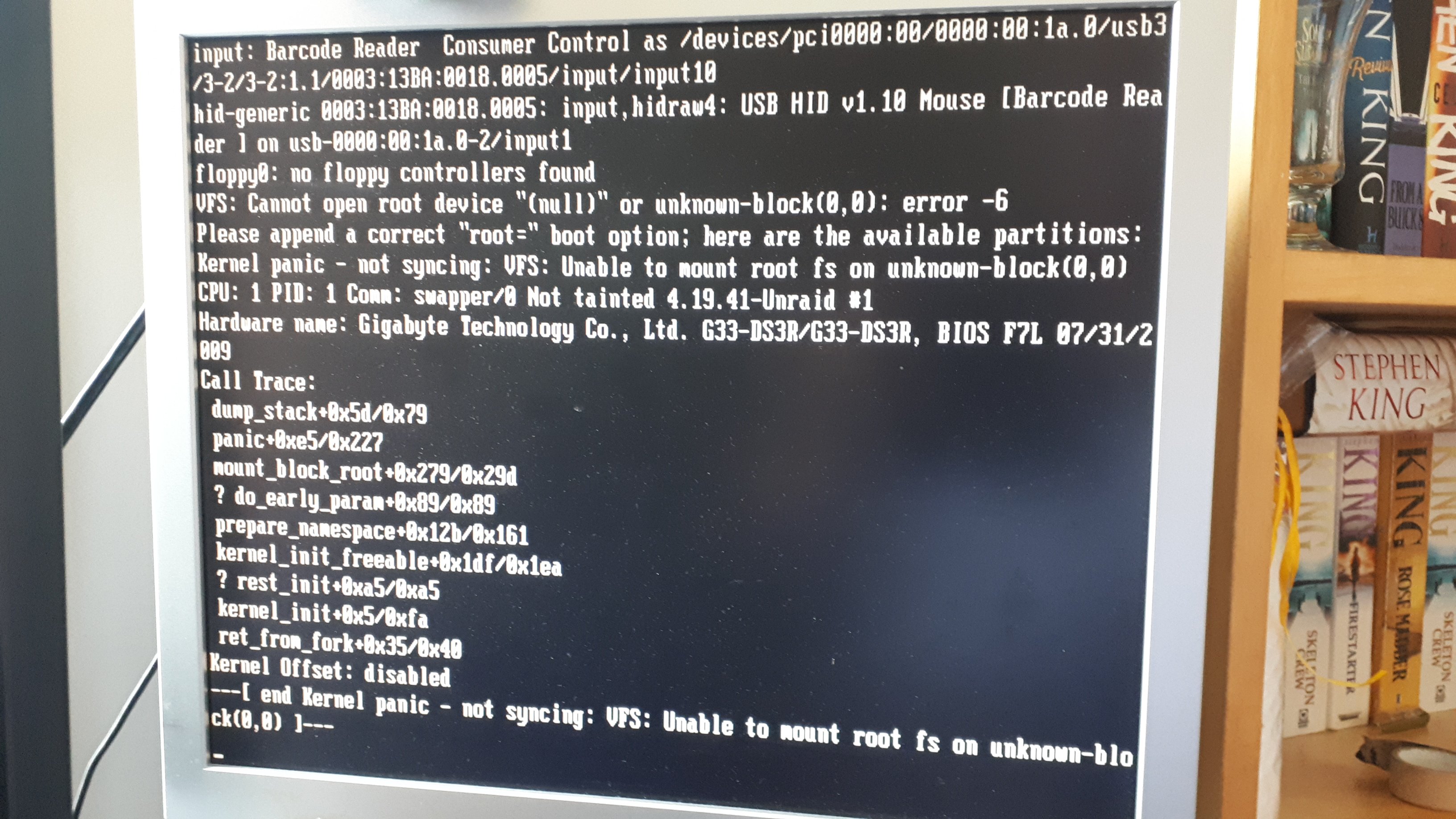

I moved the server from a room to another, and now it won't boot because of kernel panic.
I checked all the connection, and they seem in place.
Never had this before so I am unsure what to do next.
Any help appreciated. Screenshot of the screen attached

Just tried pulling each ram stick out one at a time, still getting kernel panic8b51de5ff3551ae8fc8ee1806dafc84b.jpg

This is usually a flash drive problem, try recreating it.
I created a new flash drive, and copied the content of the old key, also fails.
Using Rufus, I created a syslinux 6.04 bootable flash with it, on a 32 Gig Sandisk key making sure I ticked compatibility with old motherboards.
Then I copied the unraid files for a brand new installation from the zip install file.
This time it has done it, so it looks like some of the files on the flash that I was using are corrupted.
What do I copy across to get the server back up and running?
