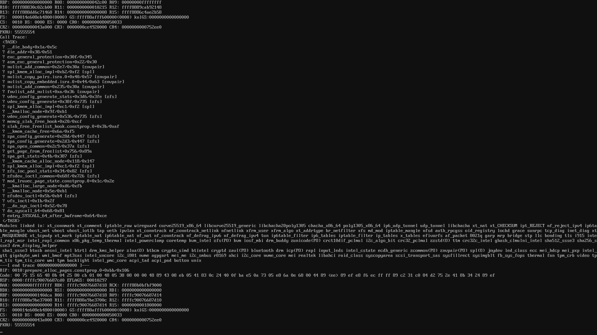

Hey all, fellow Unraider here in need of some help! I recently upgraded my server with a new CPU, RAM and HBA card. I have started to see the same
kernel: mce: [Hardware Error]: Machine check events logged
errors in my syslog. Before I go unplugging things and constantly rebooting to find the cause. Can someone please check out my diagnostics/logs and maybe narrow down the search for me? I thinking one of my new DIMMs is bad but could it be one of the CPU cores?
Additionally I'm seeing high CPU_IOWAIT in glances. I figure my HDDs are just being slow but if you have any input on that issue as well I'd appreciate it.
I have attached my unraid diagnotics as well as a snippet from the mcelog and the full mcelog.
@Squid If you could take a look too I'd very much appreciate it! 🙏
mcelog.zip aorus-diagnostics-20240409-2040.zip
Whelp, server has crashed. Can anyone make heads or tails of this output on my monitor? See attached screenshot...
