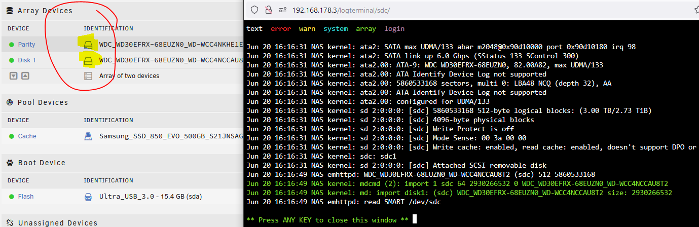

June 21, 20224 yr I want to pick up this thread. I have an ST500LT012-1DG142_S3P6J9YM (sdd) connected via internal SATA port to the system. When I click the green Icon, it will spin down (at least the icon goes grey). Pressing the device log only produces an empty window with an error logged by the log facility: Jun 21 06:20:28 NAS emhttpd: error: run_cmd, 882: No such file or directory (2): invalid cmd: /webGui/scripts/disk_log (Side note: UA should use the new device log style (inside new window) ifpossible. UA still shows an modal, Unraid opens up a new window, pointing to "logterminal/sdx"). Does UA spins down, even if the Unraid spin down setting is set to "never"? (Another side note: Would be great, if UA would support the "title=" attribute on the icon images for icon description, like the check-mark or lightning icon ) Unraid: 6.10.3 UA 2022.06.19 + UAP 2022.05.17 Edited June 21, 20224 yr by KluthR
June 22, 20224 yr 21 hours ago, KluthR said: Pressing the device log only produces an empty window with an error logged by the log facility: Which icon are you clicking on? That error doesn't make any sense to me. 21 hours ago, KluthR said: (Side note: UA should use the new device log style (inside new window) ifpossible. UA still shows an modal, Unraid opens up a new window, pointing to "logterminal/sdx"). Are you talking about the short log in the black screen? The UD device log is more like the syslog display, and not the short log. 21 hours ago, KluthR said: Does UA spins down, even if the Unraid spin down setting is set to "never"? UD devices are supposed to follow the same rules as the Array disks. 21 hours ago, KluthR said: (Another side note: Would be great, if UA would support the "title=" attribute on the icon images for icon description, like the check-mark or lightning icon It does. If the icons are active, the tool tip will show when you hover your mouse over the icon.
June 22, 20224 yr 1 hour ago, dlandon said: Which icon are you clicking on? this one (fa-hdd icon). And then it shows me: and the Unraid MAIN log: 1 hour ago, dlandon said: Are you talking about the short log in the black screen? Maybe? Iam talking between the difference of your fa-hdd icon opened modal and the one Unraid uses above the UA section under "Main": 2 hours ago, dlandon said: UD devices are supposed to follow the same rules as the Array disks. Oh, then it will never spin down. I thought one could adapt this setting per UA device maybe? 2 hours ago, dlandon said: It does. If the icons are active Ah - IF active! Thats the difference! Would be great if a title= would be there even if they're not (to explain what it usually does). (Side note: If one is inserting images with CTRL+V inside the forum text input, it is always inserted two times. Weird :/)
June 22, 20224 yr 8 hours ago, KluthR said: Maybe? Iam talking between the difference of your fa-hdd icon opened modal and the one Unraid uses above the UA section under "Main": Fixed in the next release. 8 hours ago, KluthR said: Oh, then it will never spin down. I thought one could adapt this setting per UA device maybe? If the Unraid settings are spin down on a timer, that will apply to UD devices as well. You cannot set spin down per UD device.
