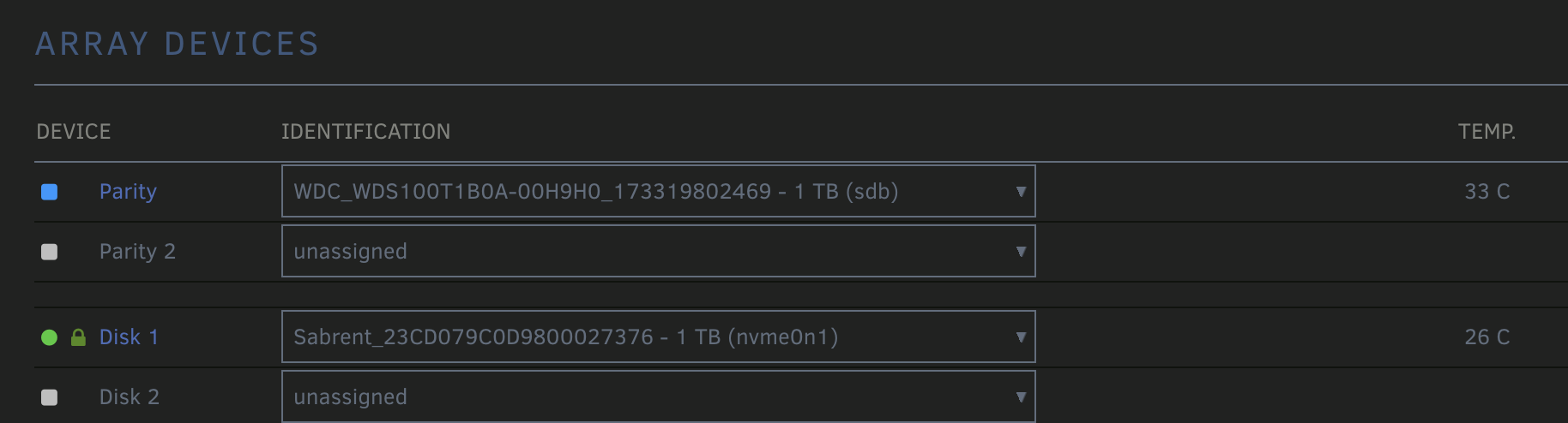

I've had an old NUC sitting around with a 1TB NVMe as a test Unraid for a while as the only Data Drive - No Parity.
I decided to add a 1TB SSD 2.5FF into the NUC as a Parity, but apparently, the new drive is apparently bigger.
Is a Parity Swap the right procedure for this?
Or do I assign the new drive as an "Unassigned Device" copy the content of the Data Drive to it with a simple "cp /*"
Then do a new config?
No, since there's no valid parity.
That works
