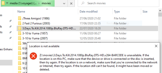

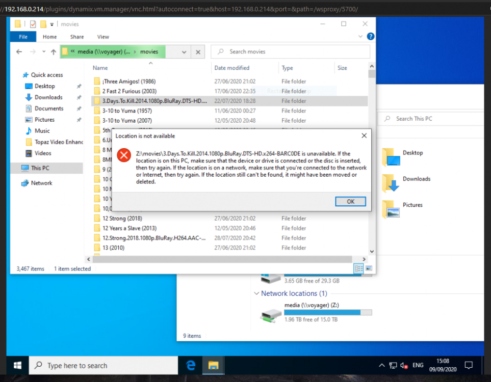

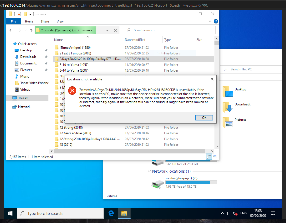

or if it does mount and i navigate to a file or folder Windows Explorer throws this error
"Location is unavailable" with the text "z\music\metallica is unavaliable.  If the location is on this PC, make sure the device or drive is connected or the disc is inserted, and then try again. If the location is on a network, make sure you're connected to the network or internet, and then try again. If the location still can't be found, it might have been moved or deleted."

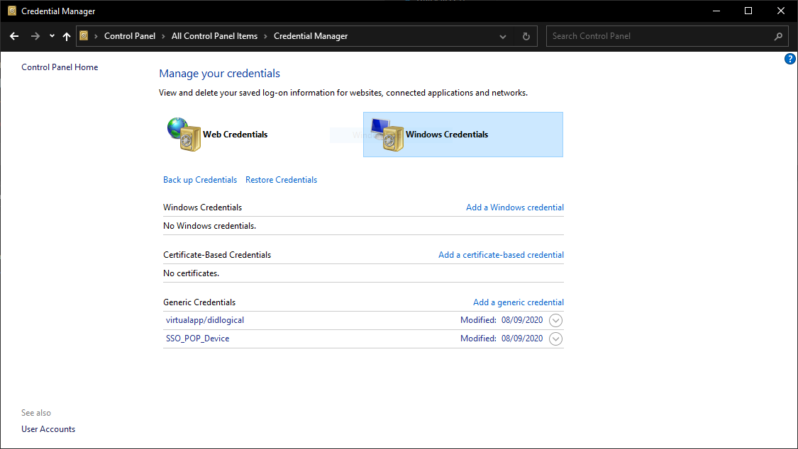

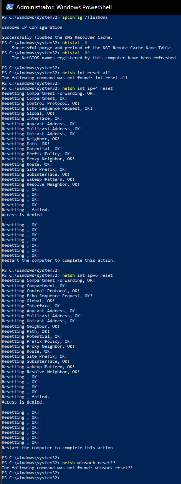

That didn't work. I've attached below screenshots of what i done following the advice from your post and from the url you attached.
I removed any old credentials from windows
Removed old mapped network shares so that there were none connected on the PC

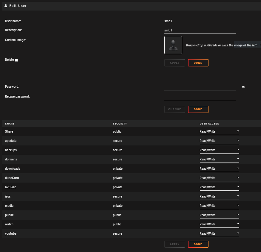

Gave the user "smb1" full read & write permissions across all shares on the server
Installed the local master plugin to make unraid the local master for smb

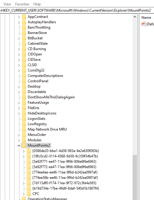

Removed any residual mounts still listed in the registry for the server
Ran net use * /delete to make sure any mappings were removed
Ran a heap of commands to flush any DNS and networks settings
Then i shutdown the VM & shutdown the server. Left the server off for 15 minutes and then turned it on. I rebooted the VM about 45 minutes afterwards the server rebooted. Then I went directly to Computer/Map Network Drive on Windows

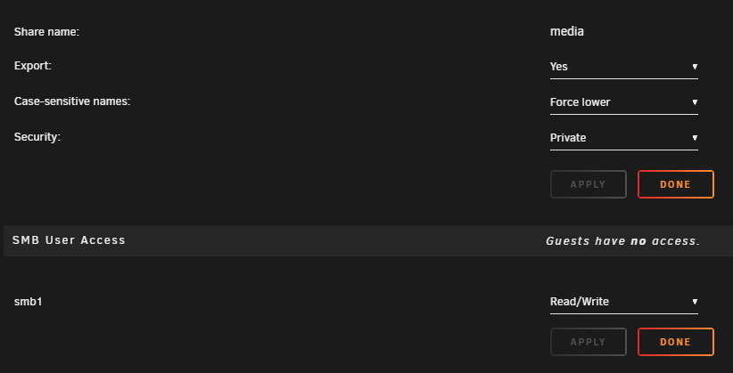

An oddity i noticed is that for the share "media" security is set to private so AFIK it shouldn't be visible on the network unless Windows is using my smb1 credentials to expose it but it is visible under "network/voyager/media" on Windows but when i try open a file or some dir's i get \\voyager\media\movies\blah blah is unavailable.

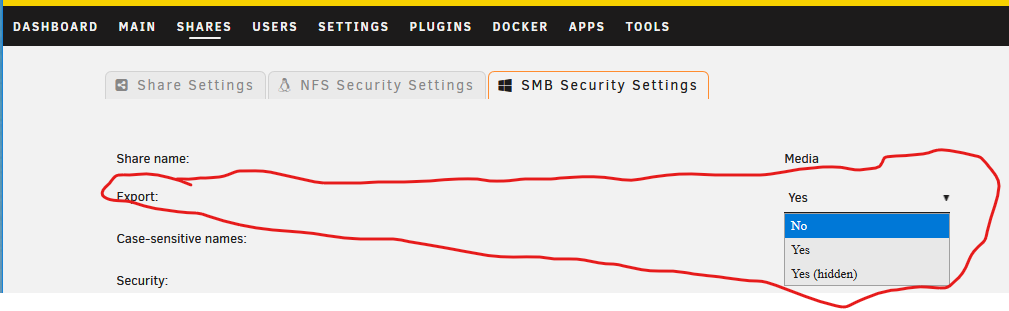

As I understand it, making a share private does not make the share itself invisible.  You will see the share name using Windows Explorer but you will not be able to access unless you are a user for that share.  If you want to hide a share from view, you have to make it 'Hidden'.
You were right about the export = yes (hidden) - I never noticed that option before so thanks for the heads up.

I've now fired up a new Win10 virtual machine and i've mounted the SMB share and im getting the exact same error on that VM. In essence this is a completely new and separate machine to the one i quoted earlier in this post and it has the exact same issue. This is why i believe its a server side error where the server is remembering an old connection.

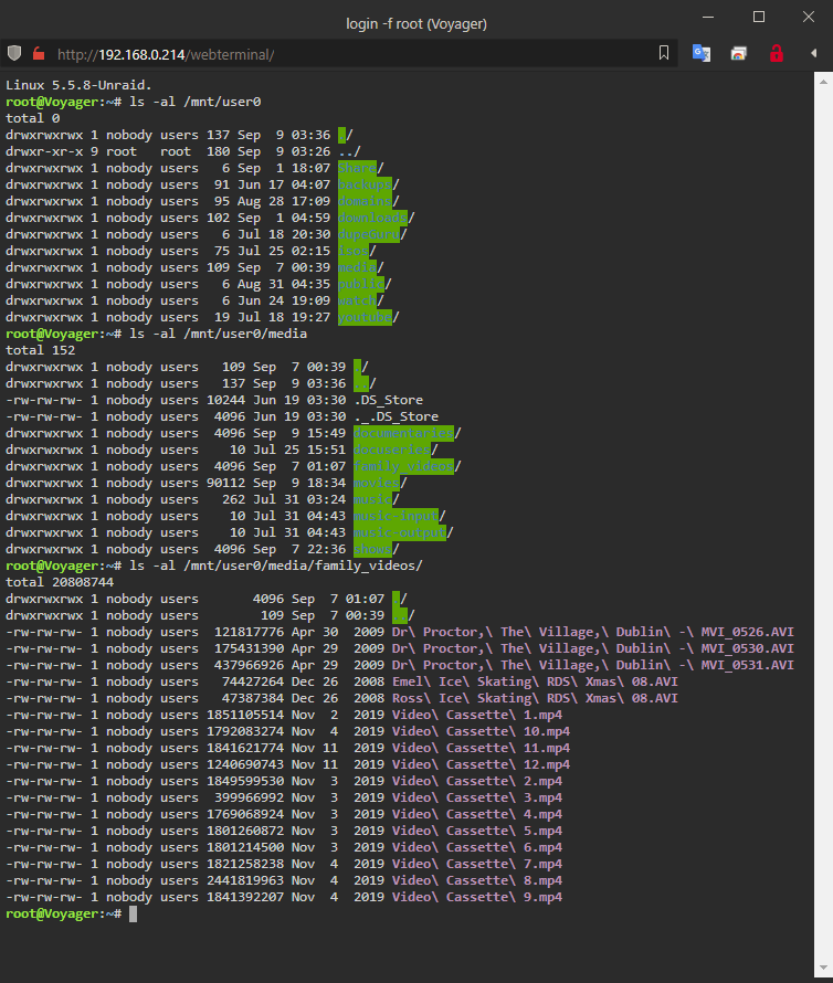

You may  need to have a look at things at the Linux level.  The reason I am saying that it appears that you are getting down inside the share and you suddenly can't go any further down the directory tree.
I would suggest you start by reading this post and I am going to ping @ken-ji  and perhaps he will have some insight.
       https://forums.unraid.net/topic/46802-faq-for-unraid-v6/page/2/?tab=comments#comment-546530
There  is a terminal program built into the GUI and you can use it run Linux command line commands very easily.   the basic command you need to look at file and directory attributes is:
ls -al /mnt/user0
Just add a slash (   /     )    and the directory name (capitalization is important in Linux!!!!) to move down the tree.  (The "arrow-keys" will allow you to move up and down the stack of commands that you have previously entered--- or backwards and forwards in the command line to do editing of an individual command to modify it.)

Ok so i've checked permissions
In the below example I have mounted the smb share with "smb1" user & pass. Win explorer won't let me into the "Avengers" folder (throws the explorer error as mentioned previously) yet when i check the permissions for the folders everyone has read/write/execute (777).
On the example below i have read/write/execute (777) on the "family_videos" share and explorer lets me into the folder yet when i try play a file (example the file called video cassette 1) it will not open. Yet if i head to my "media/movies" dir and find a video with the same permissions, one that was put onto the server months ago it will open just fine. For example i tried it in media/movies on the file -rw-rw-rw- 1 nobody users 1828481151 Dec 11  2017 the.quiet.man.1952.remastered.dvdrip.x264-regret.mkv and that opened just fine for me.

Nothing here stands out. Could you run
testparm -s
and paste the output of that? I'm wondering if you managed to have extended ACLs configured as that would cause samba to do some weird blocks if the extended ACLs got corrupted.

Hmm. You have case sensitivity turned on what I think are the affected shares; along with not preserving the case.... ie forcing them to all lowercase (the default) -  on your shares... any particular reason?
I think this might be what's giving you the unavailable error messages. all your samples that cannot be accessed anymore are mixed case. the one you said was fine is in all lowercase.

@CatMilk Not sure how the issue was fixed for you. Did you disable the case sensitive settings on the shares?
i changed "case-sensitive names" on the shares from "forced lower" to "auto" and everything started working again. I was mistaken in my previous post thinking this was related to the username/password. I read the GUI notes for this setting and it said it should only be set to "forced lower" on new shares during configuration so by me changing it to "forced lower" on an old share it must have broken the SMB protocol.
Yes, forcing it to lower means all new files are lower case now. But older mixed case named files become inaccessible over samba in weird ways. - like becoming not available as you've experienced. Glad this was all the source of your problem.
