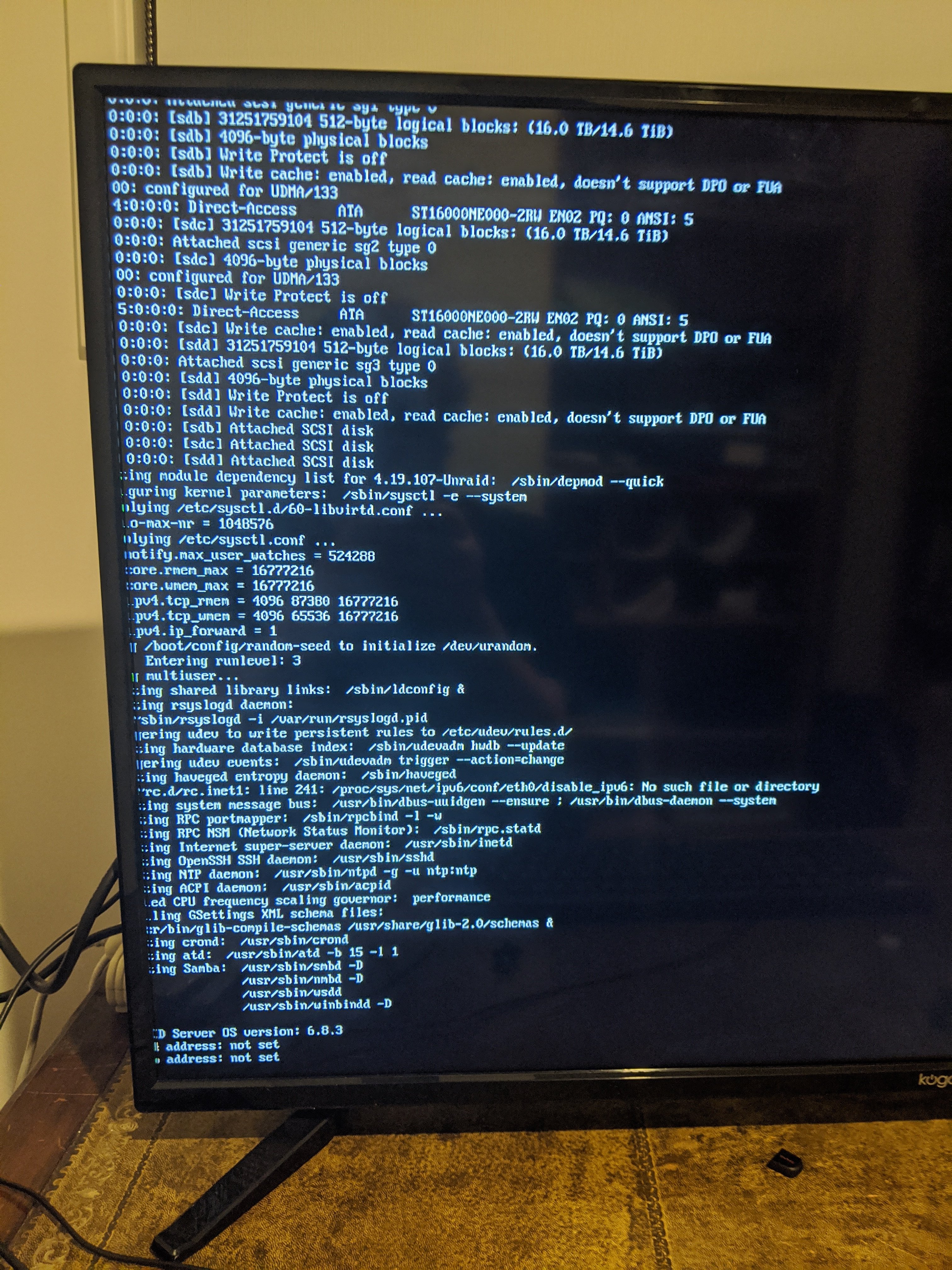

So if I boot into the GUI version (safe or not) it just goes to a blank screen. If I just choose the top option (default), the screen shot above is what I see on my temporary attached monitor.
The really strange thing is that the computer is not even showing up in connected devices in my router! As a test I booted into ubuntu Live Iso and that worked fine and connected through the lan cable and could access the internet.
Any ideas what to do from here?

Do you have an attached keyboard?
Tell us about your hardware.
I have attached a keyboard, a wireless mouse (both usb) and a monitor. The only one I had is a TV connected through the HDMI o the motherboard. The netwrok is plugged in via LAN into the motherboard.

You will probably need to use the latest beta instead of 6.8.3

I can seem to login with root/<nopassword> but I do not know what console commands work. "ls" "ip link" "lsblk" and other unix commands do not seem to work.
Unraid is a custom stripped down version of slackware linux. Those commands should work
that seems to have got it working... thanks a lot man.. I got all the way as far as downloading openmediaserver and FreeNAS : )

And the reason for this is the updated Linux kernel in the 6.9 beta with drivers and support for the latest hardware.
6.8.3 has an older version of the kernel (4.19.107) that predates the latest hardware by many, many months.
For all but the very latest generation of hardware, 6.8.3 and the older Linux kernel provided the most stable platform while development on 6.9 has focused on new features and the latest kernels.

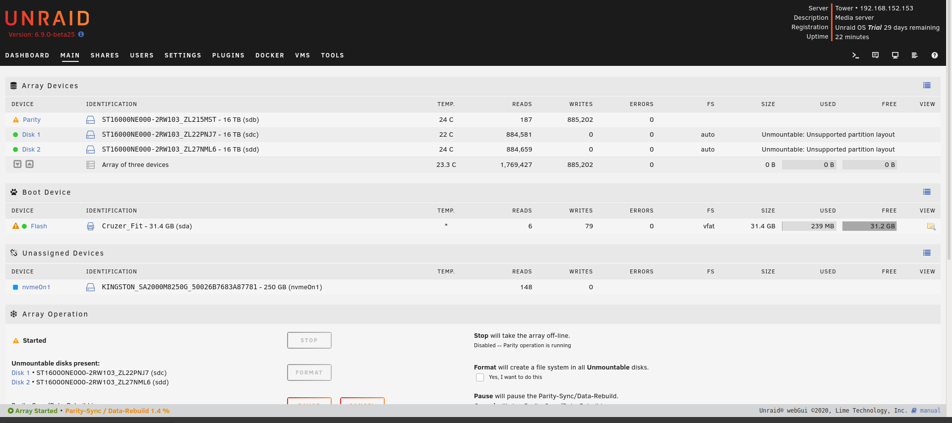

Ok I added the "parity" drive and the two data drives and started the server... I couldn't see the option at "the bottom of the page" for the cache SSD drive... but I'll deal with that latter. It has to formate everything and get it all setup I guess, everything is showing "unmountable, invalid partition layout"... I assume it is all setting it up...  the message at the bottom says 1.6%... this could take a while.... but after it is done.. I'm sure I can get everything up and running.

You can go ahead and format the data disks while it is building parity if you want.

I can not seem to see a format option... there is a greyed out button "format" further down the page of that screenshot... and clicking on either the disk icon or the "Disk #" name while it beings up a 2nd screen of info, dose not seem to have a format option?
My understanding is that I need to "stop the array" before formatting.
You have to check the "Yes, I want to do this" box to enable the button.

Also I still have a unassigned ssd, and that is not formatting?
You have to install Unassigned Devices Plus and enable destructive mode in Settings for Unassigned Devices.
